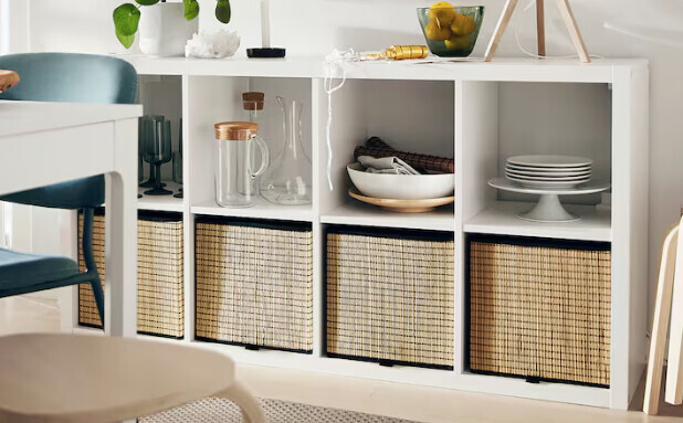

Kallax are the "cheap" open shelving units:
White shelving cubes with woven baskets placed below, glasses, plates, and decorations.

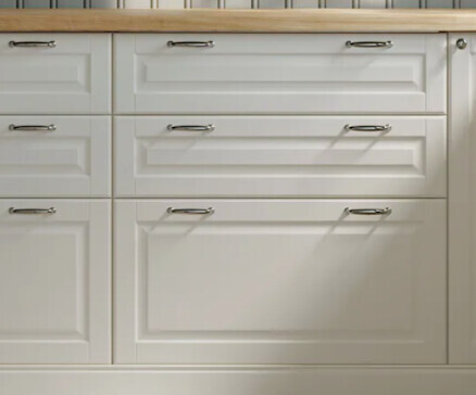

Metod are Ikea’s kitchen cabinets. With these, you can create a much higher-quality base setup with closed cabinets. So basically, you can replicate your photo exactly or choose any front/finish look you prefer.
Close-up of white kitchen drawers with metal handles and wooden edge
