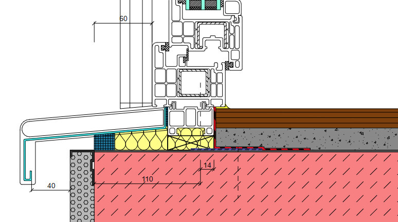

@nordanney, so you also don’t know any maximum distance between the guide rail and the window sill?No, I don’t. I also don’t have access to the current RAL guidelines. However, in the online planner from ift (which is basically the reference), the roller shutter actually sits on top of the end pieces: S

Addendum regarding the 8 mm:
