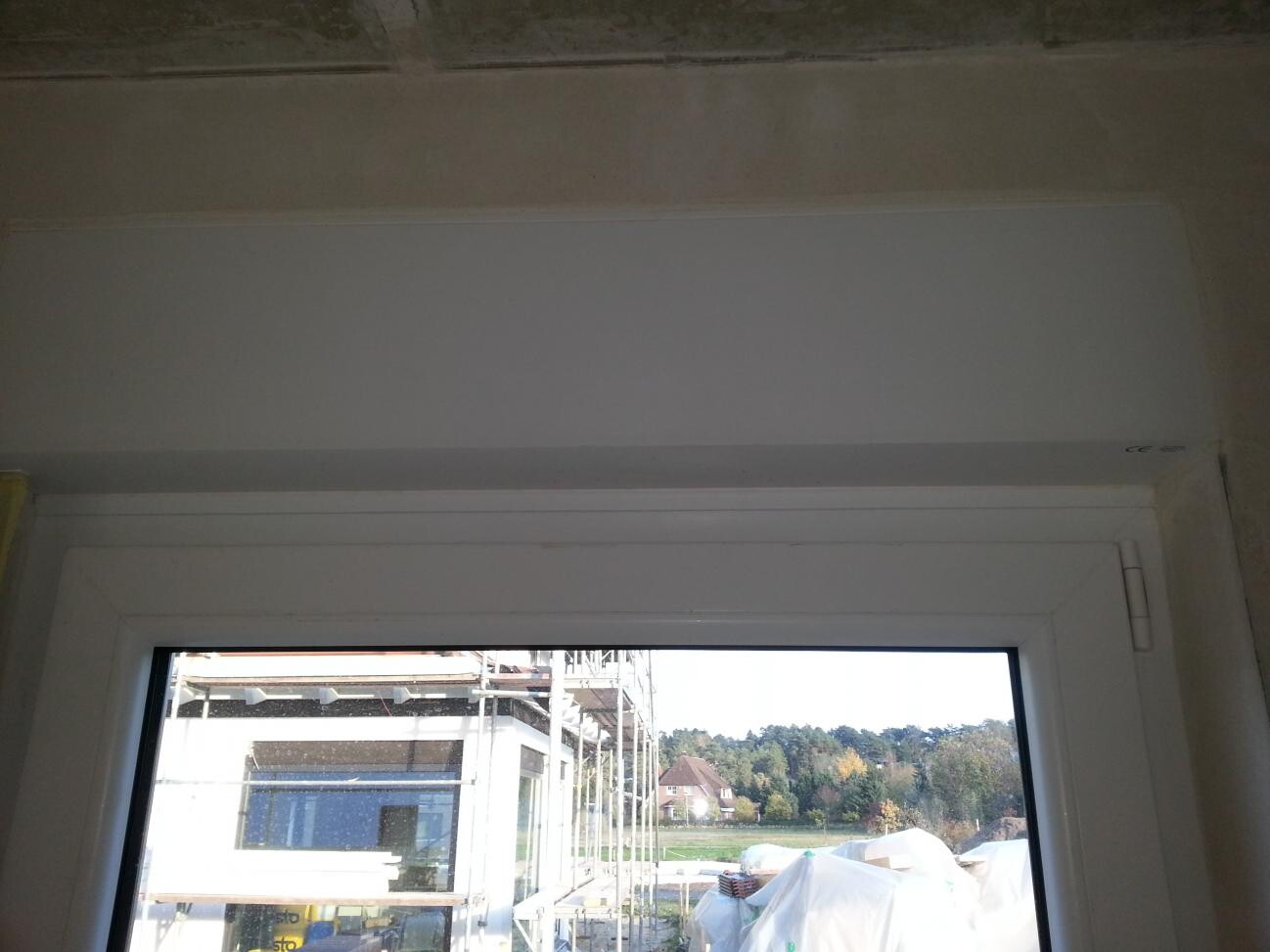

We are quite happy with the Q2 plaster on the ground floor, so we only want to paint it.
However, I am concerned about our roller shutter boxes from the inside, as they were left out by the plasterer.
Our scope of work description states: Q2, ready for wallpapering.
Does this mean that the roller shutter boxes made of plastic are not plastered?
If we had known that...

Bauexperte29 Oct 2013 13:25Hello Yvonne,
Where is the inspection opening accessed from? From the front or from underneath the window unit?
Best regards, Bauexperte

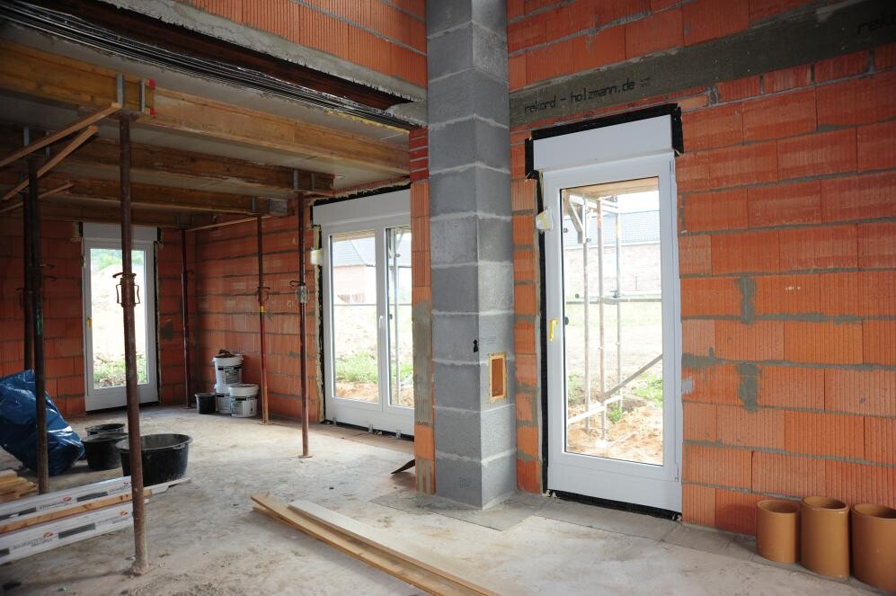

Thank you, Martina, for the example photos and your effort.
However, I’m stuck and will probably have to ask the site manager whether this is now "ready for wallpapering" and if it would look different if we had chosen Q4.
As you can see, our windows including the roller shutter boxes were installed—they came fully assembled, neat in white plastic... nice at the shell stage—but of course, the plastic doesn’t look very homely once covered with plaster.
There is nothing about this in the technical specification.
