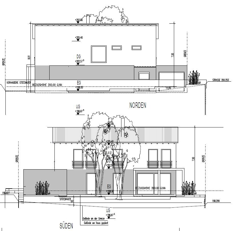

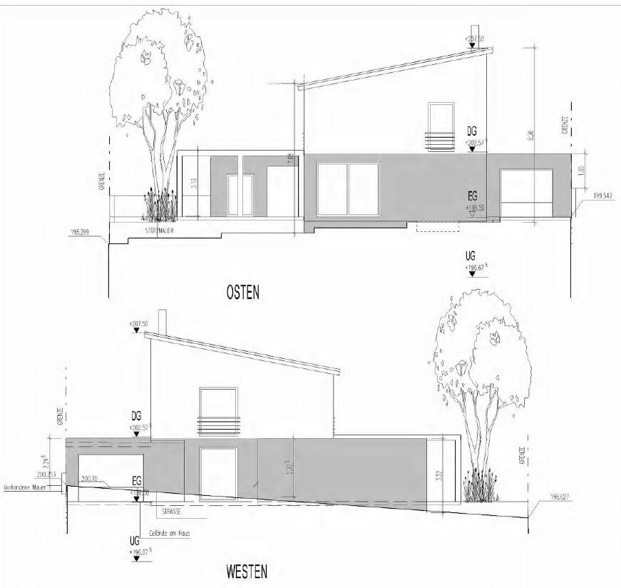

Here are the views.

Architectural drawing: two-story house with garage, windows, trees; views south/north.
East and west facade of a modern house with windows, entrance area, and trees
