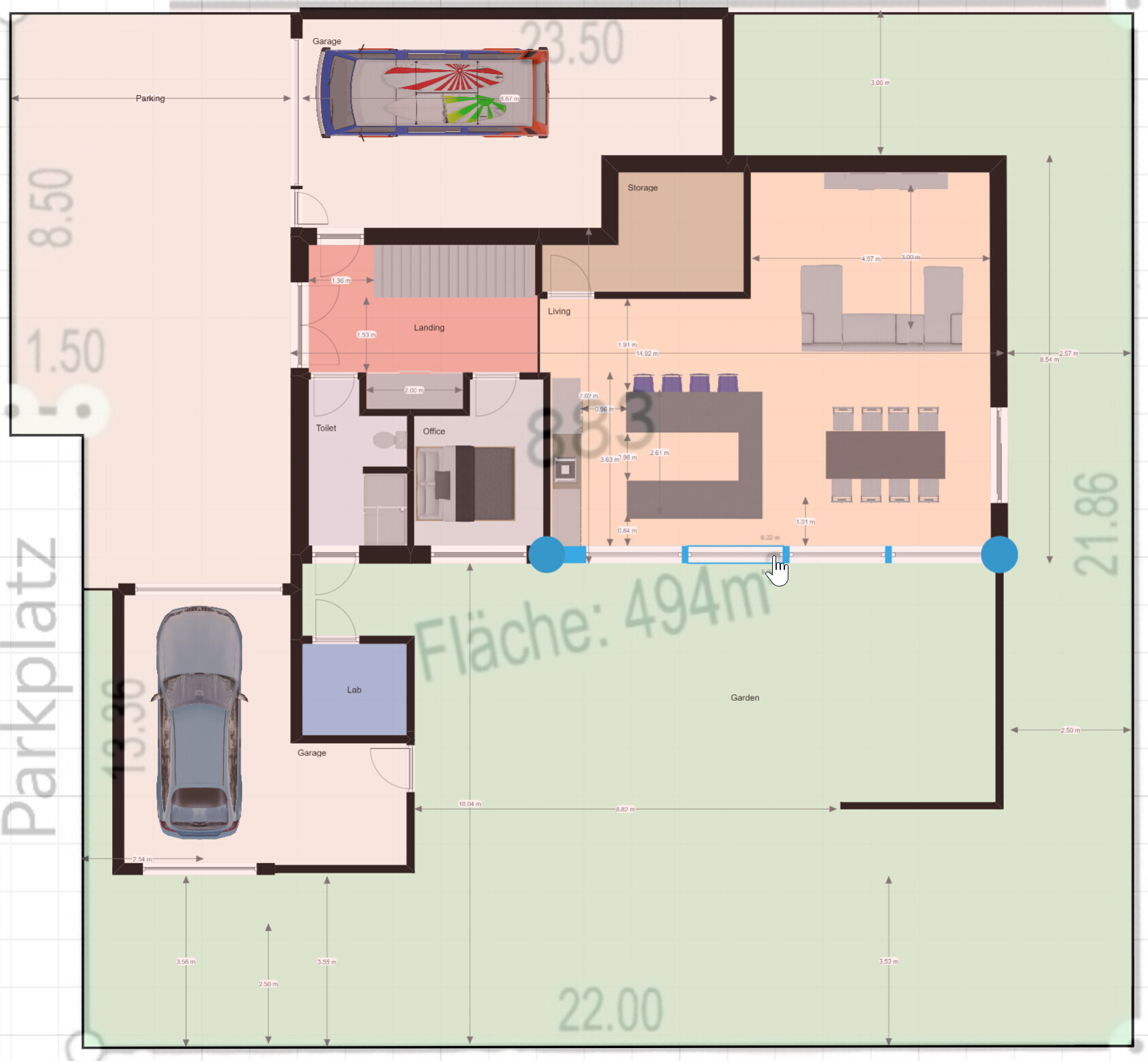

To give you a rough idea of our plans, I have attached two images.
The red numbers indicate the elevation in meters above sea level at the corners.
What do you think about the basement? We find it hard to design a floor plan where there is enough space on the ground floor for both the technical and storage rooms. But we also don’t want to “bury” unnecessary money.

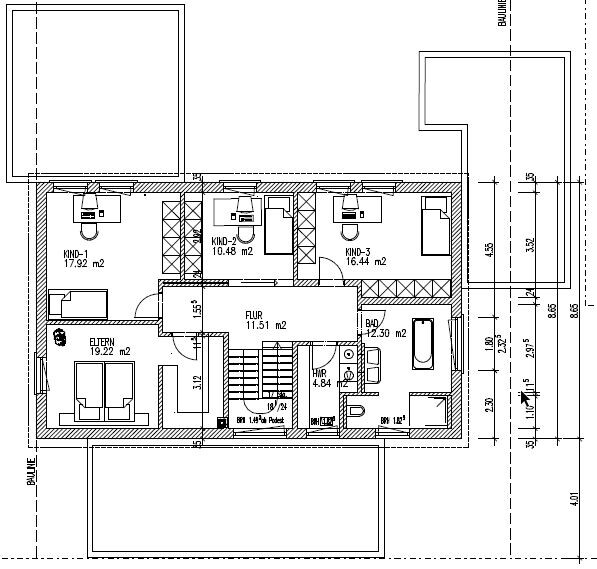

Unfortunately, we are struggling a lot with the building’s floor plan. The upper floor is almost secondary. Current floor plan
The blue area is intended to be a sauna.
What do you think about it?

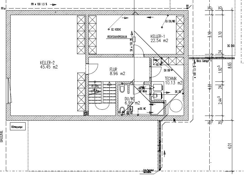

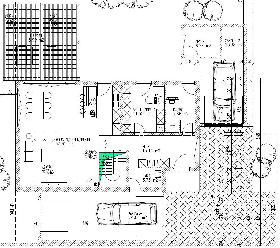

It took us a while, but now the plans are finalized and the building permit / planning permission application is about to be submitted.
We have some new questions:
We want to install underfloor heating and a controlled mechanical ventilation system with heat recovery.
In the basement, there will only be radiators.
On the roof, there will be a 10 kWp photovoltaic system.
For heating, we plan to use an air-to-air heat pump.
A heating load estimate results in about 8500 W.
The estimated hot water consumption is around 1300 kWh/year.
Now the questions are:
How did you implement your heating system?
Which model did you choose?
Would you go for a combined unit or prefer separate systems?
Are these estimated values realistic?
