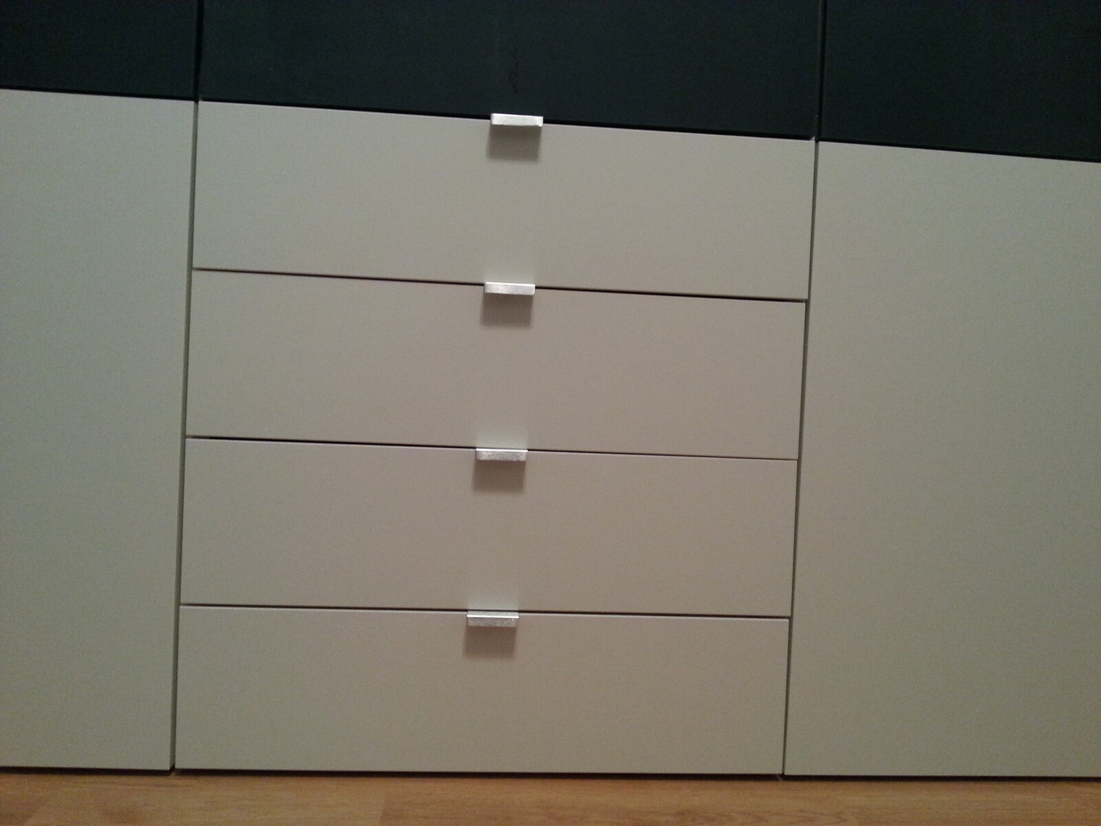

I recently bought a Besta chest of drawers, which includes four drawers. Unfortunately, the drawers cannot be fully extended because the fronts collide with each other. This is partly due to the lower edge of the upper drawer front rubbing against the handle of the lower drawer front (front panel 50mm (2 inches)). The gaps between the individual drawers also vary.
The drawers are Inreda drawers (60cm x 7cm x 40cm (24 inches x 3 inches x 16 inches)) with standard runners.
As far as I can tell, the drawers are assembled correctly and the slides should be properly installed. Do you have any ideas what might be causing this issue?
Attached is a picture:

IKEA-Experte7 Apr 2014 15:23Hello,
only the full-extension drawers can be adjusted a little.
First, check whether the handles are fully flush against the edges. If the screws are not exactly centered in the holes, tightening them can slightly tilt the handle.
Otherwise, you can only try whether anything changes by swapping the drawers in all possible combinations.
