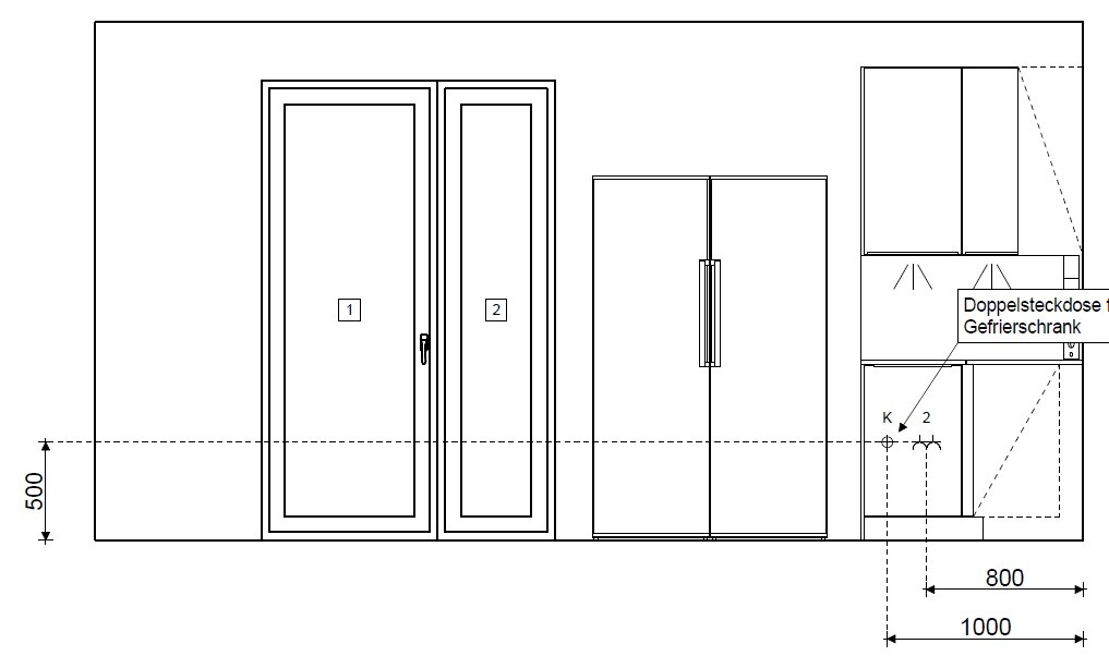

bwollowbHello,
Attached is an excerpt from my kitchen plan. From left to right: patio door, fridge/freezer, cabinet. My question to you: Are the connections for the refrigerator (power and water) usually installed behind the fridge or, as the kitchen planner recommends, behind the cabinet?
His argument: this allows the refrigerator to be placed closer to the wall.
My thought: this way, the ugly water hose and cable would be visible between the cabinet and the fridge (without knowing exactly how many centimeters (inches) this gap actually is).
Second question: How far would the refrigerator need to be pulled away from the wall if the connections were behind the fridge?
Thank you!

If this is a side-by-side refrigerator with a water connection, you should check the installation manual for the refrigerator. A water connection at the back of the unit usually requires much more space from the wall.
The unit could also be positioned closer to the base cabinets, with a distance of about 5 cm (2 inches). However, this should also be confirmed in the refrigerator’s installation manual.
kbt09 schrieb:
Water connection behind the appliance usually requires much too much clearance from the wall.Is it possible to give an approximate value?
