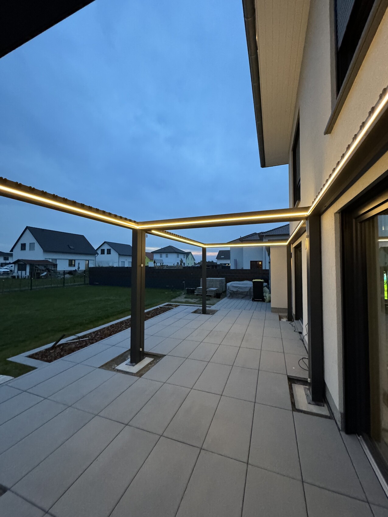

Allthewayup10 Mar 2024 17:41Nice terrace. Could you please share a close-up photo of the exit from the house to the terrace?
Coletrickle_780810 Mar 2024 18:28A
Allthewayup10 Mar 2024 21:37Thanks for the pictures. Did you install insulation (XPS) in the reveal under the panels in front of the doors? Doesn’t the rain constantly splash dirt onto the glass panes?
Coletrickle_780810 Mar 2024 21:43I had my house built…
The base was insulated before the colored stone plaster was applied. The door jambs were insulated as well, and on top of that, some kind of liquid synthetic material was used. No. Our roof overhang is 80cm (31.5 inches). The rows of tiles on the house have never really gotten wet; they generally don't get splashed either.
