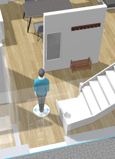

In the new self-designed version, storage space in the hallway is missing. A pantry with a depth of 95 cm (37.4 inches) does not allow for a freezer cabinet or similar to be placed along the long side—only on the short side.
In general, the location of the terrace should be planned early on and then the access routes to it should be checked.
Pfefferminz14 Apr 2023 09:04Wait, we never talked about 180 sqm (1,938 sq ft); that was clear to me from the beginning. I was also already aware of the €3000/sqm (approximately $280/sq ft) cost.

I’m not exactly sure what was ultimately communicated to the general contractor, but I just noticed that many of the points on the plan were not really mentioned in the initial requirements (e.g., garage, the reading nook upstairs, walk-in closet). Among the "must-haves," I mainly see the additional shower bathroom and the office. However, I would have said both of those could be accommodated in a significantly more compact floor plan.

Pfefferminz14 Apr 2023 09:26kbt09 schrieb:
The new self-design version lacks storage space in the hallway. A pantry with a depth of 95 cm (37 inches), for example, doesn't allow for a freezer cabinet or similar along the long side, only along the end.Yes, I naturally lack experience on how much storage space should be planned there; I have marked it as it currently is with a coat rack and shoe cabinet. In theory, the wall could be extended further toward the open-plan living area to create more space, but the back side was also intended as storage for the living room:Correctly, the pantry was planned integrated into the kitchen front, where a chest freezer should fit on the south side. And if necessary, the bathroom could still be shifted:
