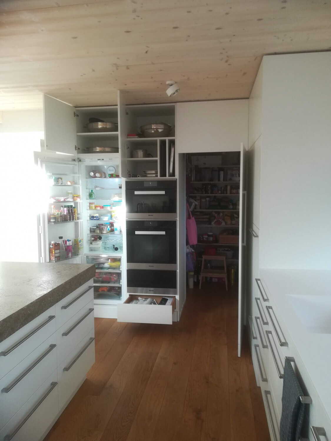

You won’t be able to fit a stand-alone freezer cabinet through the pantry door. The interior wall length is just under 130 cm (51 inches). The doorway is supposed to be 60 cm (24 inches), and it needs some clearance from the top wall. A 60 cm doorway with the frame will only leave about 56 cm (22 inches) of clear passage. If the door opening is wider, the freezer won’t fit along the bottom wall.
This awkward pantry layout definitely needs reconsideration.

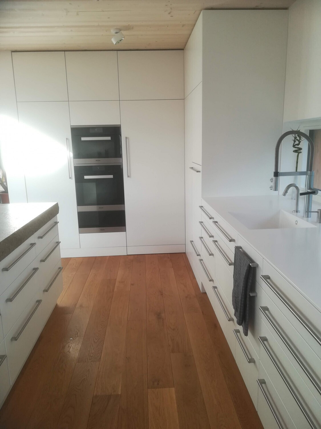

Regarding the pantry, the inspiration was from a thread here where the pantry entrance is integrated into the kitchen front. After reviewing the pictures again, I believe that the partition walls are not needed at all, and we can just use full-height tall cabinets. That was my mistake; I didn’t illustrate it properly:
Of course, the pantry could also be removed to enlarge the kitchen itself. However, I suspect it would be more cost-effective if we don’t need extra kitchen fronts or tall cabinets.
