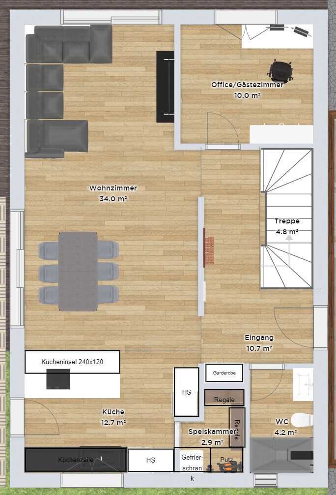

Hi everyone,

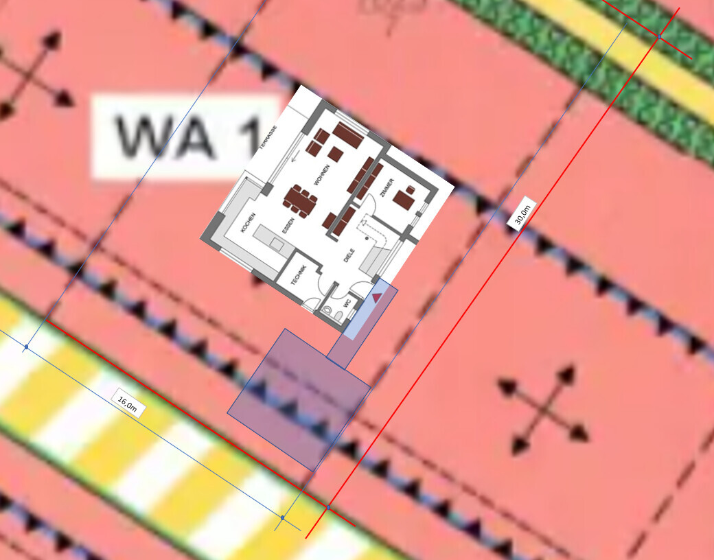

We have a plot in the new development area Jahnplatz in Lachen-Speyerdorf and have had initial talks with a general contractor (solid construction). The preliminary plan (we will only receive the official plan after signing 🙄, so I recreated it as best as I could – room sizes and rough dimensions should be correct) matches our wish list but definitely exceeds our budget. According to the general contractor, this is not a problem; we will continue to work together until we reach an agreement. The next meeting is in one month. We have requested two new plans (one with less floor area but still with a basement, one without a basement), including cost estimates. In the meantime, I wanted to ask here in the forum for obvious issues, suggestions for improvements, ideas, and further opinions.

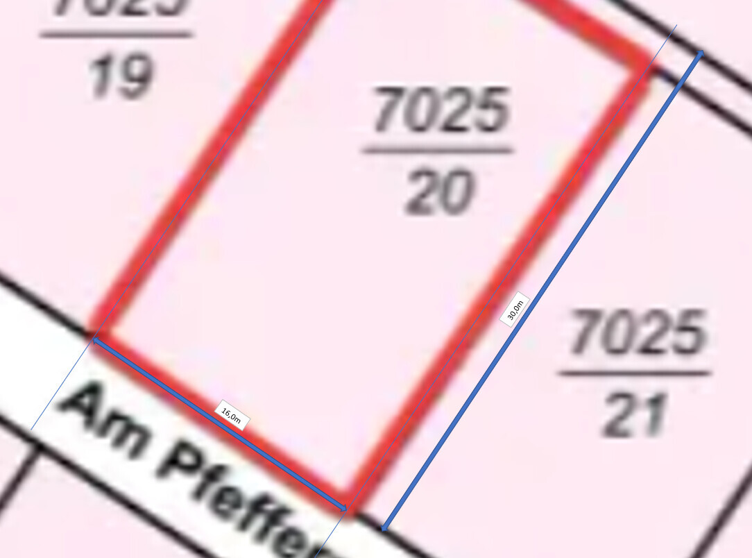

Plot size: 480 m2 (16m x 30m; 52.5ft x 98.4ft)
Slope: No
Floor area ratio: 0.4
Floor space index: -
Building line, boundary, and setback: minimum 3m (10ft) from the street, maximum 19m (62ft)
Edge development: 12m (39ft)
Number of floors: Officially 2 full floors, but the upper floor has a knee wall height of 2.30m (7.5ft) to avoid exceeding maximum building height

Who created the plan: Planner from a construction company
What do you particularly like? Why? Generally, all our nice-to-haves are covered; we would move in immediately.
What do you not like? Why? Pantry seems to be in the wrong place, cloakroom feels somewhat out of place, garage too long, bathroom and office could be smaller

- can you do without: The garage could become a carport plus tool/bike shed, reading and seating area upstairs can go, bathroom and office could be smaller. Walk-in closet is a nice-to-have and could be arranged differently. If absolutely necessary, we could probably live without the basement, but then the roof must be adapted for storage space and the heating/utility room has to be located somewhere on the ground or upper floor. The pantry as it currently is makes no sense; alternatively, we would enlarge the kitchen and use tall cabinets for storage.
- can you not do without: Shower bathroom on the ground floor, kitchen with 4m length (13ft)

Setting costs aside for a moment, is my floor plan realistic, or are there any major mistakes that would make it impractical or problematic? What have we forgotten or overlooked?
You won’t be able to fit a stand-alone freezer cabinet through the pantry door. The interior wall measures just under 130 cm (51 inches). The door opening is planned to be 60 cm (24 inches), and it also needs some clearance from the top wall. With a 60 cm (24 inches) door opening plus the frame, the actual passage will be about 56 cm (22 inches). If the door opening is made wider, the freezer won’t fit along the lower wall.
This awkwardly shaped pantry definitely needs to be reconsidered.

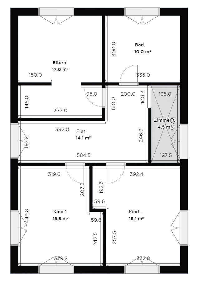

The same applies to the bedroom and dressing area, which is 145 cm (57 inches) wide... the door there won’t be very large either. Is the upper floor a full story?
What are the plans for the garage, parking space, and so on?
