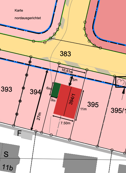

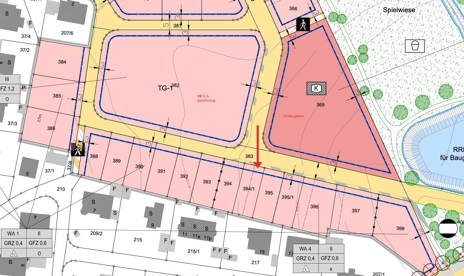

House Position:
Development Plan:

Building window, building line and boundary: Terraced house with permitted boundary construction, see development plan link.
On the upper floor (possibly on full stories?), a 3m (10 ft) distance to the neighbor’s residential building must be maintained. Therefore, in my opinion: if the 3m (10 ft) distance is observed on the ground and upper floors by the two garages west/east as follows: own garage (west) → own house → neighbor’s garage (east), then 7.50m (24.6 ft) width can be used for the house.

Stormwater infiltration is 100% routed into the sewer system, no windows allowed on the east side (terraced house, quiet/view area) – except skylight over stairs and bathroom window. However, this is restricted by the garage, so these would mainly be used on the upper floor.
Opposite on the north side, a kindergarten and a three-story multi-family building with underground parking (TG-1) are planned – see surrounding image.
Neighbor to the west built higher than we plan, and the east plot is free.

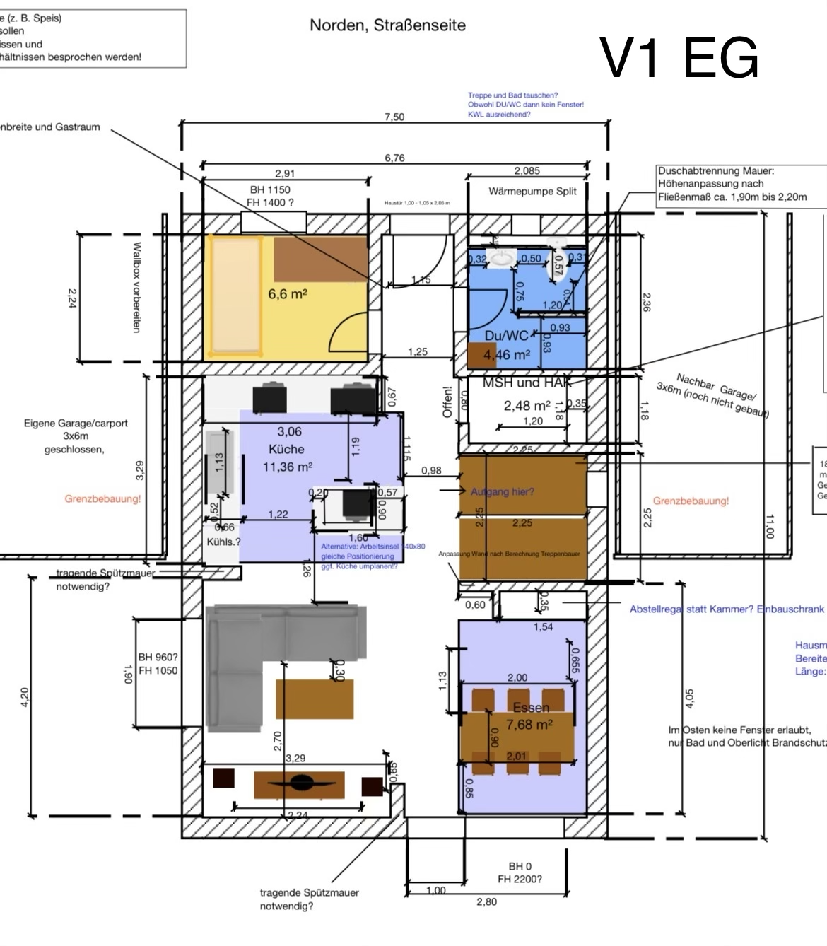

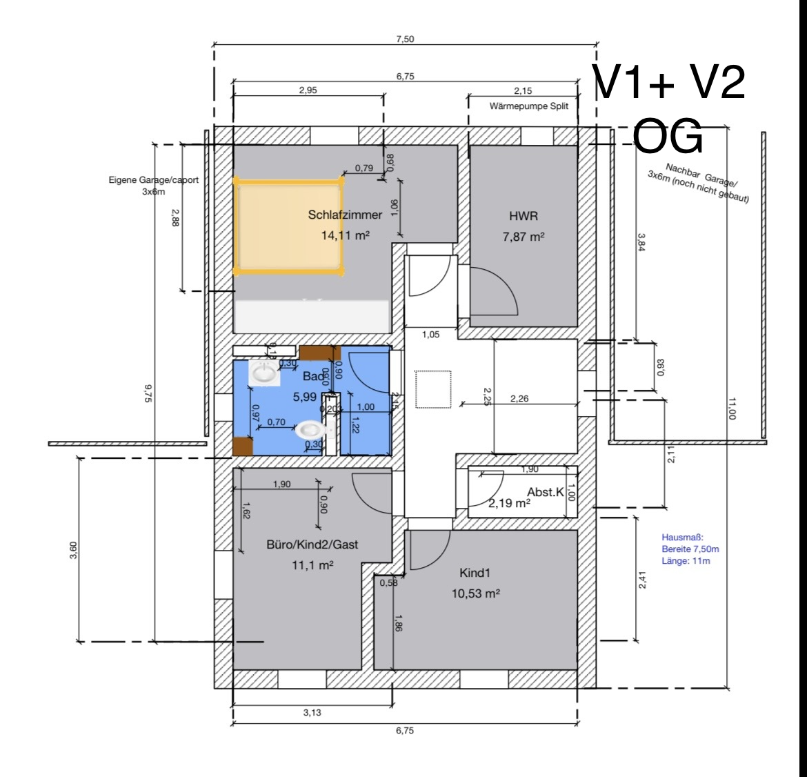

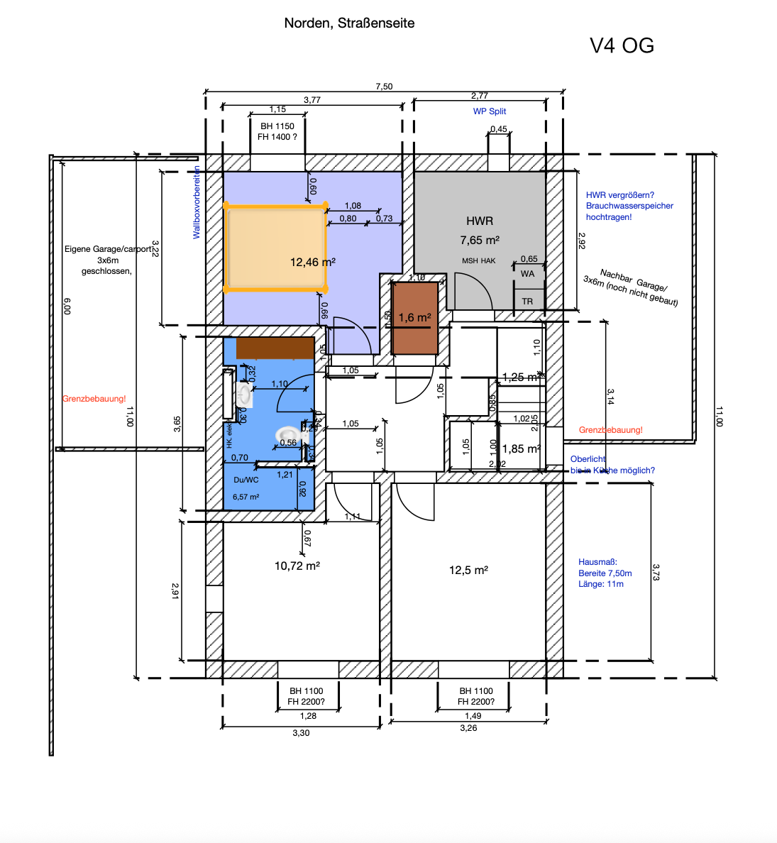

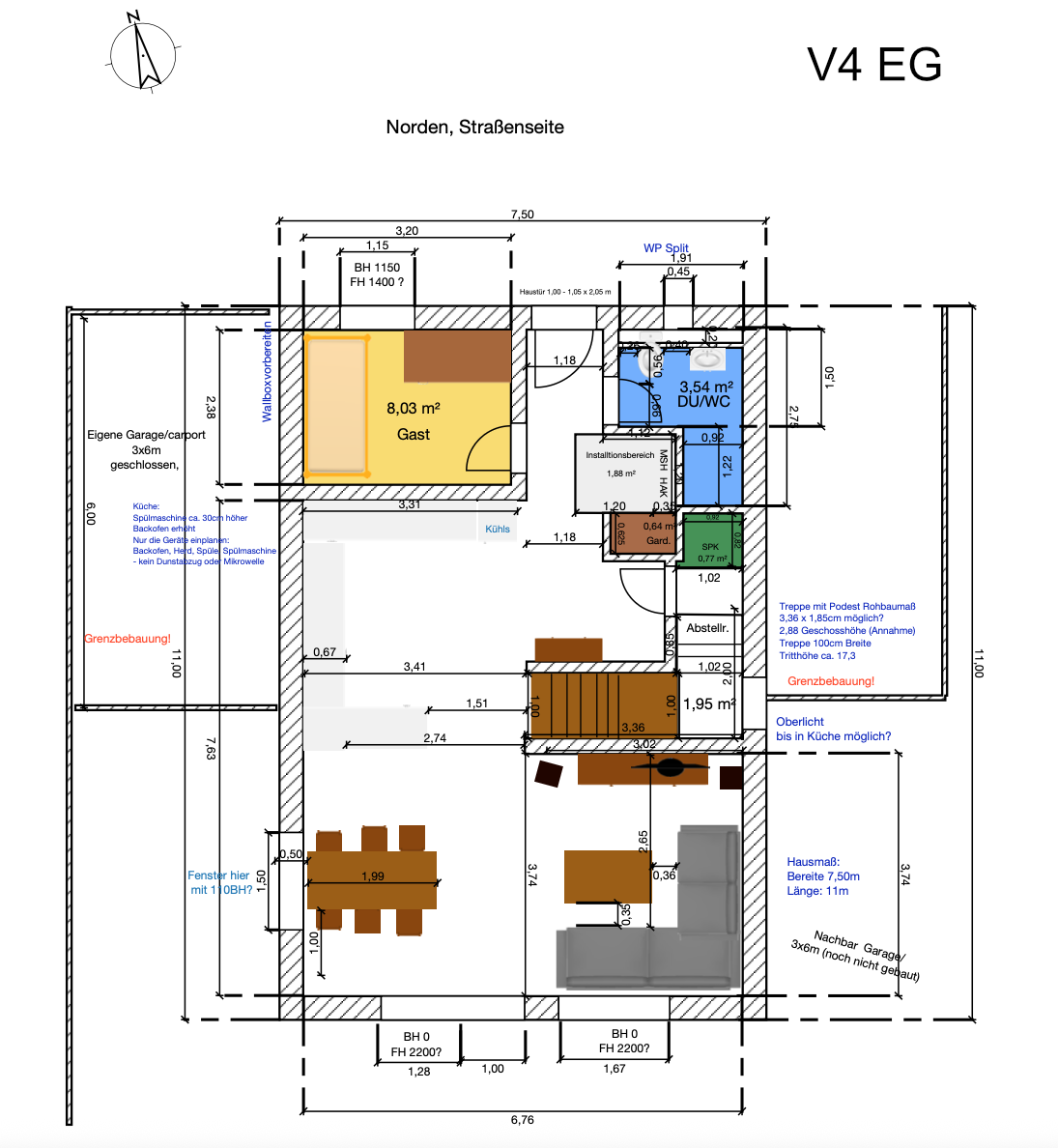

Who planned it: Do-it-Yourself, floor plans for narrow houses and semi-detached house templates, started on the ground floor like every layperson.
Versions 1 to 4 were created chronologically and would roughly reflect my preference order. Therefore, I discuss favorite V4 first, as this should receive the critiques.
V4: Small wardrobe and pantry now exist, small but nicely integrated under the stairs, enabling space for the hi-fi wall due to the length of the required wall. This offers a similarly nice layout as in V1 (open), but with more light and more space for feature walls/furniture. Could the skylight in the hallway help with kitchen lighting?

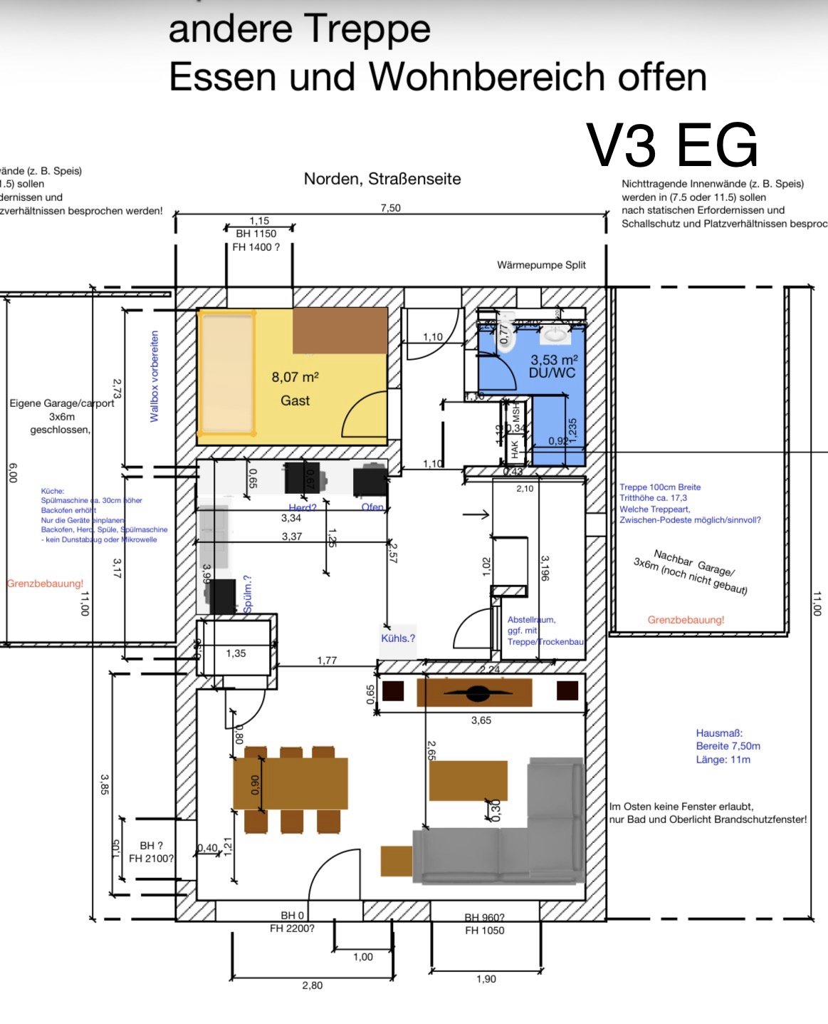

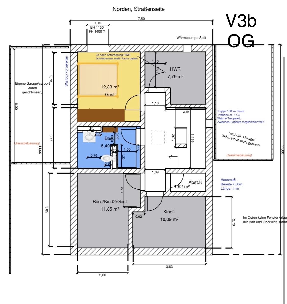

V3: The 180-degree angled staircase saves space. It lacks a wardrobe and pantry – just an experiment. V4 handled that better.

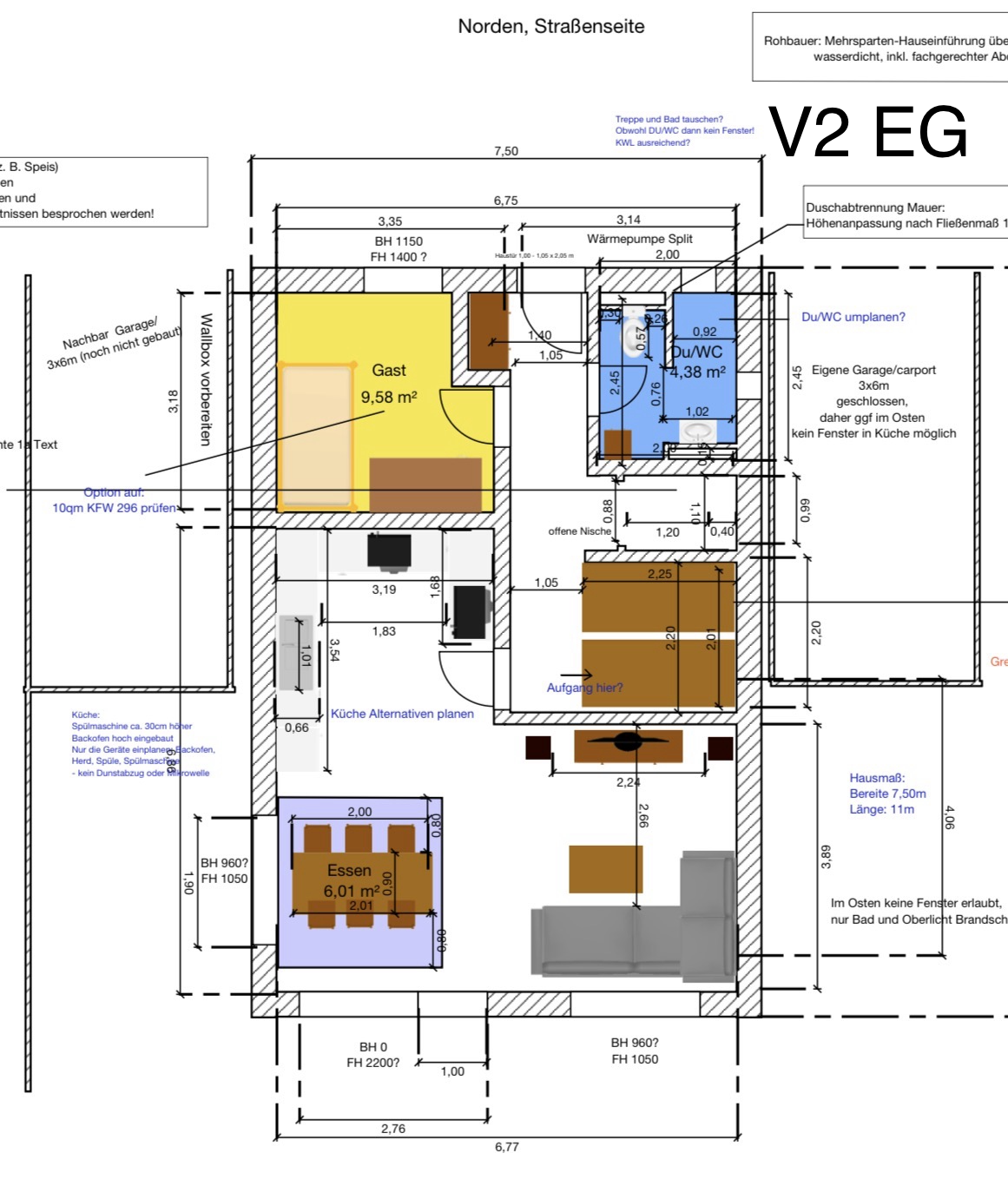

V2: Classic semi-detached house layout. System staircase with half-turn. Too cramped and dark for us. We gain space and light with the open living area. Looks tidy on paper but was rejected internally.
V1: System staircase with half-turn. Here, the short hall and transition to a large open kitchen appeal. Light and communication in the open living area must mainly come from the south. Affordable system staircase in beech. Pantry is missing. Less light than V2–V4 since one window wall serves as hi-fi wall. Therefore, we dared a restart with V3.
A quarter-turn staircase with landing would also work but, in my opinion, takes up too much space. Which staircase would you choose?
Still unclear whether to take V4 to the architect or go directly with the general contractor. Should they see the floor plans or start fresh on a greenfield site?

A. Location on the plot: see screenshot; would you consider 5m (16.4 ft) space from the curb sufficient for a car parking in front of the house? Would it be allowed later to extend the carport roof and create a 1m (3.3 ft) covered porch to the front door? Or better not since the windows would get less light?

Floor plans:
V4 Ground floor:
Please focus criticisms on V4
V4 Upper floor:
V3 Ground floor:
V3 Upper floor:
V2 Ground floor:

V1 + V2 Upper floor:

V4 Ground floor:
V4 Upper floor:
V3 Ground floor:
V3 Upper floor:
V2 Ground floor:

MachsSelbst19 Jan 2026 22:34The problem starts with trying to include a guest room of 9m² (100 sq ft) in such a cramped house meant for two people, for just about 2 weeks of overnight guests per year, and moving the utility room upstairs to make space for it. That room will cost you around 25,000 EUR (assuming 2,500 EUR/m²) plus interest. You could spend many nights in a hotel instead, or simply buy a comfortable pull-out sofa for the living room for your guests. My mother, who is in her mid-70s, sleeps on our sofa about 20-25 days a year.
If you skip the guest room, you can keep the utility room on the ground floor where it belongs and enlarge the really tiny children’s rooms upstairs. Honestly, 10.5m² (113 sq ft) for a child’s room, where a child will live up to their 18th birthday and often several years beyond that, is barely enough space. You can hardly fit a 1.40m (55 inch) bed, and if you do, there’s barely room to turn around next to the wardrobe, shelves, and desk.
Given the size of the house, you should also avoid features like a pantry, storage room, or similar. Food should be stored in one or two tall kitchen cabinets with pull-out drawers. The utility room can be cleverly equipped with shelves or you can place one or two cabinets in the hallway for extra storage. Separate rooms take up disproportionate space due to extra walls and doors that need to open somewhere. Your 1.92m² (20.7 sq ft) storage room in the V3b OG design is too narrow to even fit a long shelf—it’s only about 80-85cm (31-33 inches) wide, which matches the 735mm (29 inch) door you’ve planned there.
I would also skip the shower on the ground floor. It’s not often that everyone needs to shower at the same time, and you simply don’t have space for it.
Focus on the children’s rooms, the kitchen, and the living room. That’s where 95% of life happens. Of course, sometimes in the bedroom too, but basically, you just need the bed in there.

VillaPete20 Jan 2026 06:46Thanks for the initial feedback.
But the main reason for at least 7.5sqm (80.7 sq ft) for a guest room on the ground floor is that the room is needed year-round for health reasons – hence the shower as well. I didn’t want to go into detail – it’s a strict requirement and the room will also be used for guests. It should definitely be around 7.5sqm (80.7 sq ft).
I’m still struggling with the rest of the criticism and wondering why?
Maybe it’s because I didn’t grow up in a house but in apartments. 7sqm (75.3 sq ft) rooms per child were quite a lot.
Today, rooms of 11-12.5sqm (118-134.5 sq ft) for children sound good! Back then, 6sqm (64.6 sq ft) was still better than one room for both! And yes, it was small. But it was my own space and retreat as a child.
And now about the storage room: in the apartment, we have 80x110cm (31.5x43.3 inches) with a 61cm (24 inches) door. It’s really tight, but besides food supplies, tools, spare parts, toilet paper, cleaning buckets, and so on, surprisingly much fits in. If you don’t have a basement, you need this. Given the choice, giving each child 1sqm (10.8 sq ft) less is better than the family losing a 2sqm (21.5 sq ft) storage room. If necessary, and as a compromise, a household closet in the upper-floor hallway. On the ground floor, give up the pantry and only have a storage room under the stairs.
I don’t like the upper floor of V4 at all. Too many corners, difficult to furnish.
I prefer V3 on both the ground floor and the upper floor. I would also remove that small pantry.
Could a technical solution be an option so that the small bedroom can be eliminated? For example, a stairlift.
The ground floor would benefit a lot if that whole area was removed.
Where should the building services go?
derdietmar20 Jan 2026 15:03Hello,
the development plan specifies a depth of 10 m (33 feet) for the main building. You have planned 11 m (36 feet). I interpret this requirement as a fixed dimension, not a minimum measurement.
