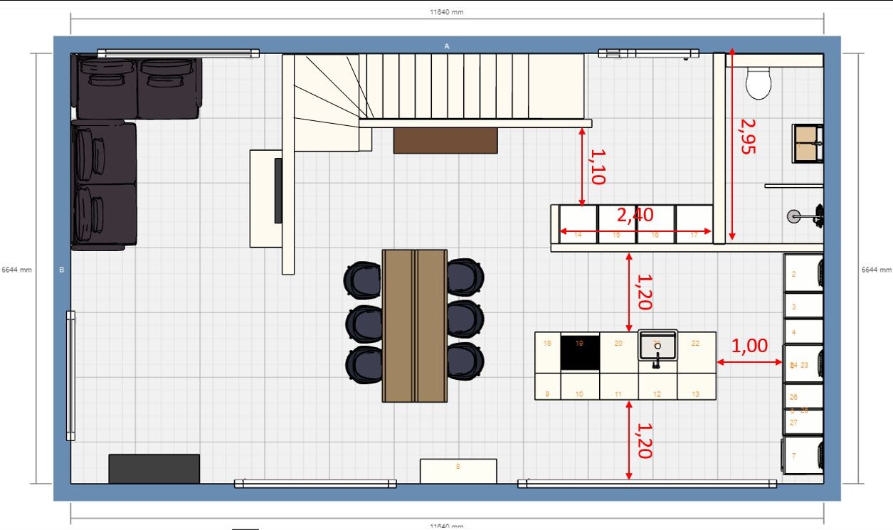

One more question about the staircase: is it possible to have a straight basement stairway at the top under a staircase that turns twice by a quarter turn each going upwards, with the winding only at the bottom? So that the basement stairway is located where the staircase currently goes up next to the front door?
_Yv_St_ schrieb:
Can I design a basement staircase with a straight upper section and two quarter turns, and only have the turn at the bottom? This would mean that the two staircases, one above the other, would be identical at the "foot end" (both turning) and in the middle section (both straight), with about four steps at the "head end" for which you would need to check the headroom. Try tracing one of the staircases onto tracing paper and overlay them. Assign the top step a value of "0" and then count downwards; for example, with 18 cm (7 inches) step height, label them as -18, -36, -54, -72. If the straight penultimate step (-18) is positioned so that the step four down (-54) overlaps it, then at this point you have lost 36 cm (14 inches) of headroom compared to a parallel layout, according to this simplified calculation. @kbt09 might be able to explain this in more detail.

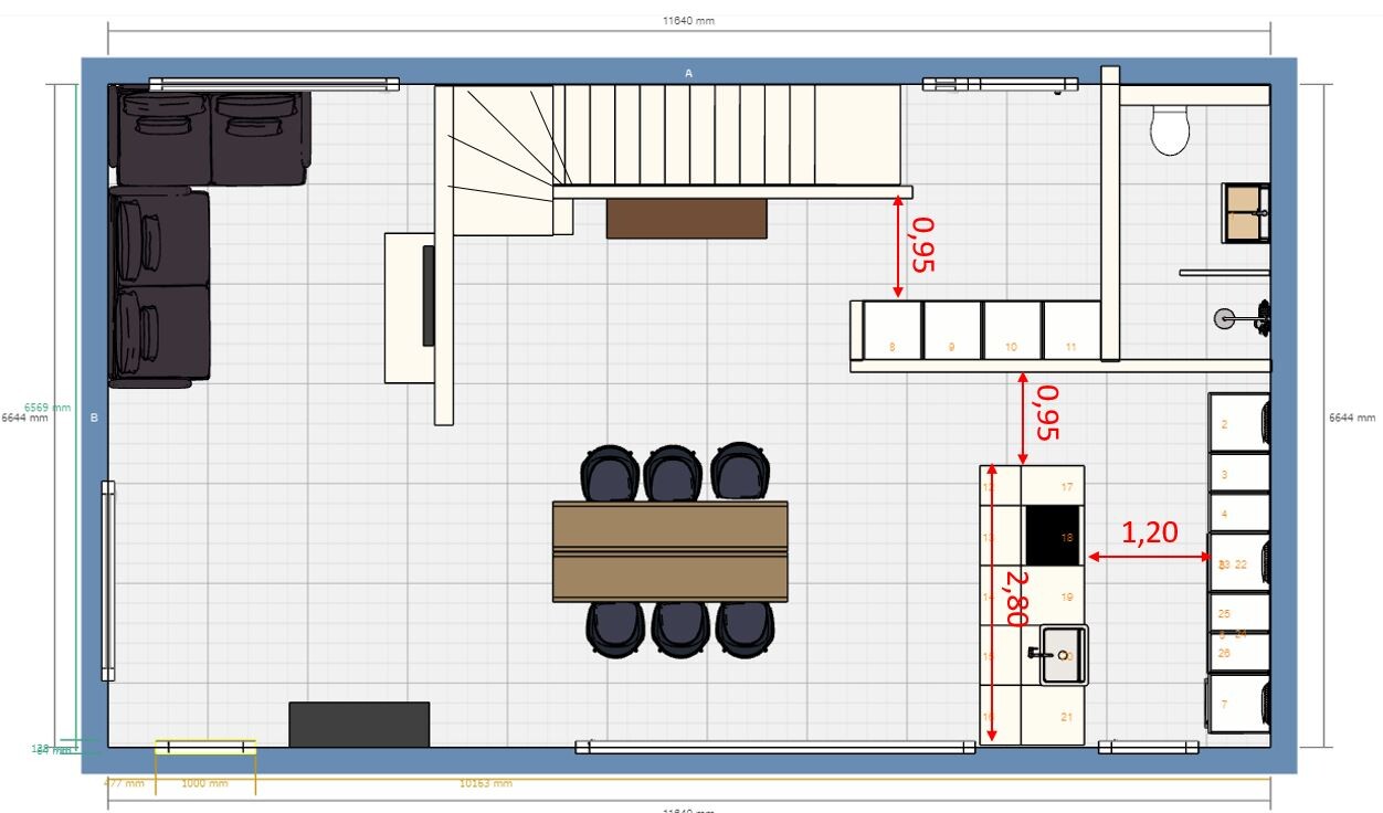

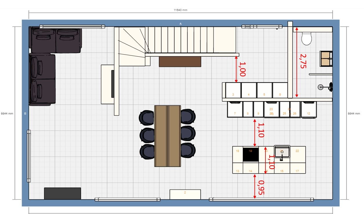

a brief update:
We are currently getting used to the idea of a staircase with two quarter turns (a straight flight down to the basement in the entrance area, a quarter turn up at the dining area, and another quarter turn at the top going out) – although we still feel a bit sorry for changing the straight staircase. We haven’t received updated plans or the exact headroom measurements at the basement stairs yet, but it seems possible.
We have also realized that we need to start planning the kitchen in more detail than we have so far. That’s why I put together the ground floor using the Ikea kitchen planner (it surprisingly allows for a lot of general planning, but for example, I couldn’t fit the basement door in, and the stairs are just placeholder, so I sketched some winding steps there). The kitchen cabinets are only placeholders at this point for mid-height, tall units, and the island. The windows are still quite open in terms of placement as well. When looking at the different options in 3D, we actually prefer the island facing the garden over the peninsula facing the dining area. What do you think of these options?
We also tried to shift the entrance area and the guest WC with shower a bit… I still have a shoe cabinet in mind… we will see when the guest WC and the door are planned in more detail. Of course, we remain open to good suggestions – this is certainly not yet the optimal layout.
Regarding the floor area, we are limited not only by the budget but also by the floor area ratio.
a brief update:
