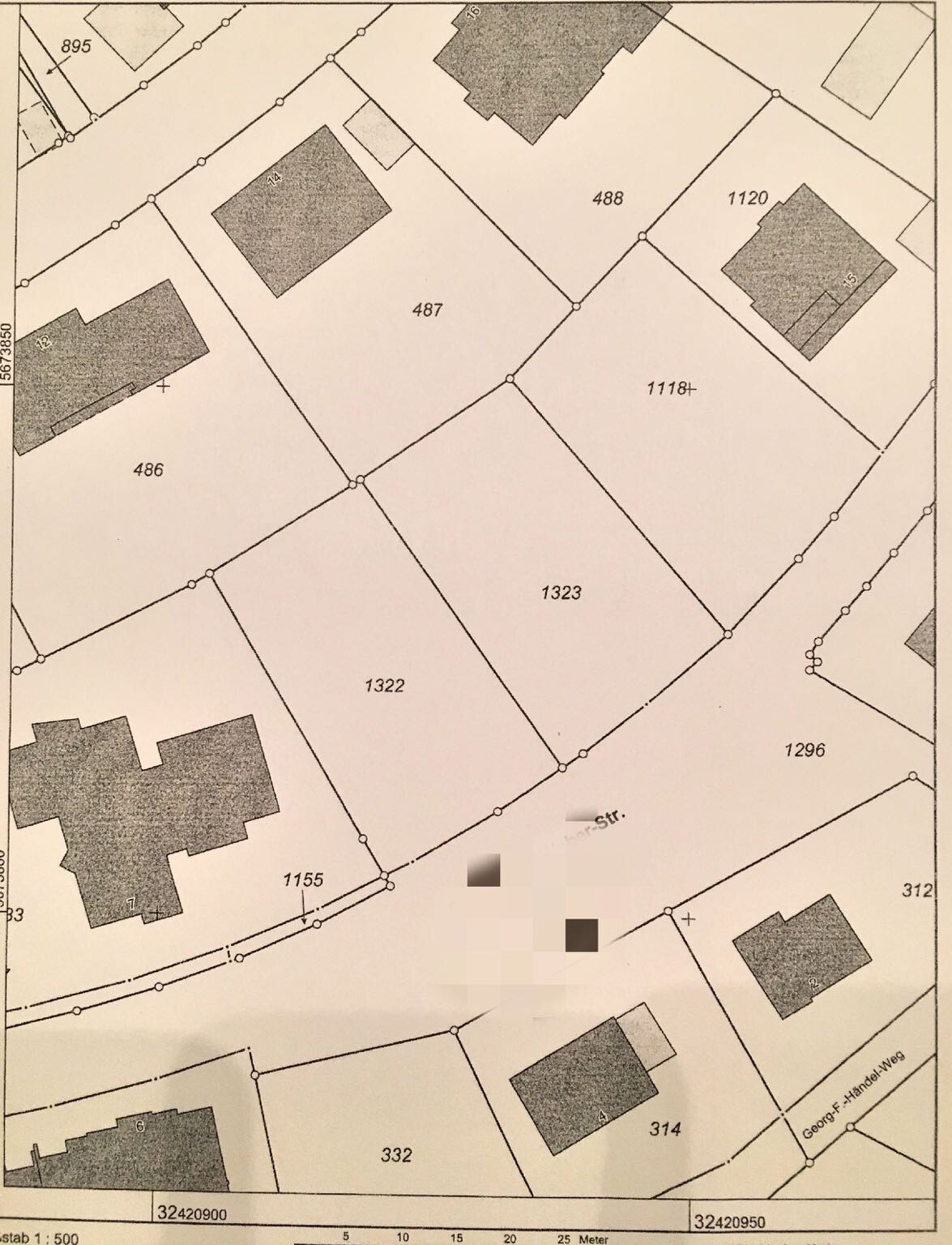

Ozzy20 schrieb:
This is what we have so far. It is the plot with the number 1323.
I hope this is enough to get some opinions.
