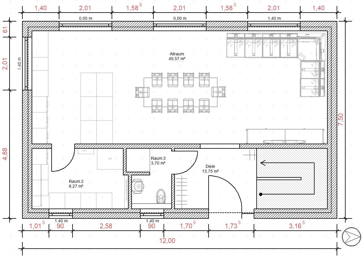

I’m voluntarily putting myself on the chopping block to present the current status of our planning.

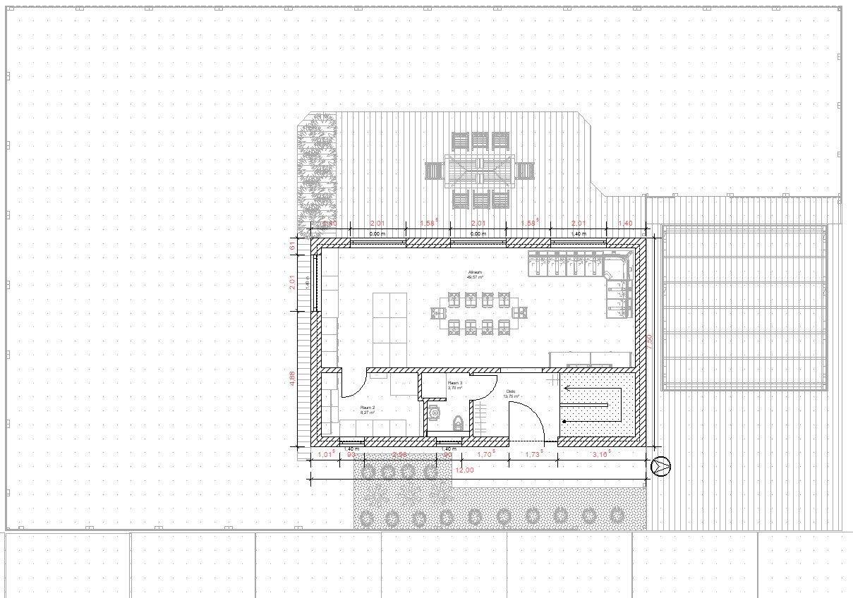

We are currently planning the construction of our single-family home. We have a plot measuring 30 x 18.8 m (98 x 62 feet). The plot is oriented northeast-southwest. There are neighbors on the north and south sides. On the east side is the street/driveway, and opposite is a newly built multi-family building. Therefore, we want the living rooms and terrace to face west.
We decided to work with a regional general contractor (GC) who individually designs and builds each house. It will be built as a solid masonry structure according to the Energy Saving Ordinance. The basic floor plan without furniture comes from the GC’s planner and is based on our discussions. I then redrew it and furnished it to represent the "worst-case" scenario. What does this mean? For example, we don’t always have 10 people in the dining area; a table can be added if needed. However, there should be enough space for that. The same applies to the study. This will be a study 99% of the time. If we have children in the future, it would need to become a combined study/children’s room. Space should be available for this as well. The second work area would then move from the children’s room to the gallery. In this sense, the furnishing partly represents more of a future scenario than the present one. In any case, all dimensions are realistic.

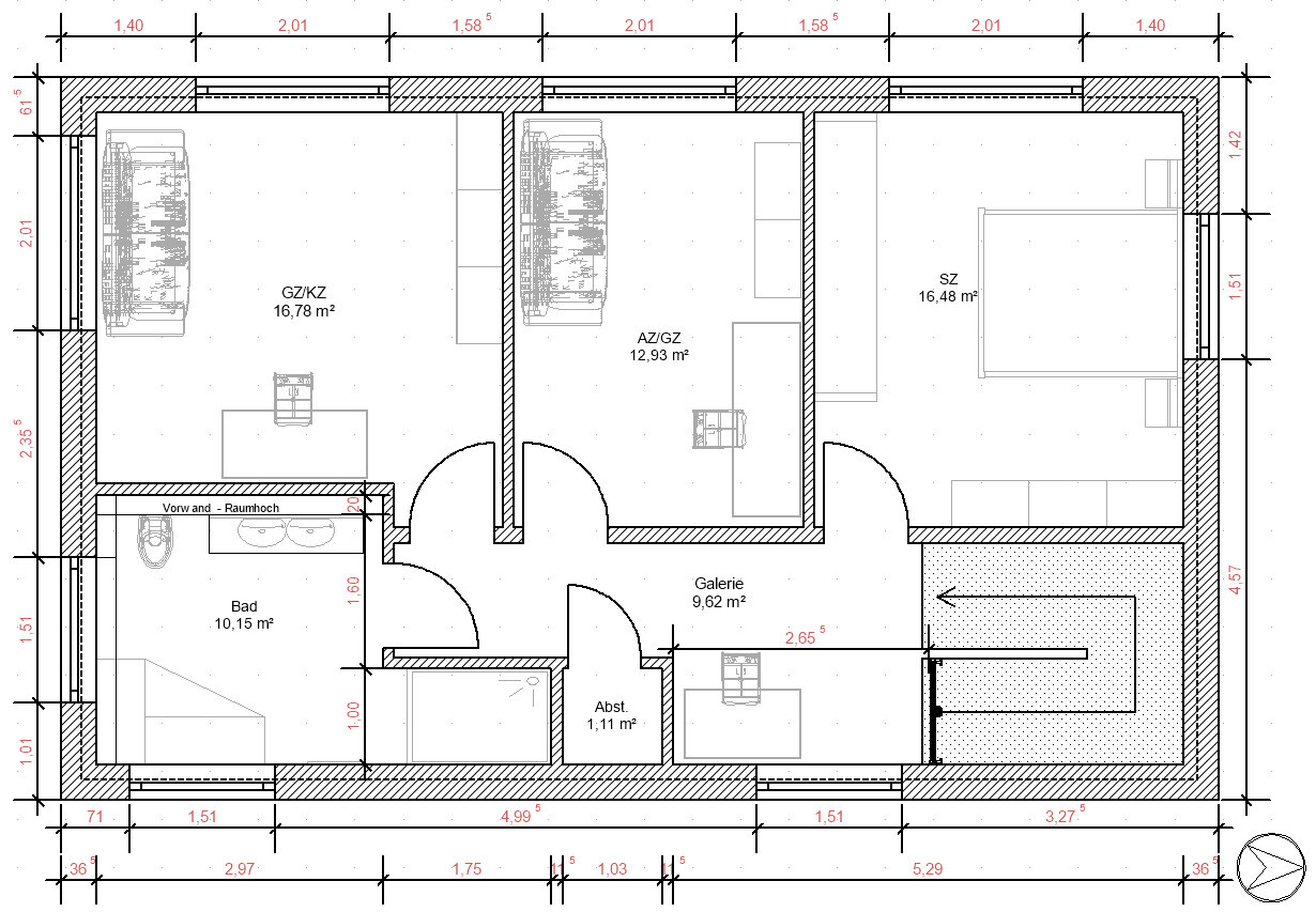

Upper floor: gallery with workspace, bedroom, study/child’s room, multifunction room (office 2/child’s room)
Office: He works 100% from home; She works 40% from home (if a child arrives, a small workspace will be set up in the gallery)

Functional rooms on the east side (street side), living rooms facing west (not overlooked), terrace to the west. We are not really “south-terrace” people; I prefer to stay inside.
I’m still unsure about the actual feel of the open living area (whether it feels like a narrow corridor or not). This can probably be visually balanced by furnishing, color scheme, and decoration to reduce any sense of “length.”

pagoni20203 Aug 2020 14:08We have a similar house layout, so I know that the "corridor" needs to be carefully considered to avoid it looking like a tunnel, which many people might not like.
We have an open space/gallery as well as a lot of window surfaces. Larger window areas seem to be missing in your floor plan so far.
You should definitely include real furniture dimensions in your drawings. The "emergency use 3-4 times a year" can always be managed somehow; a house doesn’t need to be specially designed for that. I would also consider a light/mobile piece of furniture or something similar between areas.
You can make something good out of the 50 sqm (540 sq ft) open space.
Upstairs, I find your bedroom quite small, and the bathroom door opening outwards is a design flaw that I wouldn’t want.
