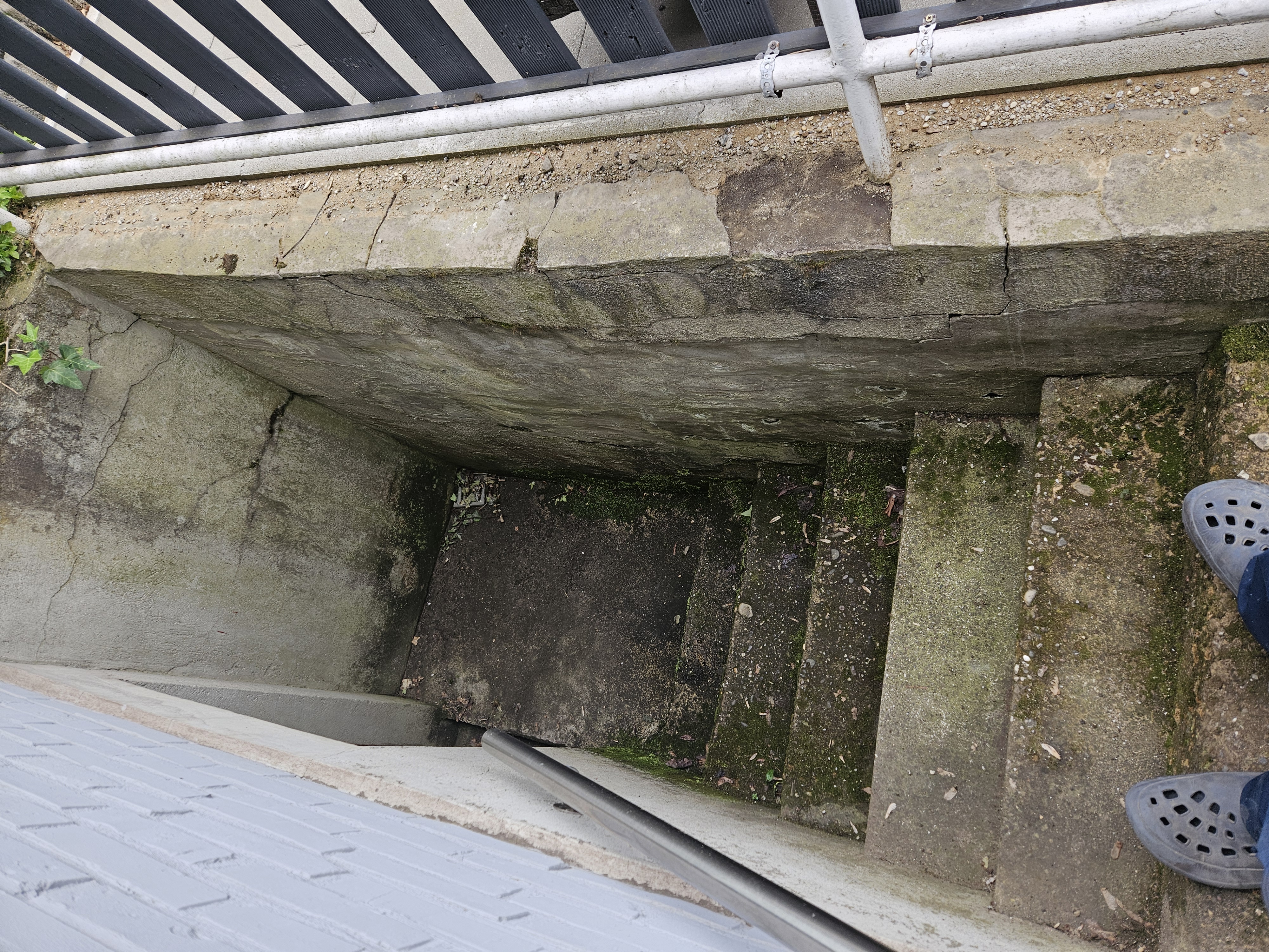

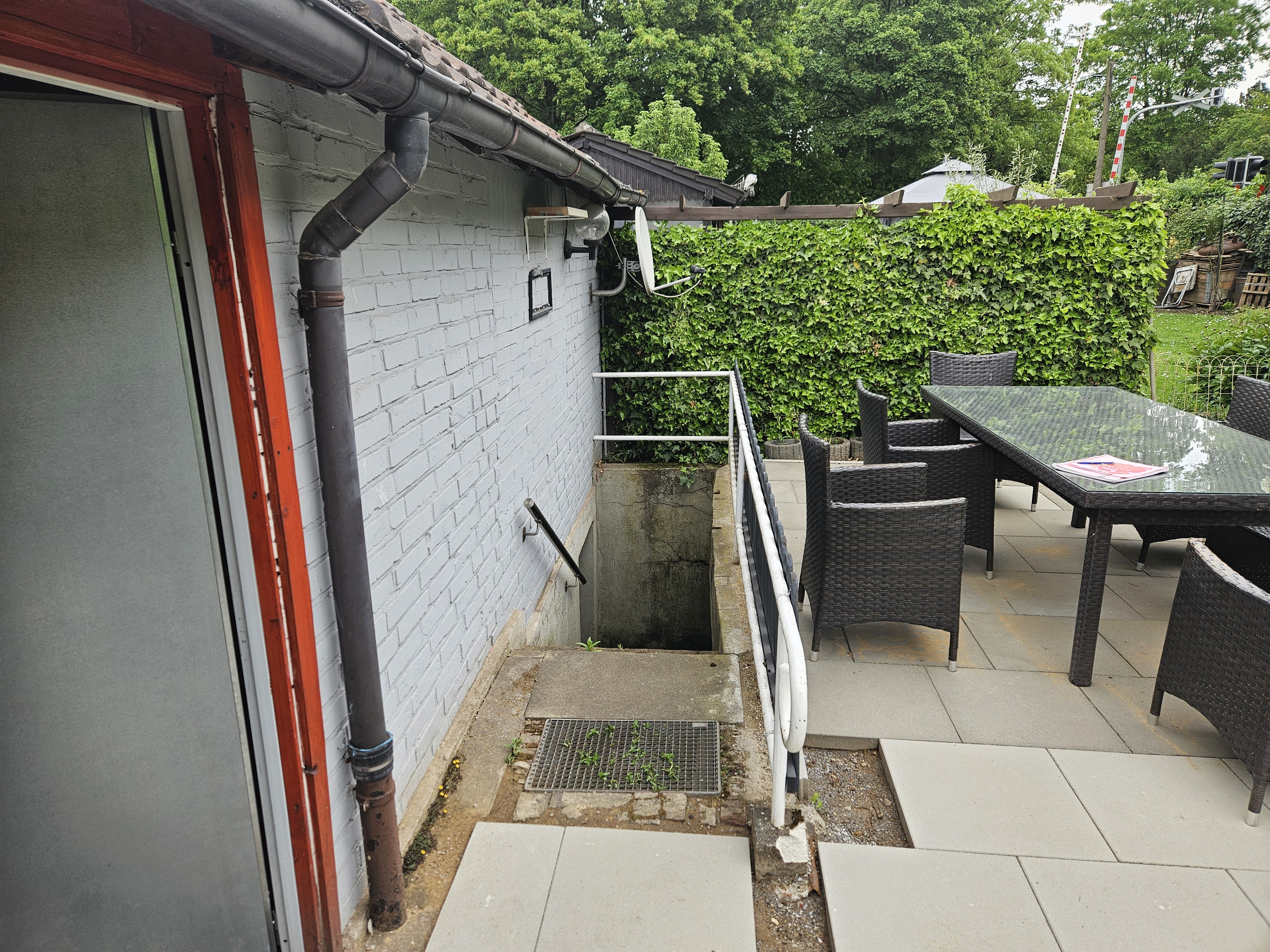

I have a garden shed in my allotment garden, and since I already have a large hut, I’m not allowed to build a pergola with a fixed roof (which probably wouldn’t be considered a pergola anymore). So, I came up with the idea of building a freestanding pergola and installing an awning that can extend over the pergola when needed. (I would replace the awning fabric with a PVC tarp to ensure it is waterproof.)
Unfortunately, I can’t attach an awning to my shed because the shed and gutter are too low, and there’s also a basement staircase in the way.
So, I would need to build a pergola and screw the awning to a wooden beam, but I’m unsure about this, as the right choice of wood is necessary and proper concrete foundations would be required.
I will upload some photos to give you an idea. Of course, I also considered fixing the beams to the basement wall, but I’m concerned about the stability of the wall (the garden is at least 70 years old), and I’m afraid the wall might crack.
The awning is 3.50m (11.5 ft) wide and extends 3.50m (11.5 ft). The pergola should be approximately 2.30m (7.5 ft) high at the highest point and about 2.0m (6.5 ft) deep at the lowest. The length should be around 3 meters (9.8 ft) and the width about 3.50 meters (11.5 ft).

I don’t know where I can edit my post or upload photos afterwards, so I am uploading the photos to illustrate here with this post.

What do you think about adding a support beam from the post, which is set at the railing, to the house wall (without screwing it into the wall) to counteract the lever effect?

I actually planned to attach it to the rafters from above (my neighbor next door did the same). However, the awning would be too short for the patio, so I thought about possibly screwing the pergola to the rafters (I need to check whether this is allowed) and then attaching the awning to a crossbeam, which would gain additional stability from the rafters.
I also considered screwing a 4-meter (13 feet) beam to the basement floor and basement wall, plus a support to the shed wall, and fastening the second post to the floor in front of the first basement stairs (behind the ground grid; the slab is about 10cm (4 inches) thick). A third post would have to be placed roughly in between, but it wouldn’t be as stable as the other two posts.
