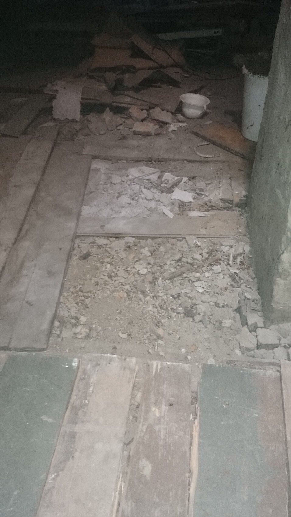

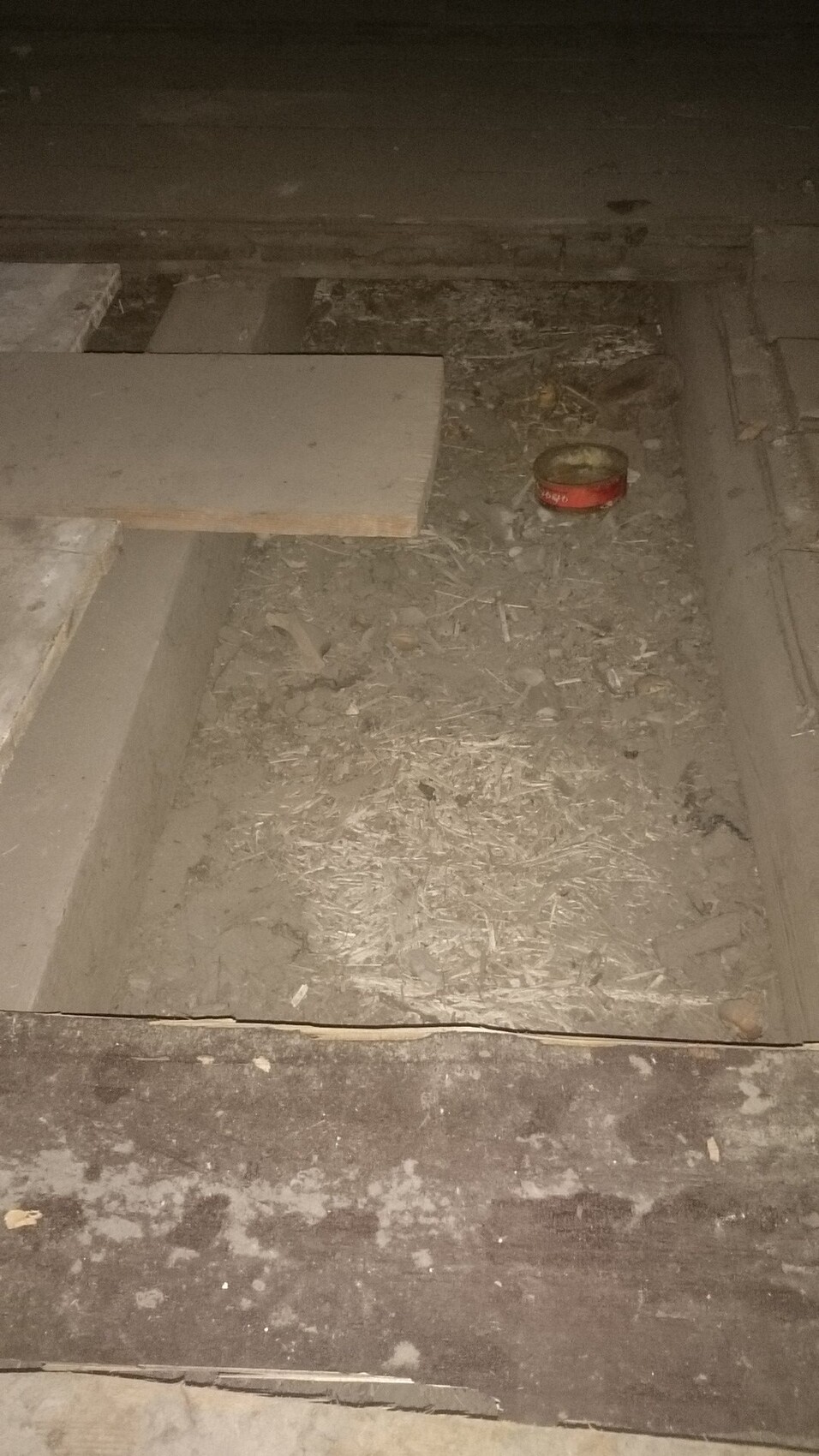

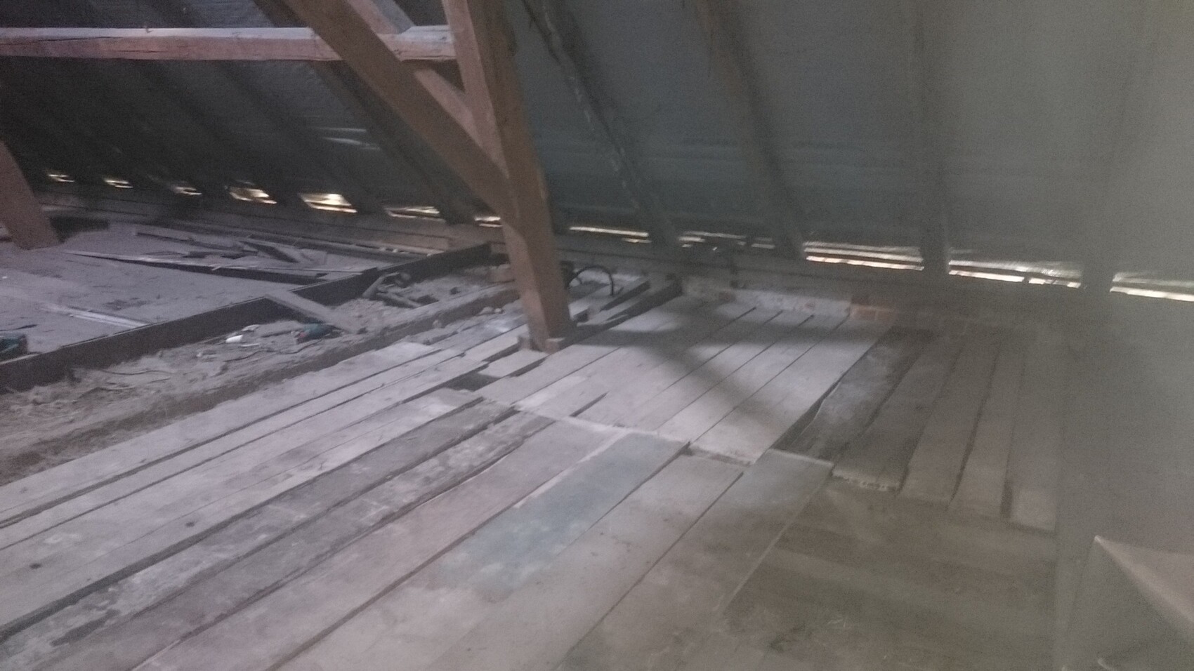

Hello, I’m not sure what to do next. I have read many pages about whether or not to use a vapor barrier. We were advised to lay polystyrene boards on the existing wooden plank floor and then put OSB panels on top. The floor should remain walkable. I am attaching several pictures for better explanation. We have a wooden beam ceiling with “sauerkraut boards” (wood wool boards) in between, and some rubble on top. Now the questions: Should we remove all the wooden planks and install insulation between the beams? Or just lay polystyrene boards on top of the planks and then OSB panels? Do we need a vapor barrier here? If yes, should it be placed on top of the “sauerkraut boards” and then insulation on top? I have no idea what the best solution is, please help!
If you want to insulate between the joists, you definitely need a vapor barrier underneath (vapor retarder vs. vapor barrier vs. climate membrane—all are different). Otherwise, moisture from the occupants in the room below could cause your insulation to mold.
This vapor barrier must be sealed almost 100% airtight all the way to the four walls. Be sure to consider the attic hatch. This could be challenging because you would need to remove your entire existing ceiling in the rooms below.
Alternatively, you might be able to lay a membrane on the floorboards or directly on the joists beneath, insulate with polystyrene boards, and then install OSB panels on top. I can imagine this might work, but I cannot say if it makes technical sense.
It could also help to get a subjective opinion from a building materials supplier. They want to sell their products, but you might still get valid alternatives along with price information.
