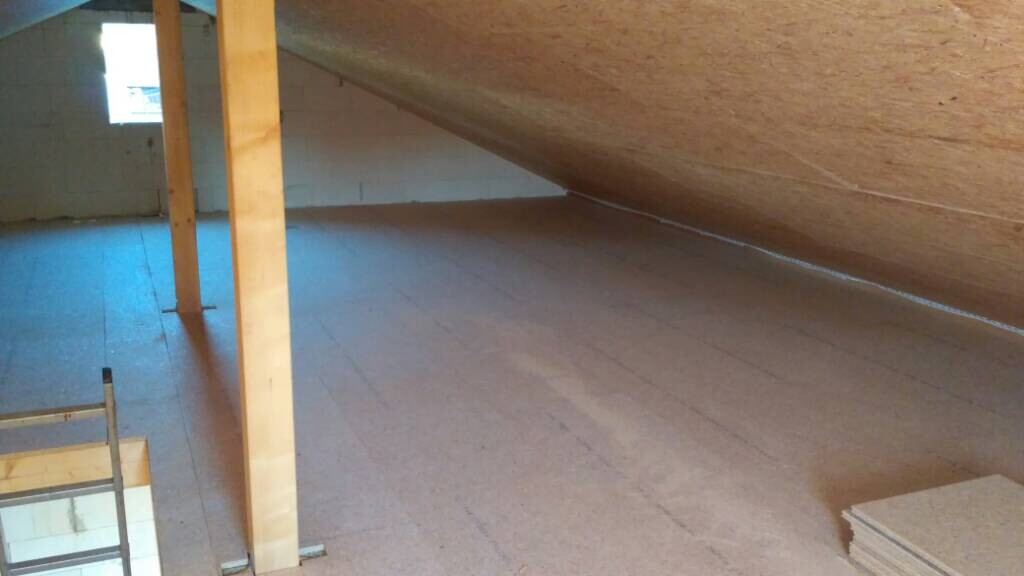

truce14 Aug 2017 20:41
We have installed ESB boards. Unlike OSB boards, these are vapor-permeable—similar to tongue and groove boards but easier and faster to install. They also look great.

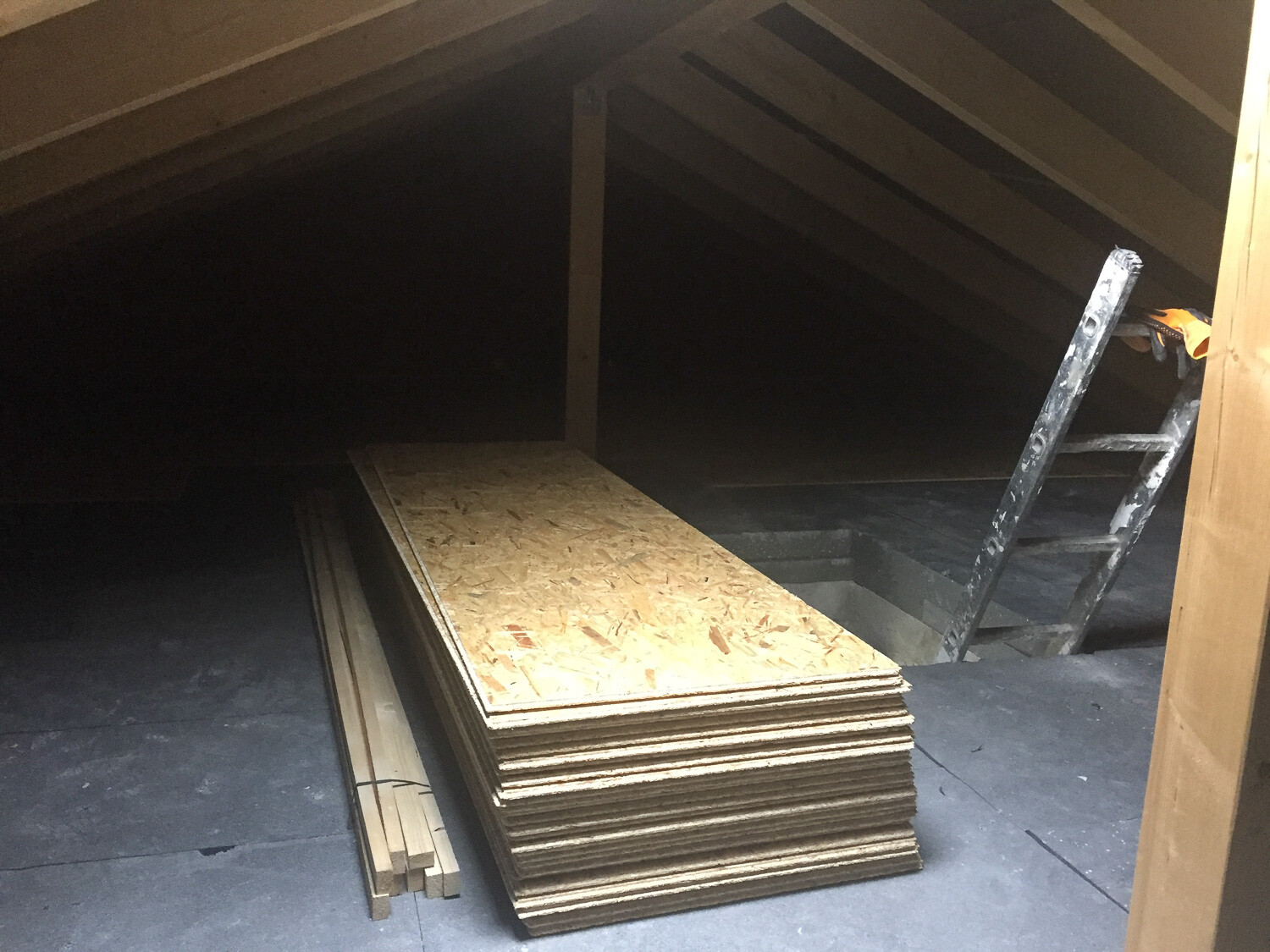

ooooA813 Sep 2017 23:02
what about an insulated reinforced concrete ceiling?
Can I lay the OSB panels without gaps here, or is there also a risk of mold problems?
Attic: stack of OSB panels and wooden battens; a ladder with work gloves leaning beside it.

14 Sep 2017 04:23
Is the ceiling new? Reinforced concrete is generally not vapor-permeable. So basically, it is possible. However, if the attic is not heated, you definitely need additional insulation!
ooooA814 Sep 2017 07:17
the attic is an unheated roof space, so it will not be heated. As you can see at the hatch opening, there is about 25cm (10 inches) of insulation on the concrete ceiling. Did you mean this insulation?

Joedreck
14 Sep 2017 08:57
Yes, exactly. In my opinion, there is no objection to that. The concrete ceiling already functions as a vapor barrier.
