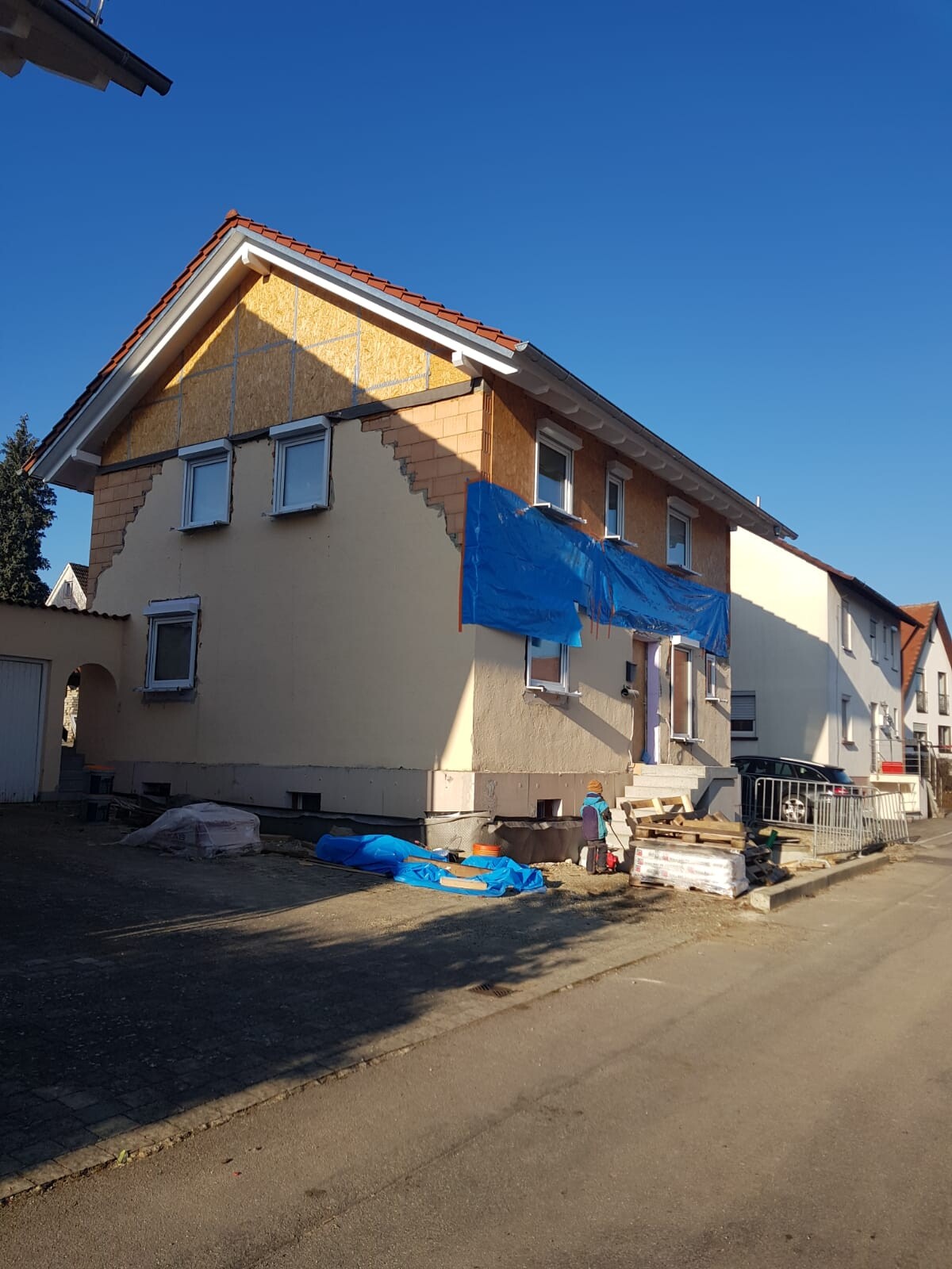

Baupfusch0815
16 Feb 2022 10:26
Attached is a photo of the house. This shows the current status.
Two-story house under construction with blue tarps and building materials in front of the facade.
11ant16 Feb 2022 12:47
Baupfusch0815 schrieb:
Now they should insulate and plaster, but the person from the company responsible asked why there is OSB on it. He said that wood fiber boards can’t be attached to that.
He should explain a) why not and b) how he plans to fix the boards. If he wants to glue them and finds the wood too smooth, there are primers available to pre-treat the surface. Removing the OSB panels again would be nonsense.
i_b_n_a_n16 Feb 2022 13:30
They probably *could* do it, but it’s not common practice. Most likely, this is because the installed OSB is vapor-tight. Usually, the wood fiber insulation boards are installed directly onto the rafters. Between the rafters there is insulation, and BELOW THAT a vapor-tight layer. If wood fiber insulation boards are placed on top of the OSB (is there insulation below the OSB?), moisture will accumulate in the wrong place, which can lead to mold and other serious problems. Since this involves a professional company, they would even be liable for consequential damage, even if you sign off that they should install it this way. Of course, this is just my “layman’s opinion,” as always without any guarantee.
Bottom line: Remove the OSB in good weather, then immediately install the wood fiber insulation boards on the rafters. Alternatively, make the OSB vapor-permeable (or there may be another reason for this → ask).
Why did this happen in the first place? Probably due to a lack of communication between the client and the contractor!
Tolentino16 Feb 2022 15:41
I don’t get it. The insulation boards are applied on the outside now, and then the breathable plaster goes on top. That’s the usual method, right? I’m not an expert in timber construction, but that’s how I understand it.
11ant16 Feb 2022 17:47
i_b_n_a_n schrieb:
Usually, wood fiber insulation boards are installed directly on the rafters. Between the rafters is insulation, and BELOW THAT is the vapor-tight layer. Now, if wood fiber insulation boards are placed on the OSB (is there insulation below the OSB?)
What do you mean by "rafters" and "below"? – we are not talking about a roof, but an exterior wall.
