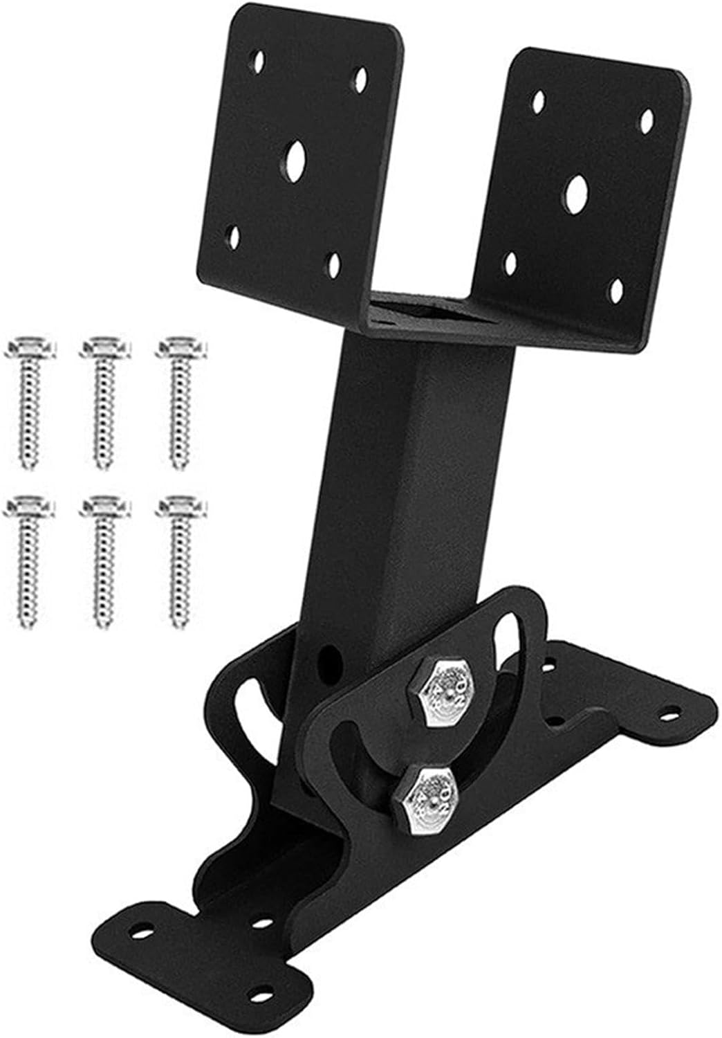

PS: I don’t want to use steel pipes. Also, another idea just came to me that might work: attaching the pergola with the roof rafters under the roof tiles, and thereby securely mounting the awning to the pergola. For example:
