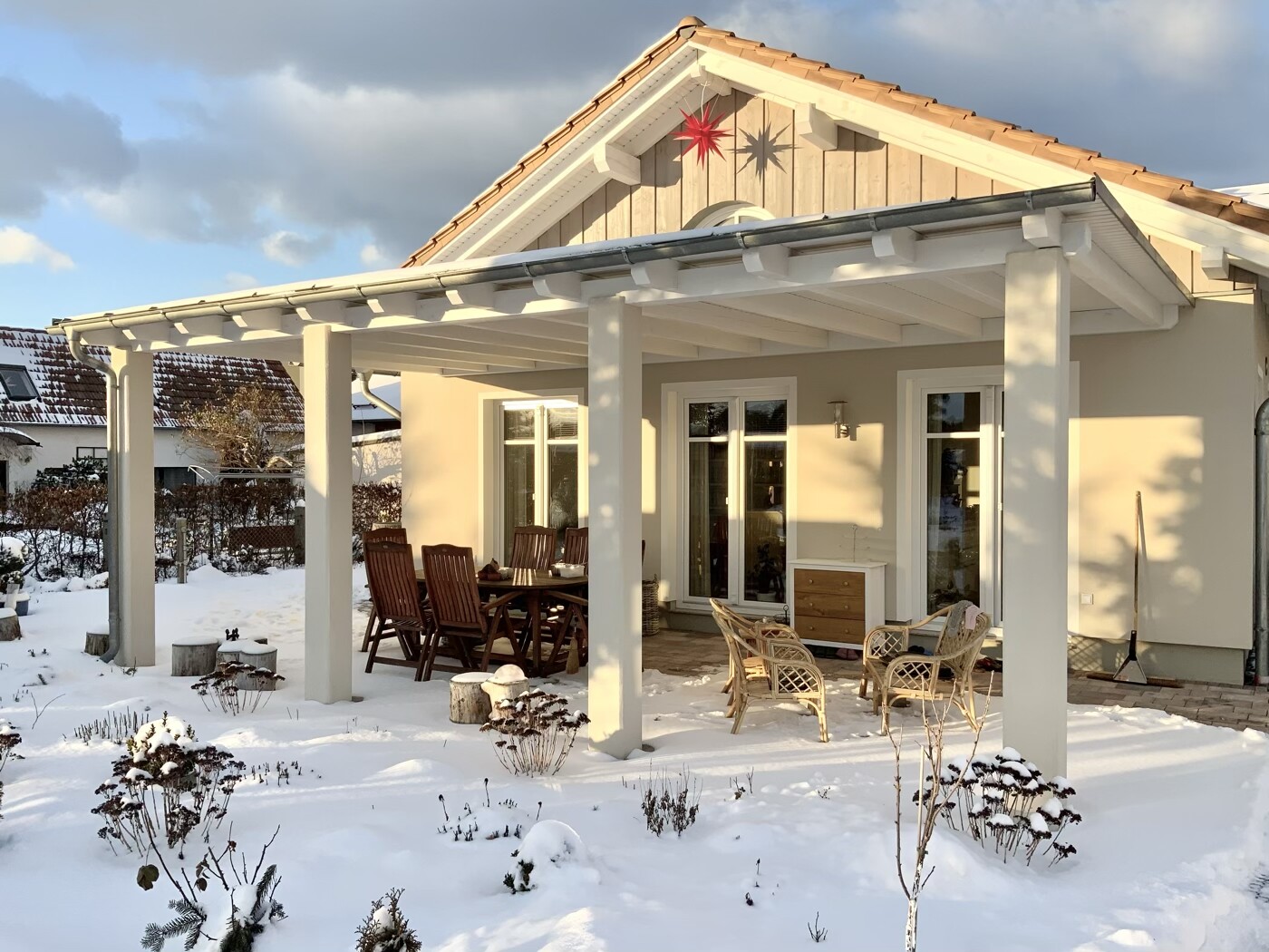

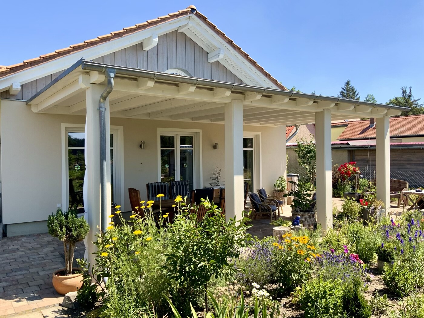

Hello, I am in favor of a solid roof. For our (7x4m) (23x13 feet) terrace, we paid about 8,500 EUR. We had the four sturdy columns installed during the house construction phase. The terrace roof (metal on top, wood underneath) was then added about two years later by our home builder. We love our terrace! It provides pleasant shade in the summer (we also have a south-facing side), and the furniture stays protected from the weather all year round. We also don’t feel that it darkens the interior spaces. We have plenty of windows all around. Here are some pictures (already shared a few times, but over time they tend to get lost).
