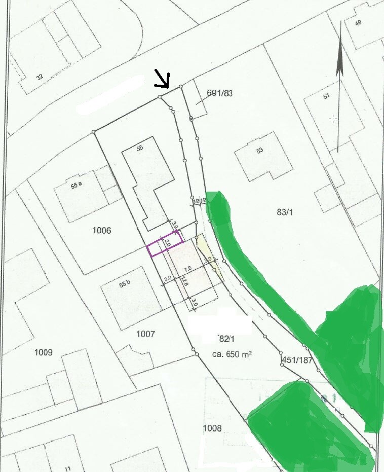

About the subdivision plan:
- green indicates forest or trees
- the north arrow is at the upper right
- the thick black arrow shows the driveway from the public path
- the purple lines are intended to represent the carport

I can’t understand how you want to fit in a parking space for 1 car, 2 motorcycles, and other items (don’t forget children’s bicycles, etc.) here:
You’d have to park everything in a row and constantly maneuver back and forth, right?
The 3m (10 feet) at the top of the plan ends at the property boundary, correct? And the house is only allowed within this approximately 760 x 1260 cm (25 x 41 feet) building area, which you’ve fully utilized? The 3m (10 feet) setback area at the bottom can’t be used?
The plan is to build a carport along the property boundary (shown at the top of the plan), either 3m (10 feet) or possibly 7m (23 feet) long. I already tried to sketch this out in the initial post:
There is no other option for placing a carport here. We are currently discussing the possibility of shifting the house 1 to 2m (3 to 6 feet) south, so we can build a slightly wider carport. The house is currently planned with an external length of 12.4m (41 feet), meaning we have 3.2m (10.5 feet) width to the neighbor (above).
We have two cars, which will be parked one behind the other. This is not ideal but unavoidable. One car will likely be parked in front of the carport, as a small shed is planned against the back wall of the carport (left side in the plan).
In the long term, a larger garden shed will be built to store motorcycles. We have plenty of space towards the rear (towards the forest).
