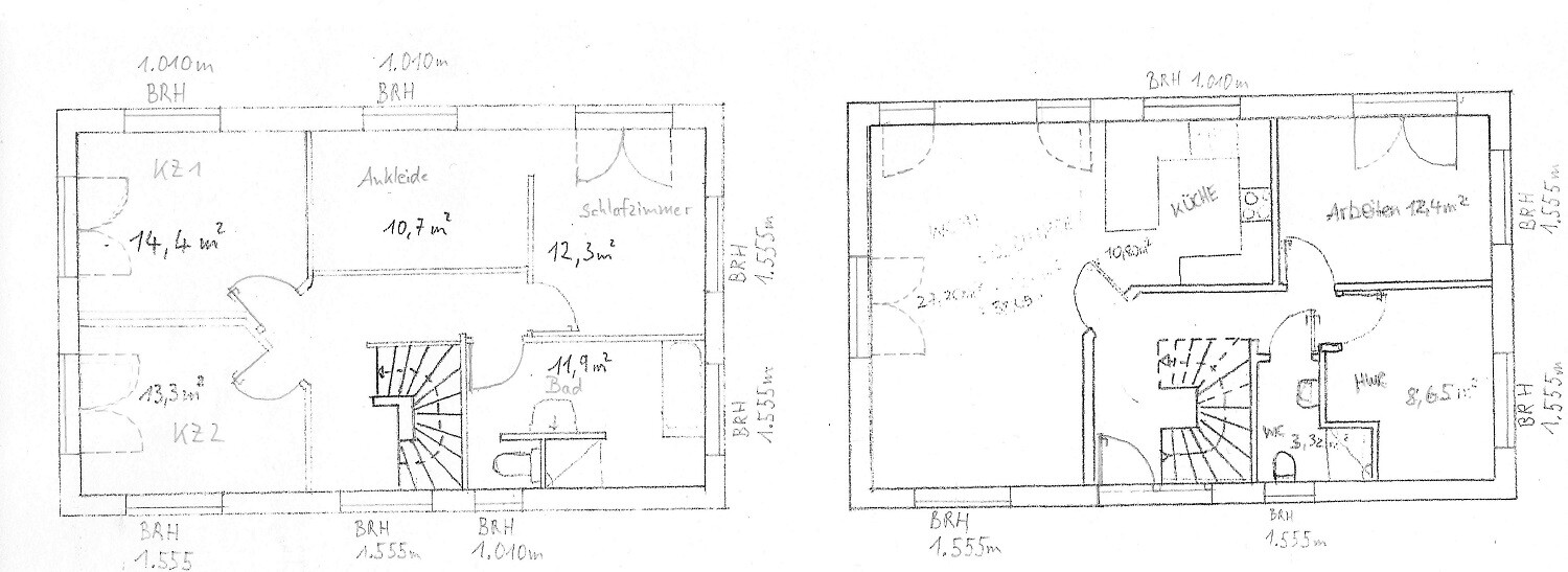

About the floor plan:
There are windows with a sill height of 1.555m (5 ft 1 in). These are somewhat high-level windows that are positioned relatively high on the wall. They can be seen here:

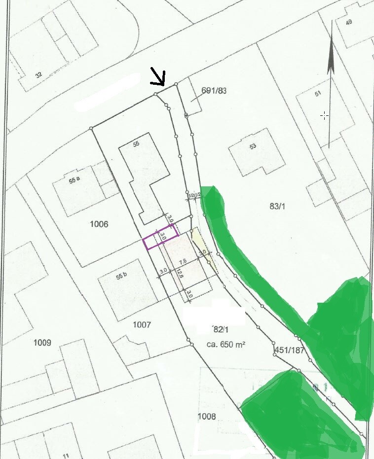

About the subdivision plan:
- green indicates forest or trees
- the north arrow is at the upper right
- the thick black arrow shows the driveway from the public path
- the purple lines are intended to represent the carport

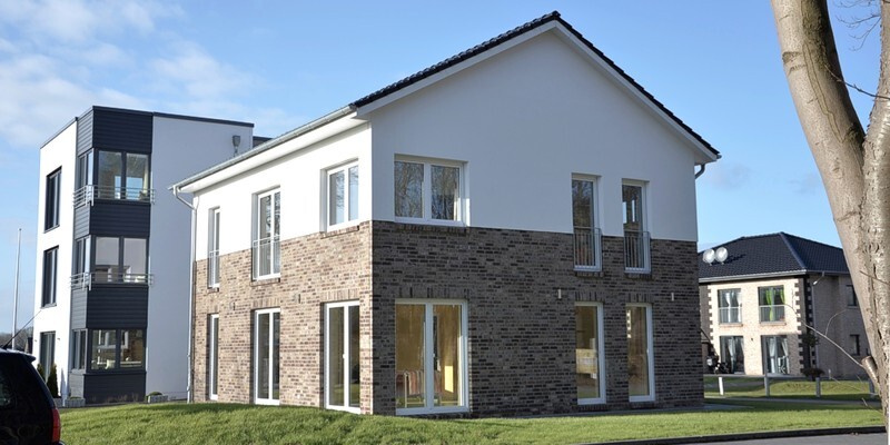

I have also uploaded a picture of the house from the construction company that serves as our base (although with a hip roof instead of a gable roof).

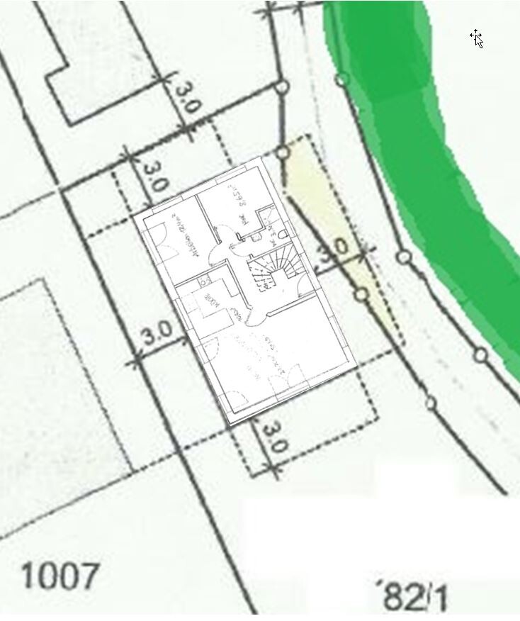

Here is our floor plan within the building envelope:

I just took another look at your surroundings on the map and noticed that none of your neighbors maintain even close to a 30m (100 feet) distance from the forest—so why should that apply to you? Especially since it’s not really a forest but more like a cluster of connected trees. It is certainly worth protecting, but a 30m (100 feet) setback? That might be appropriate on the outskirts of town, but not in the middle of a built-up area.
In your immediate neighborhood, buildings are also constructed deeper than what you are apparently (by default) allowed. Therefore, I would suggest arguing with the building authority that you comply with the site coverage ratio/floor area ratio but want to shift the position of the building envelope southward (possibly with neighbor consent and formalizing a deviation/encumbrance) to create more space for the garage and house.
Another thing I noticed—a former classmate of mine is a publicly appointed surveyor in SH and has his office less than 2km (1.2 miles) from your building site. I can put you in contact personally if you want, or you can contact him directly; there is only one publicly appointed surveyor in the town. You will need a surveyor anyway, and he might have some ideas on how to maximize the use of your land. Your building envelope, at 91m² (980 square feet), is tiny compared to the size of your plot, which should also make sense to the building authority.
I have also attached an updated sketch—if the house differs from the standard floor plan, you gain about +6m² (65 square feet) of floor area. The further the house moves south, the better, of course.

I believe your problem is that, on top of a challenging plot, you are limiting yourself by having a general contractor design the project instead of a creative architect, who tends to think beyond their standard house models. Even worse, you are imposing a time limit on yourself... Just because you recently purchased the land doesn’t mean the building permit or planning permission needs to be submitted within this year.
If I were you, I would allow yourself some flexibility in every aspect. You still have two quarters available.
Edit: You can have an architect create the design while still building with your preferred construction company.

The building authority isn’t really the problem here; it’s the responsible forestry office. The case officer from the building authority told me that there were already discussions with the forestry office during the preliminary approval. His recommendation is not to deviate from the preliminary approval (except for the additional 2m (6.5 ft) in front of the house that he approved). Whether the area is considered forest or not in the eyes of a "layperson" (not that you’re a layperson) doesn’t initially affect the zoning plan for the area, does it? To me, it’s still far from being a forest, but if the forestry office insists that we must observe this 30m (98 ft) distance, then I’d rather not do otherwise.
Regarding the publicly appointed surveyor, he (or one of his employees) has already been here to survey the plot and set boundary markers. I gave him my sketch with the changed position of the building plot, and he wanted to make sure that it fits correctly. It is currently with them for preparation for the land registry. The later boundary of the forest will have to be newly determined by the forestry office anyway, right?
As for changing the floor plan, I’m not sure if that is that easy to implement (also in terms of cost). The contract with the construction company is already signed. Although we can make changes to the floor plan, I doubt we can alter the external walls to such an extent. But I can ask about it…
