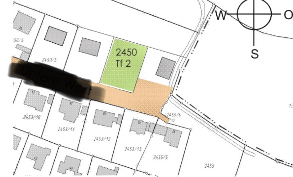

BauherrFranken30 Jan 2020 22:25Unfortunately, I do not have the site plan readily available.
BauherrFranken schrieb:
Unfortunately, I don’t have the site plan on hand. I’ll use a self-drawn one. Preferably even.
The building boundary and neighboring development would be interesting.
