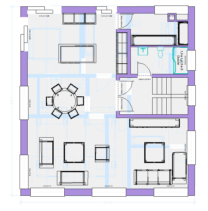

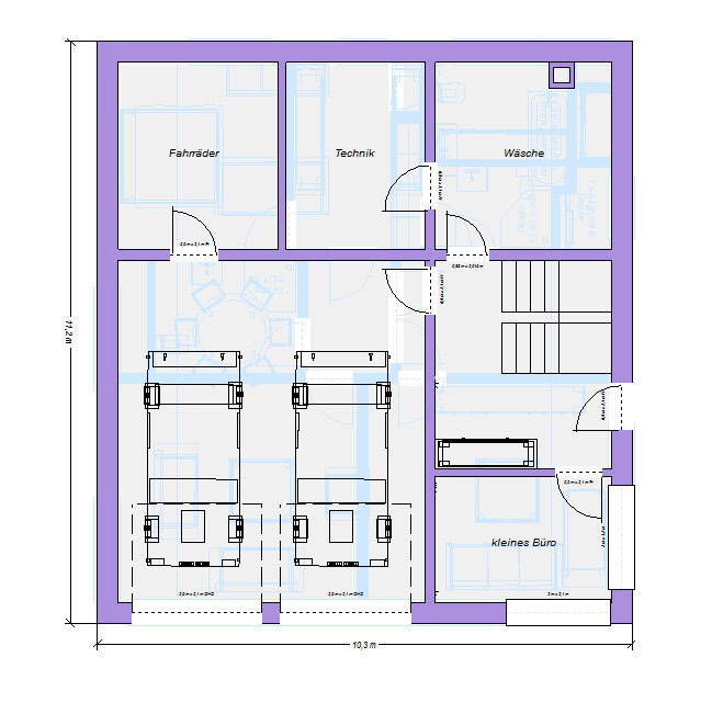

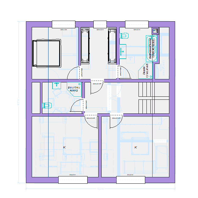

Dear forum members,
After purchasing the plot, we thankfully received today the initial draft from the architect of the general contractor.
Plot size: approx. 735 sqm (21 meters wide, 35 meters deep) (22,700 sq ft (69 ft) wide, 115 ft deep)
Slope: yes
Site coverage ratio: ?
Floor area ratio: ?
Building envelope, building line and boundary: basically at the rear part of the plot
Edge development: no
Number of parking spaces: 2 (double garage)
Number of stories: 2
Roof style: gable roof
Architectural style: modern
Orientation: south/north
Maximum heights/limits: 1.125 m knee wall at top
Other requirements: roof pitch 38 degrees
Homeowners’ Requirements
Style, roof type, building type: modern gable roof
Basement, stories: basement, 2 floors
Number of occupants, ages: 3 persons, 2 adults, 1 child (0.5), possibly one more
Space requirement: total 160-180 sqm (1,720-1,940 sq ft)
Office: family use or home office? Home office in basement
Guest bedrooms per year: none
Open or closed architecture
Traditional or modern construction
Open kitchen, cooking island: yes
Number of dining seats: 8
Fireplace: yes
Music/stereo wall: TV wall, possibly as divider between living and dining areas
Garage, carport: double garage with direct house access
Utility garden, greenhouse: flower beds and lawn
Other wishes/particulars/daily routine, also reasons why some things should or should not be included
Who created the plan: architect of the general contractor
What do you particularly like? Why? – Entrance located in the basement because otherwise a steep entrance staircase around the house would be necessary; home office with window in the basement; terrace on the garage; upper floor with separate bathroom for children.
What do you dislike? We don’t like the orientation. We would prefer the gable sides to face north/south (mainly for the view; as currently planned, from the upper floor the southern or city view is only visible through roof windows). On the ground floor, a laundry room is planned facing the sunny south, which we find less practical. With the office in the basement, the usable living area is now 212 sqm (2,280 sq ft). We think we can manage well with 180 sqm (1,940 sq ft) overall. Perhaps the children’s rooms are each 2 sqm (22 sq ft) too small. Also, we are not comfortable with the many small, irregularly arranged windows.
Price estimate according to architect/planner: approx. 550,000 EUR turnkey plus 20,000 EUR landscaping plus 10,000 EUR landscaping = 580,000 EUR
Personal price limit for the house, including fittings: 550,000 EUR
Preferred heating technology: ?
If you had to give up, which details/finishings
- Utility room on the ground floor
- Cannot do without: separate bathroom for children
Why is the design like it is now? For example,
We gave some initial verbal ideas but allowed the planner considerable freedom.
What is the most important/basic question regarding the floor plan in 130 characters?
The planner sees only this orientation as sensible; however, we do not like it. How could the ground floor be better designed despite the staircase at the south side, which takes space from more practical rooms (possibly the kitchen)? Any ideas on the exterior design?

The others have all positioned their houses further back to take advantage of the south-facing garden. If it’s really that quiet back there, I would do the same. Of course, it’s more expensive because of the utility lines and pathways.
However, I would keep the garage at the front—just a walkway leading to the back.
BauherrFranken31 Jan 2020 00:00Garages are usually located at the front. The neighbor on the right has integrated theirs into the house. This solution is simply more practical and aesthetically pleasing; we would prefer it that way as well.
Maybe rotate the house? It would be nicer for the children’s rooms and provide a wide west-facing orientation. Something like this:
Terrace on the west and north sides. However, you would have to build further into the slope. Tricky situation.
How far back do you want the house to be? Try placing the box roughly to scale on the plot so it’s clear where the garden will be.
