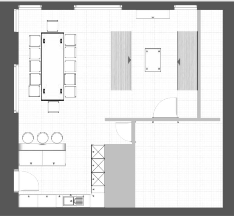

pagoni202028 Aug 2020 13:00I personally prefer an open kitchen, and given the frequent visits you seem to have, I would include the kitchen within a combined living space. This way, some doors or corners could be eliminated, making the entire area feel more spacious.
32 square meters (344 square feet) for dining and living space is not very generous considering your needs, especially with those two large doors leading to the dining room and living room, which further reduce usable space.
Of course, this depends on your individual requirements, but you should definitely visit show homes to get a better sense of these room sizes if you haven’t already.
Perhaps the bedroom could be moved upstairs, and the wall to the current ground floor bedroom could be built as a lightweight partition, or planned for later modification. I also like some room dividers, whether half-height, with mobile furniture, etc., depending on the use—home office, guest room, etc. Given the limited living space, the downstairs bedroom could be integrated into the living area, meaning it wouldn’t be strictly designed as a separate room but rather as a flexible space. For example, a desk area within the living room or a stylish sofa that doubles as a guest bed, or even a large sliding door.
Just a thought, since I see the 32 square meters (344 square feet) and kitchen layout in view of the number of people in your household.
The room dimensions in the plan are correct. The table in the example measures 300 x 100 cm (118 x 39 inches), and each sofa is 260 x 90 cm (102 x 35 inches).
From this example, you can see that as many walls as possible should be removed to avoid bottlenecks.
The position of the patio door also needs careful planning because the room is not very large and you don’t want to have to maneuver around the furniture. I simply moved the windows (just as an example).
This is less about what looks more modern; it’s about creating enough space to move around comfortably.
Actually, many of these points have crossed our minds as well, and now we are focused on finding the best possible solution.
Thank you both for the helpful tips and your effort!
At the moment, we are also leaning towards leaving out the walls/sliding door towards the kitchen to create a more open and spacious feel.
At least, in this case, the advantages would outweigh the disadvantages. We wanted to find a compromise between having the option to close off the kitchen (and thus contain the mess, smells, noise while cooking, etc.) and having openness to the kitchen when desired. But the sliding door takes up a lot of space.
We would like to plan the bedroom as a fixed room, but we might consider slightly reducing its size by moving the living room wall...?
@evelinoz
Thanks for the drawing!
We don’t actually need that many windows in the living room. I believe the south-facing side has some drawbacks in this regard!?
The table for 12 people doesn’t necessarily have to be positioned that way; in my view, it could also extend into the living room if needed, rotated by 90°. But it’s good to see that it would theoretically also work that way...
The kitchen is roughly planned like that in our minds too, although we would prefer a slightly wider window variant.
It’s good that you even included the door to the kitchen in your plan. We’re also debating what’s better: to have the door to the pantry “inside the kitchen” or rather in the hallway, so that groceries can be loaded directly from the hallway.
For the door to the living room from the hallway, we would prefer a sliding door. That was still the “old version” in the original drawing.
Thanks!
@evelinoz
Thanks!
pagoni202028 Aug 2020 14:01netuser schrieb:
Closing the kitchen (and thus containing the mess, odors, noise while cooking…) and having openness towards the kitchen when needed. But the sliding door does take up a lot of space. In my opinion, this is overrated since the kitchen is not a “dirty room” but, for example, at our place it is already used more or less as a living space, even when guests are there. I had sliding doors like this for years exactly for that reason, and they were always left open… such a waste of money that I could have better spent elsewhere.
netuser schrieb:
We actually don’t need that many windows in the living room. I believe the south-facing side also has some disadvantages in this regard, right!? I absolutely agree with @evelinoz and here again, the feeling of spaciousness would be my priority. If you have large glass surfaces, it feels like you’re living outside and the space appears significantly larger. You’ll need shading anyway, even if the window areas are small. Often a smaller, unshaded window area is enough to raise the temperature in the living area by a few degrees. Therefore, in my opinion, definitely more window area.
netuser schrieb:
We would want to make the door to the living room from the hallway a sliding door. We were in a similar situation, with a 140cm (55 inches) wide opening, and decided on a floor-to-ceiling, two-panel glass hinged door with movable parts in both directions. That might be difficult to implement with the current floor plan. In general, I don’t find sliding doors very comfortable because a hinged door is easier and more convenient to open.

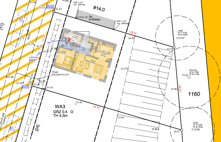

I have placed the house on the site plan. Gussek Haus builds the dormer for the bathroom so frequently that they will definitely know how to do it—otherwise, I would have marked it with a question mark. I am still not entirely satisfied with the slope. After all, it has a height of about 1.15 m (3 ft 9 in).
netuser schrieb:
Actually, I forgot to mention that my focus is purely on evaluating the floor plans, not the furniture layouts shown. Of course, I’m open to opinions or suggestions if the floor plan is fundamentally suboptimal for furnishing, but the illustrations in the drawings are just examples and not finalized.
But an evaluation of the floor plan without realistic furniture is complete nonsense to me. Take the bedroom and arrange it the way you want.
