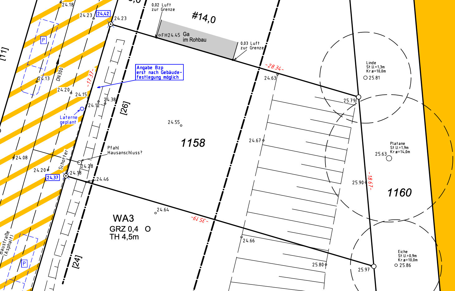

The plot drawing is oriented to true north, the floor plans are not. The top is south, the bottom is north. This means the garage, entrance, and utility room are deliberately placed on the north side. The kitchen and dining/living room should have access to the garden on the east side. Possibly, we would like to design the terrace wrapping around the corner to the east/south.

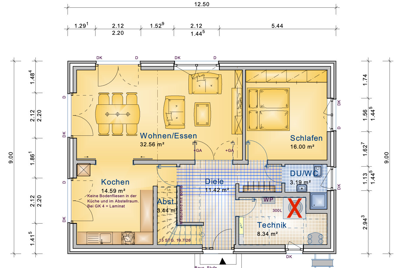

The utility room is a bit small, but should be acceptable since the water tank marked in red does not fit in after all.

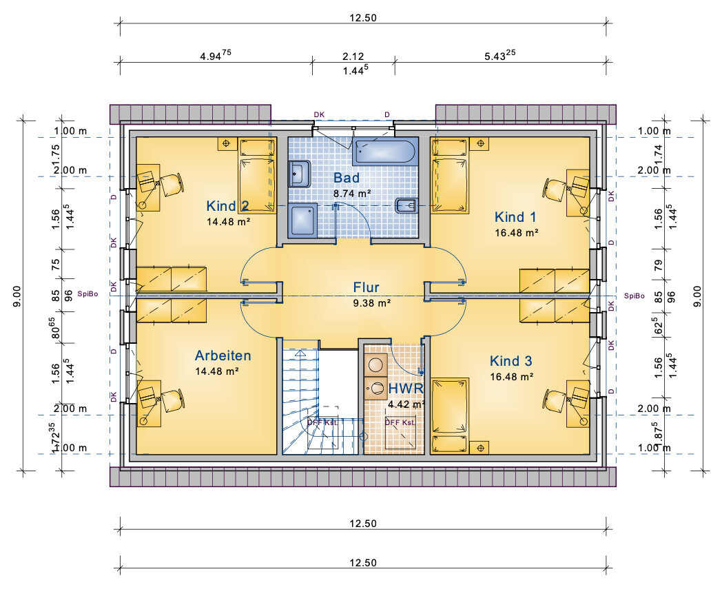

| What do you not like? Why? | At first we saw the east orientation as unfavorable, but now we also see some advantages. The ground floor WC does not yet have a suitable solution for the shower. The bathroom on the upper floor is not optimal yet and feels a bit too small. |
We do not want or cannot give up the number of rooms at the moment. However, if it makes sense to shift walls here and there or change rooms, we welcome suggestions.

Alessandro28 Aug 2020 12:41You need to rotate the table by 90° for it to fit. It’s tight, but it works.
Otherwise, I think the floor plan is very good!
evelinoz schrieb:
The kitchen won’t work, there is not enough counter space and too many “gaps” in the walls. A 100cm (39 inches) patio door and an attached island would work.
The wardrobe is too small for 5 people. Thanks to both of you!
Actually, I forgot to mention that my focus is purely on evaluating the floor plans, not the furniture layouts shown. Of course, I’m open to opinions or advice if the floor plan itself is fundamentally suboptimal in relation to furnishing, but the furniture shown in the drawings are just examples and not finalized.
For instance, the table position in the dining room and the kitchen layout.
The furniture in the bedroom also doesn’t fit properly, as mentioned, it was only a placeholder.
We are still uncertain about the following points:
1. Whether to keep the large kitchen window (door) or replace it with a narrower one!?
2. Whether the kitchen should remain open or “semi-open” as shown in the drawing with sliding doors.
3. The staircase is currently planned to be enclosed to create a small storage room/pantry underneath.
Here, the cost-benefit ratio is key: Is the likely small gain in space worth an extra 2,000 EUR (approx. 2,000 USD)?
The wardrobe space is intended only for hooks and shoe storage. That’s why it’s around the corner—to keep all clutter out of immediate view from the entrance area.
If the staircase stays enclosed, we would also like to place a “discreet wardrobe” or closed closet (with mirror) for clothes in front of it.
That should be fine, right?
