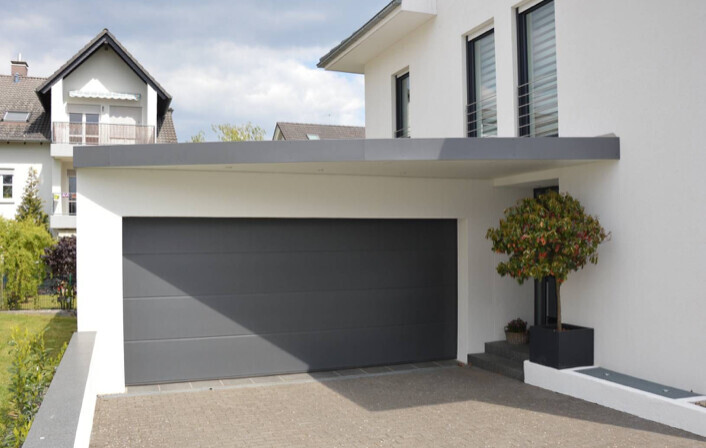

Because our garage cannot be very long due to the "low-lying" entrance on the north side, we are considering making it wider instead. I am thinking of approximately 4.5 m (15 ft) wide by 6 to 7 m (20 to 23 ft) long, which we would build ourselves (masonry). Are there any recommendations or important points to consider regarding these dimensions? For example, concerning the roof, which must be built as a flat roof according to building regulations. Or any other experiences?
In connection with the garage, which would have to be positioned quite close behind the entrance, I am also considering having a canopy built for the entrance area. See the example image.
Which type of companies would be best to contact for proper planning and quotes? Local carpenters and/or roofers?
Alessandro31 Aug 2020 10:064.5m (15 feet) sounds reasonable for a car to still pass through alongside a bike, wheelbarrow, etc. For this type of canopy, a carpenter is your go-to professional.

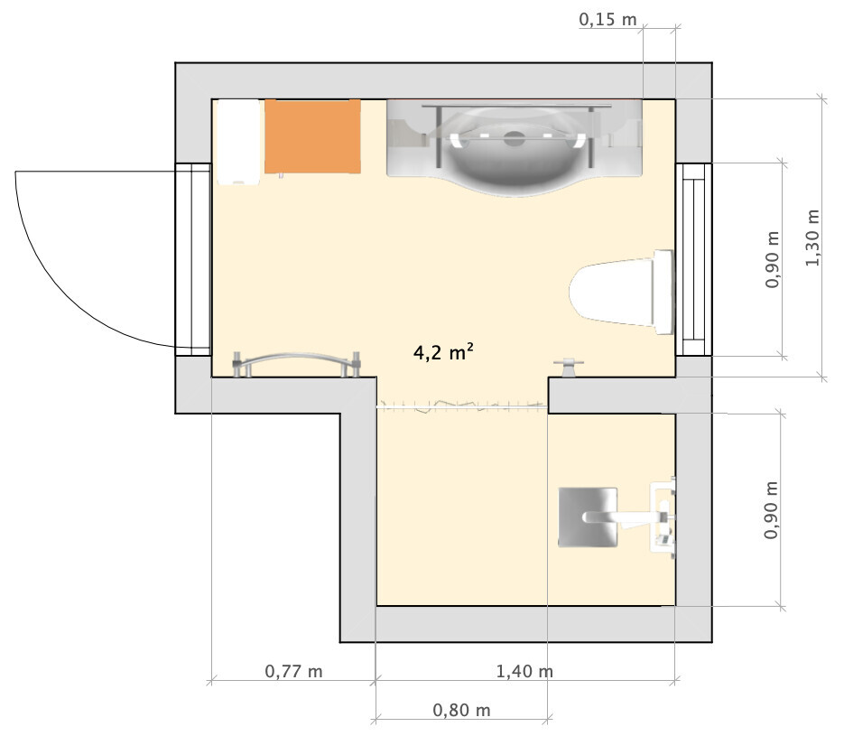

Since I don’t assume (please correct me if I’m wrong) that the parents climb upstairs every day to use the bathroom occupied by 3 kids, the guest toilet (intentionally) on the ground floor serves as the parents’ master bathroom... 1.13 meters (3 ft 8 in) wide and 1.80 meters (5 ft 11 in) long... with a 40 x 28 cm (16 x 11 inches) sink (external dimensions!) and practically no space for a cabinet or similar to store basic bathroom essentials. Are you aware of this, or—seriously—isn’t that important to you?
Certainly not unimportant, so you are of course right.
Although we don’t need a spa retreat, at least not in the small bathroom, we will still work on it...
If we manage to reduce the size of the utility room, maybe something like this!?
