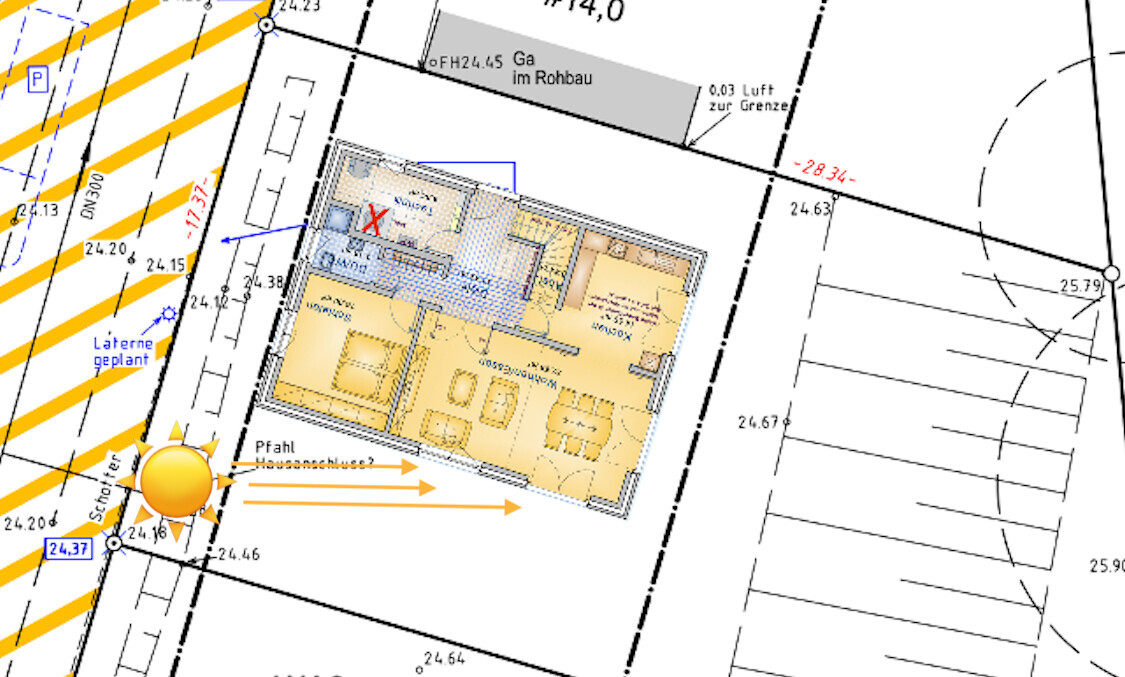

Good day and hello dear forum community!
As a family of five, we have planned to build a house ourselves—or rather have it built—by summer/autumn 2021.
We already purchased a plot of land in 2019, the construction contract with Gussek Haus is signed, and the financing is largely arranged. So now we are about to enter the critical planning phase with the architect, where all details will be thoroughly reviewed, adjusted back and forth, and the building permit (planning permission) application will be prepared.
Since the attached drawings represent only a "rough draft" and can and should still be adjusted, I would greatly appreciate your assessments, advice, or criticism. Especially the latter, as long as it remains constructive, is very welcome.
About our situation, requirements, and wishes:
(Thanks to ypg for the template )
Owners’ Requirements
If you have to give up something, which details/fixtures
We want to make the best possible use of the available space and design it to be practical.
The plot drawing is oriented to true north, the floor plans are not. The top is south, the bottom is north. This means the garage, entrance, and utility room are deliberately placed on the north side. The kitchen and dining/living room should have access to the garden on the east side. Possibly, we would like to design the terrace wrapping around the corner to the east/south.
We do not want or cannot give up the number of rooms at the moment. However, if it makes sense to shift walls here and there or change rooms, we welcome suggestions.
The utility room is a bit small, but should be acceptable since the water tank marked in red does not fit in after all.
What is your most important/basic question about the floor plan, summarized in 130 characters?
Valuable advice is welcome! Many thanks in advance!

Smialbuddler schrieb:
So: personally, I would support your plan to face the garden to the east. The view IS nicer than even the most beautiful nearby flowering hedge. Thank you for your comment!
That is exactly our hope and current opinion—that the advantage of having an unobstructed view of the garden in that location should outweigh the alternatives.
We will see how things ultimately turn out. Regarding the current design, I also hope that with sufficiently large windows, some west-facing sunlight will still reach the living room.
Smialbuddler2 Sep 2020 09:11netuser schrieb:
Regarding the current plans, I also hope that with sufficiently large windows, some western sunlight will still reach the living room. The sun moves from south to west, and it only reaches the far west at sunset. Depending on the window size and room depth, your room will still be bright due to mostly diffuse light. I would recommend that you ask your architect specifically how they assess the lighting. Personally, I believe your room is not deep enough for dark corners to form given the nearly floor-to-ceiling south- and east-facing windows.
netuser schrieb:
That is exactly our hope and the current opinion—that the advantage of having an unobstructed view of the garden at that spot should outweigh other considerations. In the end, it really comes down to personal priorities. Would you prefer cheerful, direct evening sunlight inside the house or a view of the garden illuminated by the sunset to watch the birds? Your “wall” at the eastern edge of the property is also planted, and the trees are tall enough to create a beautiful play of colors.
