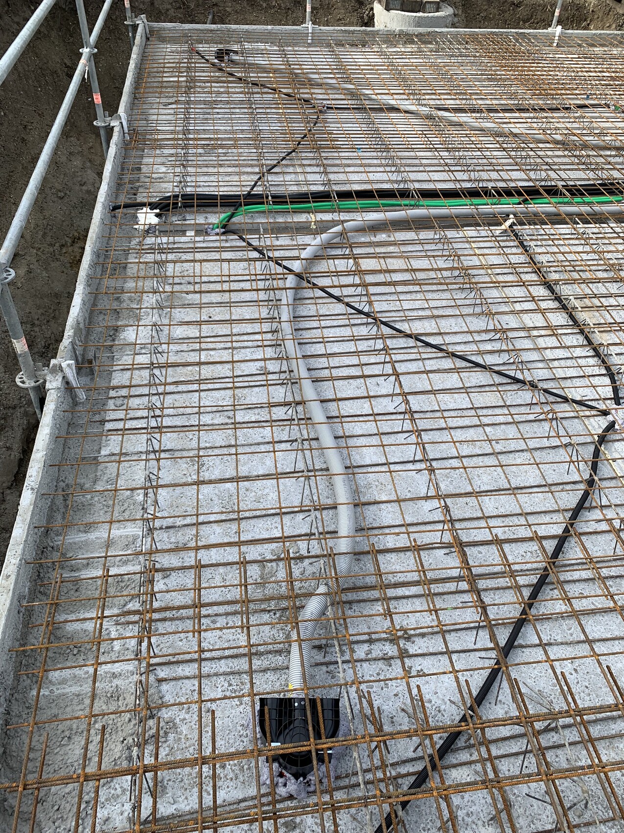

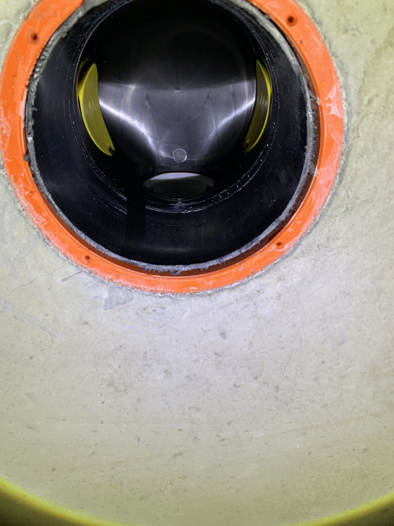

Since the ventilation ducts have already been damaged in several places, I’ve looked into the issue more closely. I noticed that all the ducts are fixed to the flat distribution box in the concrete ceiling using self-tapping screws. Unfortunately, I haven’t been able to find out which manufacturer was installed so that I could research further. In general, I would say that screw heads have no place inside a ventilation duct.
Attached are a few photos. Could you give me some keywords or suggestions on how to find out more about this? I don’t want to approach the general contractor with a suspicion just yet; I want to be absolutely sure myself first whether this is unacceptable.
Thanks in advance for your assessment.

Allthewayup2 Oct 2023 10:18I just spoke with Technical Support.
According to the manufacturer, the pipes are secured by fully inserting them, so they basically snap into place. Fixing them with screws is not necessary. At the moment, this is not considered critical for the system’s current state, since there is a filter in every air inlet that prevents dust from entering the system at all. It’s a different story when it comes to cleaning the system. Special tools are used for that, which no longer fit into the pipe because the screws are in the way. Additionally, the system is designed to be neutral (surfaces, odors, etc.). The galvanized steel screws simply don’t fit into that concept. Not that you would smell them or anything like that, but they now represent a potential weak point in the system. As expected, the only option will be to slightly conceal them (cut off the screws), but that won’t undo the issue.
I need to sort this out for myself first and consider how and when to raise the issue. The goal should be to enable future cleaning (so all screws must be cut off) and to cover the slightly increased risk of another damage event (e.g., screw remnants beginning to corrode). According to the technician, any kind of chemicals have no place inside the pipes, especially regarding sealing screw remnants with resin.
Really frustrating stuff :-/

Allthewayup2 Oct 2023 12:02RotorMotor schrieb:
Is cutting off really that beneficial?
Doesn’t it introduce metal shavings and could the screws rust because the galvanizing is damaged? You could also leave the screws as they are until the ducts need or should be cleaned. That might be in 5 years or even 20 years. Cutting them off is definitely not ideal, but if the ducts are ever going to be cleaned, it’s probably unavoidable. I’m not sure what’s better right now. Cut them off now and see what happens in 4 years (warranty period) or leave them as is (never change a running system). The metal shavings could be vacuumed out since the screws are about 5–7cm (2–3 inches) away from the outlet. You can see the screws with the naked eye from below.

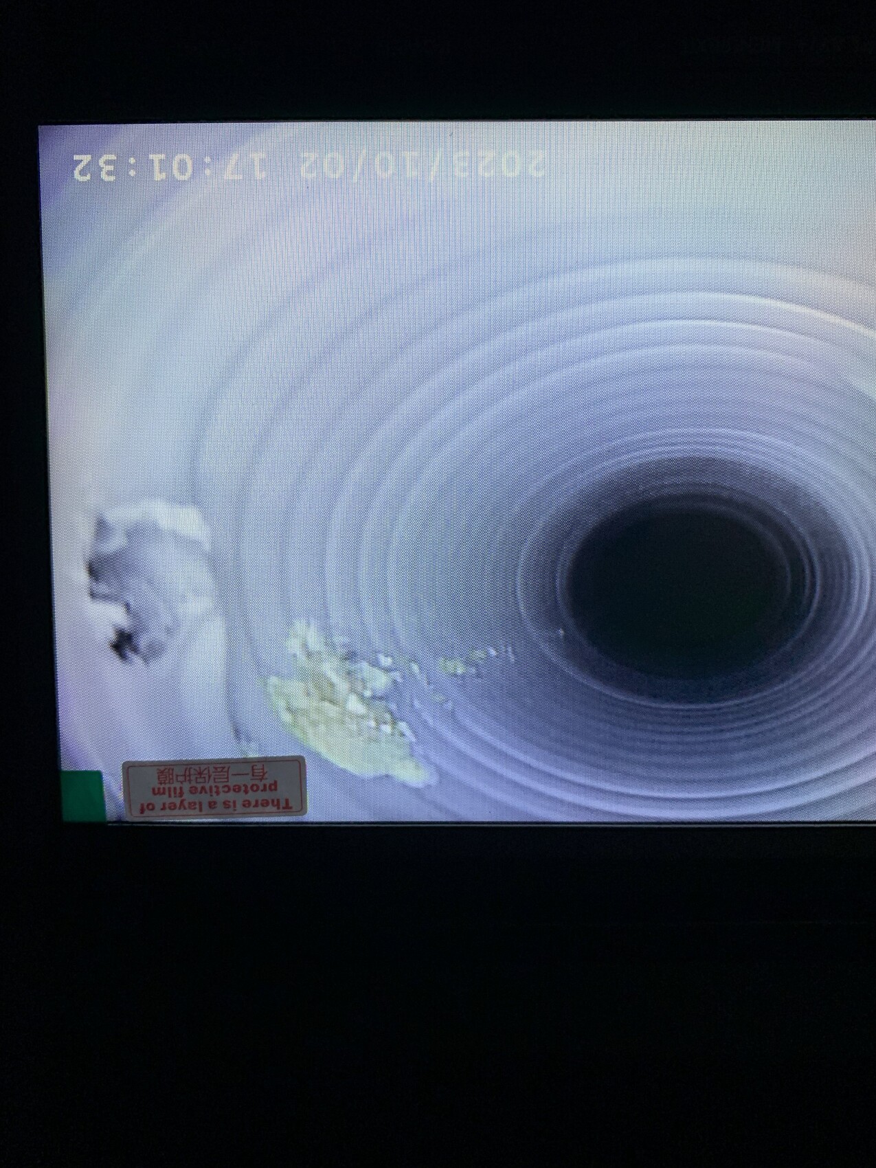

I just checked part of the ventilation ducts with my inspection camera and found an additional drill hole damage near the air distribution box. Couldn’t get any better :-D
