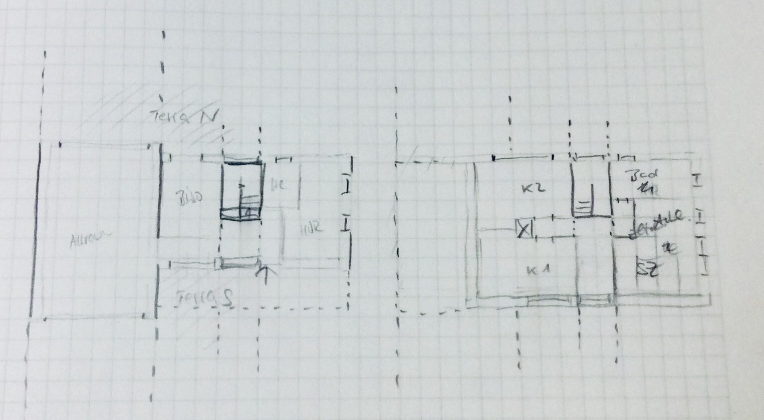

Just a quick sketch, as I couldn’t get “the wing” out of my mind.
The wing to the west, opened with window fronts facing north and south. Entrance in the “main house” on the south side. The upper floor is not built over the wing. The upper floor has an overhang on the south side, creating a terrace and: privacy screening mainly from anything located to the west.
The garage can be connected to the utility room on the south side.
