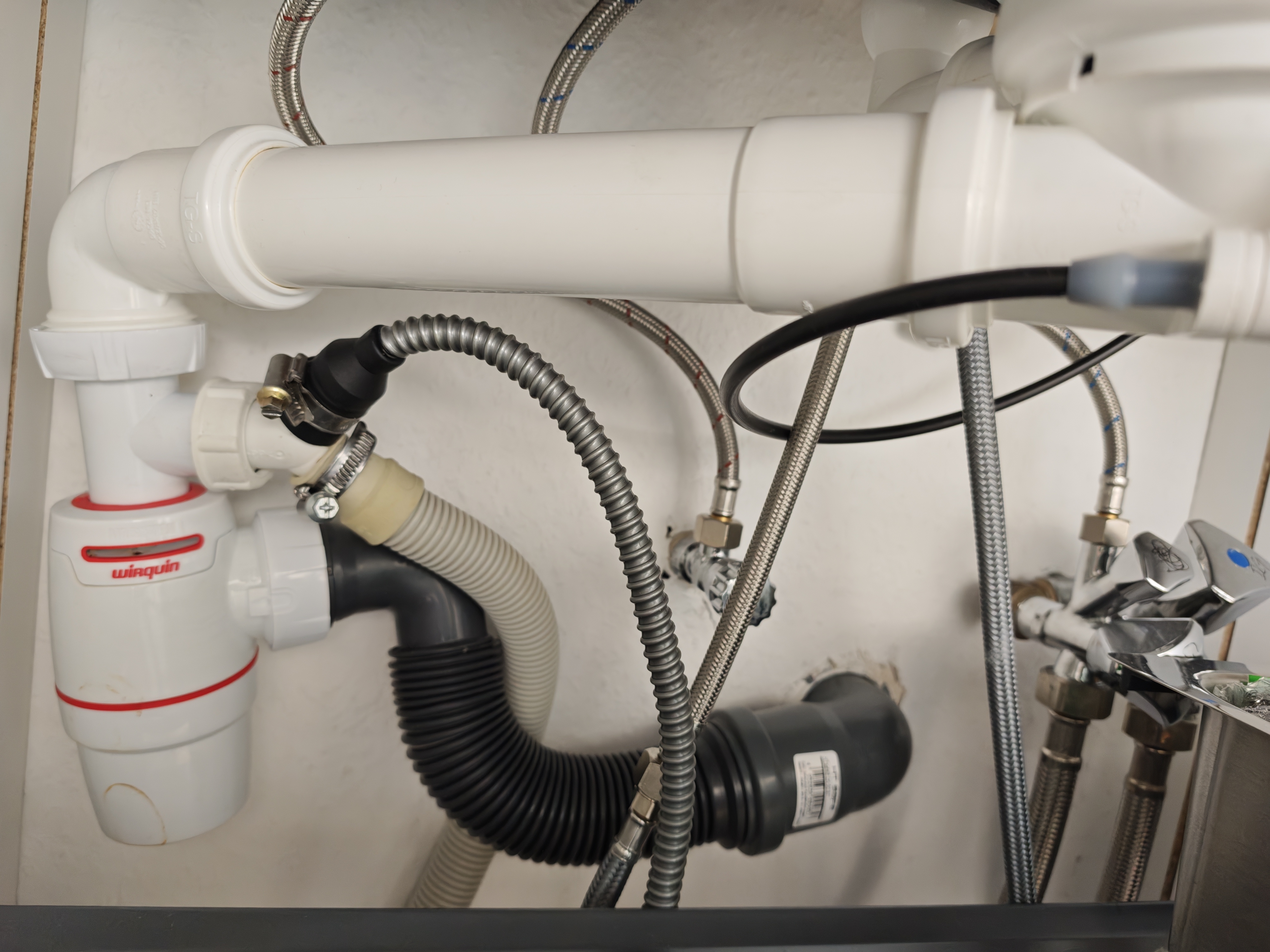

BratEnteHello everyone,
I have a strange issue with my Miele steam oven and hope for some ideas or shared experiences.
It is a Miele DGC 7645 with a drain pump. The drain hose is connected to the appliance connection on the trap under the sink.
As soon as the hose is connected to the trap, the steam oven often reports an error that it cannot pump out.
Sometimes the pumping works perfectly 1 to several times, then not at all again.
The strange thing:
- If I disconnect the hose from the trap and pump directly into a bucket, everything works perfectly.
- The pump runs strongly and without any issues.
- Even if I position the bucket higher than the trap connection, it still pumps out cleanly.
Already checked:
- Appliance connection on the trap is open
- No end cap present anymore
- Trap and regular drain are clear
- Sink and dishwasher work fine on the same trap without problems
- Hose is not kinked or pinched
- No hose extensions used
- Miele service technician has already been on site:
- Measured the pump
- Inspected the appliance
- According to Miele, everything is technically fine
Notable behavior:
When the water remains inside the appliance:
- Disconnect hose from trap, blow into the hose, water rises back inside the steam oven, then pump into a bucket
→ then pumping works immediately and without problems.
As soon as the hose is reconnected to the trap, the problem will occur sooner or later again.
My suspicion:
It almost seems as if the pump cannot handle the pressure/air conditions at the closed trap connection, even though the drain itself is free.
Therefore, I am considering running the drain “open,” for example:
- using a small funnel,
- an open intermediate container,
- or some kind of open outlet at the appliance connection,
to prevent any back pressure or vacuum from developing.

Jesse Custer4 May 2026 13:20I am not familiar with the device and its design, but we had the exact same problem with our washing machine, which ultimately led us to connect the drain directly to the sink.
The diameter of the appliance connection at the trap is too small – this creates back pressure in the system, causing the appliance to shut off.
I would check if larger fittings are available for the piping.
J
Jesse Custer4 May 2026 14:03Our washing machine had issues with the same connection—it seems to depend on the appliance...
In our case, it even caused the hose to come loose due to the pressure...
The drain hose from the steamer sags quite a bit before it reaches the trap, so try tying the loop higher.
Also, the whole setup is not ideal with the double connector placed directly above the trap.
There are also versions of the dip tube with two appliance connections, then set the trap itself a bit lower.
Give it a try and see what works. 🙄
