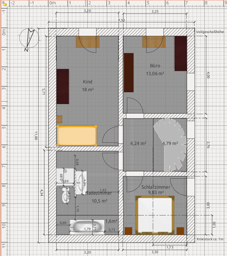

The upper floor will look roughly like this; I don’t think it will fit exactly to the centimeter. I also used a smaller staircase here. The architect will adjust it to fit properly. The house cannot be made any wider, only longer.
Draufsicht-Grundriss eines Hauses mit Kind-, Büro-, Schlafzimmer-, Badezimmern, Fluren.
Jochen10417 Jan 2015 14:11
Well, I find the dimensions quite narrow. But I don’t have to carry your furniture up there.
Your electrician will have trouble running the cables to the upper floor. According to your plan, they enter the bathroom.
Which type of roof are you getting? A 1m (3 ft) knee wall? What does the 1m (3 ft) line in the bedroom refer to then? Roof orientation and pitch?

I think the electrician will find a way to route the wiring upstairs. Possibly, the electrical panel will need to be moved closer to the hallway, so it can be accessed between the bedroom and bathroom upstairs.
The building has a gable roof with a 45° pitch. The knee wall is a challenge… The eave height on the north side is a maximum of 4 meters (13 feet) up to the top edge of the roof, so a 1-meter (3-foot) knee wall will be quite tight there. The line indicates where the room height reaches 2 meters (6.5 feet). On the south side, we have 6 meters (20 feet).
The ridge runs east-west. The bed and bathtub are located under the sloped ceiling. There is a roof window above the bathtub.
The dimensions in the design are not exactly 100% accurate. It’s more about the room layout and approximate space requirements. A 7.5-meter (25-foot) exterior dimension is a limitation if you don’t want to extend the length too much, which would raise the ridge height even further. The budget is also limited.
