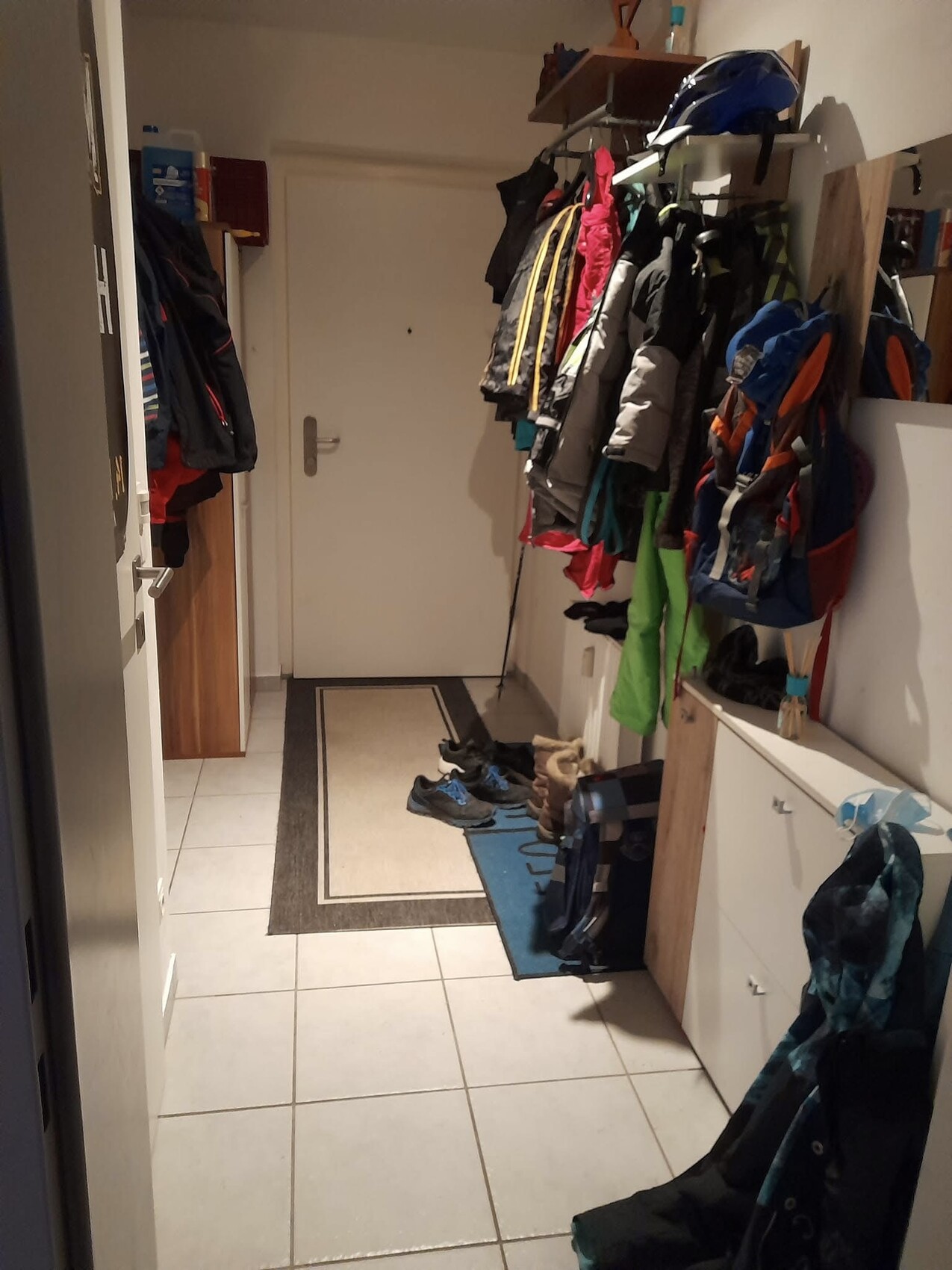

Wardrobe cabinet: actually we don’t want a closet but coat hooks.Haha, I know some for whom the top priority in the house is no visible jackets at all. I won’t say more about that, @haydee already explained it well.Marcus. schrieb:
May not look very tidy to some,Marcus. schrieb:
Grandparents (at least ours) are bothered by clutter otherwise (even if they accept it sometimes),That seems to be the key factor to a harmonious coexistence 😉Marcus. schrieb:

MachsSelbst6 Oct 2025 20:30ypg schrieb:
I forgot: a hallway with missing wardrobe planning (4 people)Thanks for the example of complete detachment. You have basically reached the Neptune of expectations.
What exactly is so terrible about this wardrobe?
hanghaus20237 Oct 2025 10:32MachsSelbst schrieb:
What is so terrible about this wardrobe?Everyone sees it from their own perspective. You seem to like it. ypg schrieb:
Here, unfortunately, the outdated exterior views must also be mentioned. Nice appearance doesn’t have to cost more.But "outdated" is still a very mild way to put it.Similar topics
