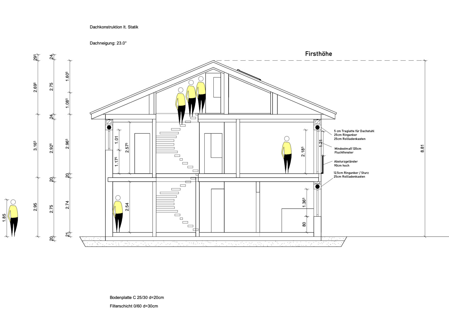

[ATTACH alt="Bildschirmfoto 2025-10-05 um 00.52.59.png"]93026[/ATTACH]

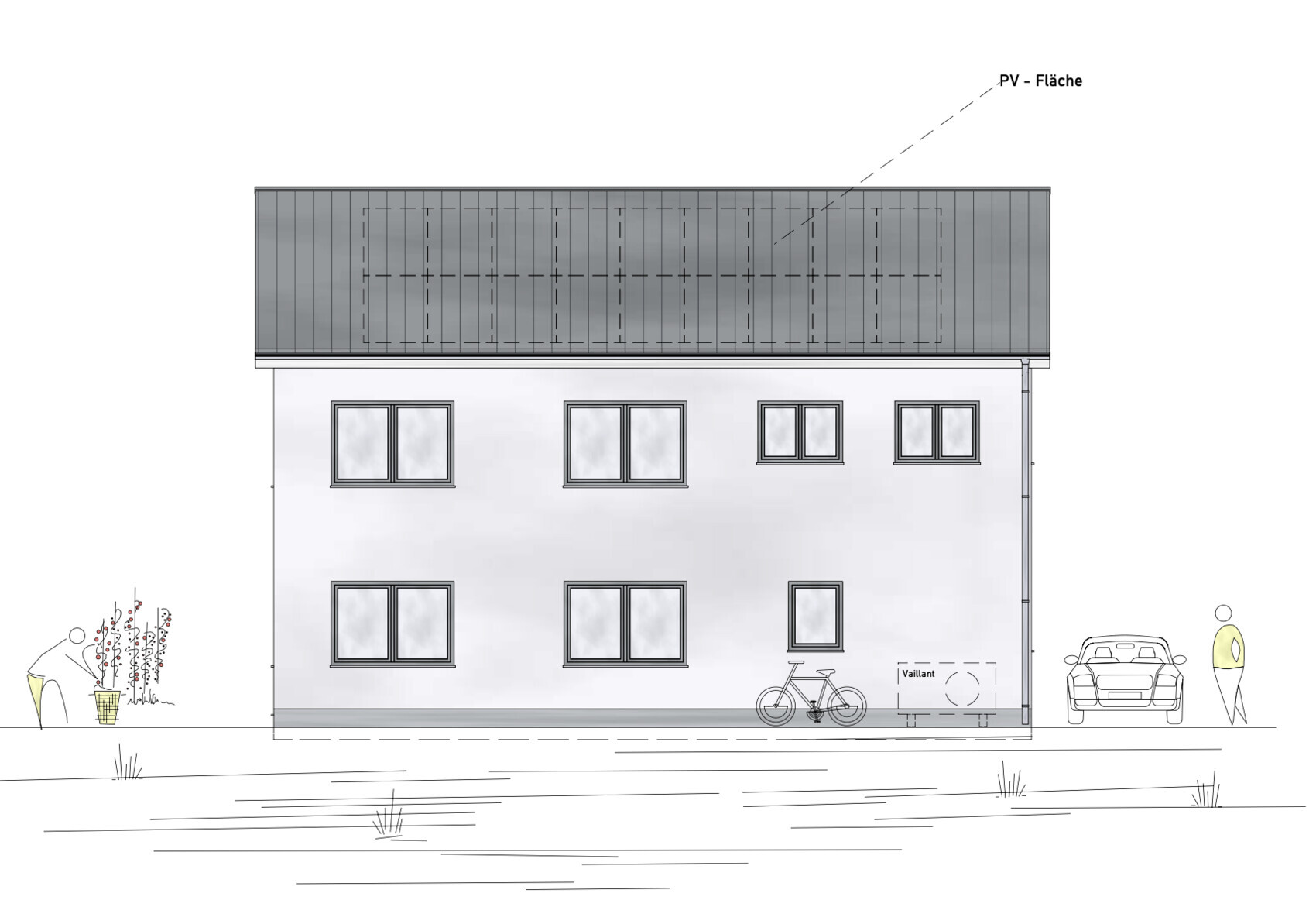

[ATTACH alt="hausansicht-einfamilienhaus-mit-pv-anlage-baum-bank-hund.jpg"]93029[/ATTACH]

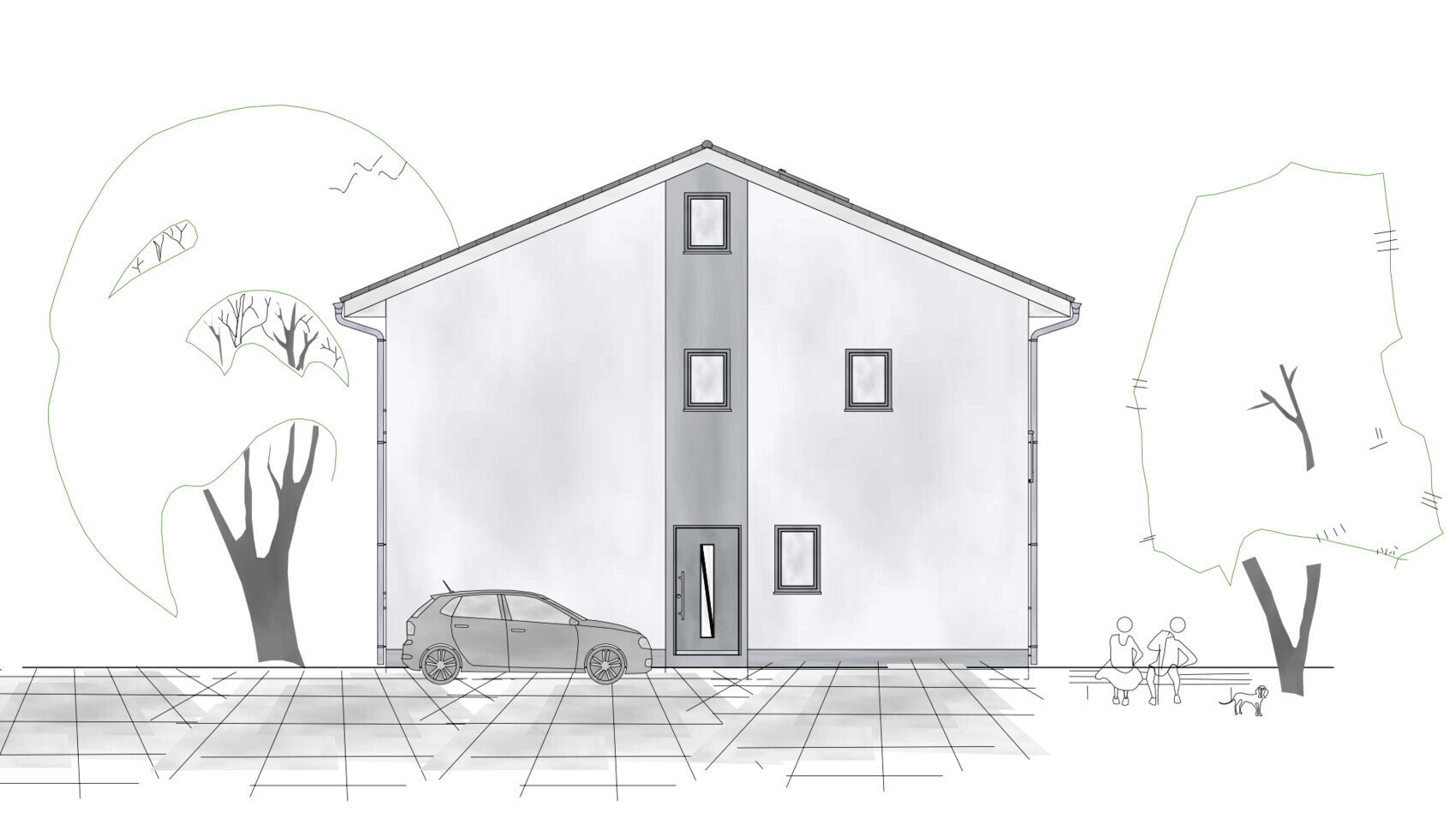

[ATTACH alt="Bildschirmfoto 2025-10-05 um 00.47.06.png"]93027[/ATTACH]

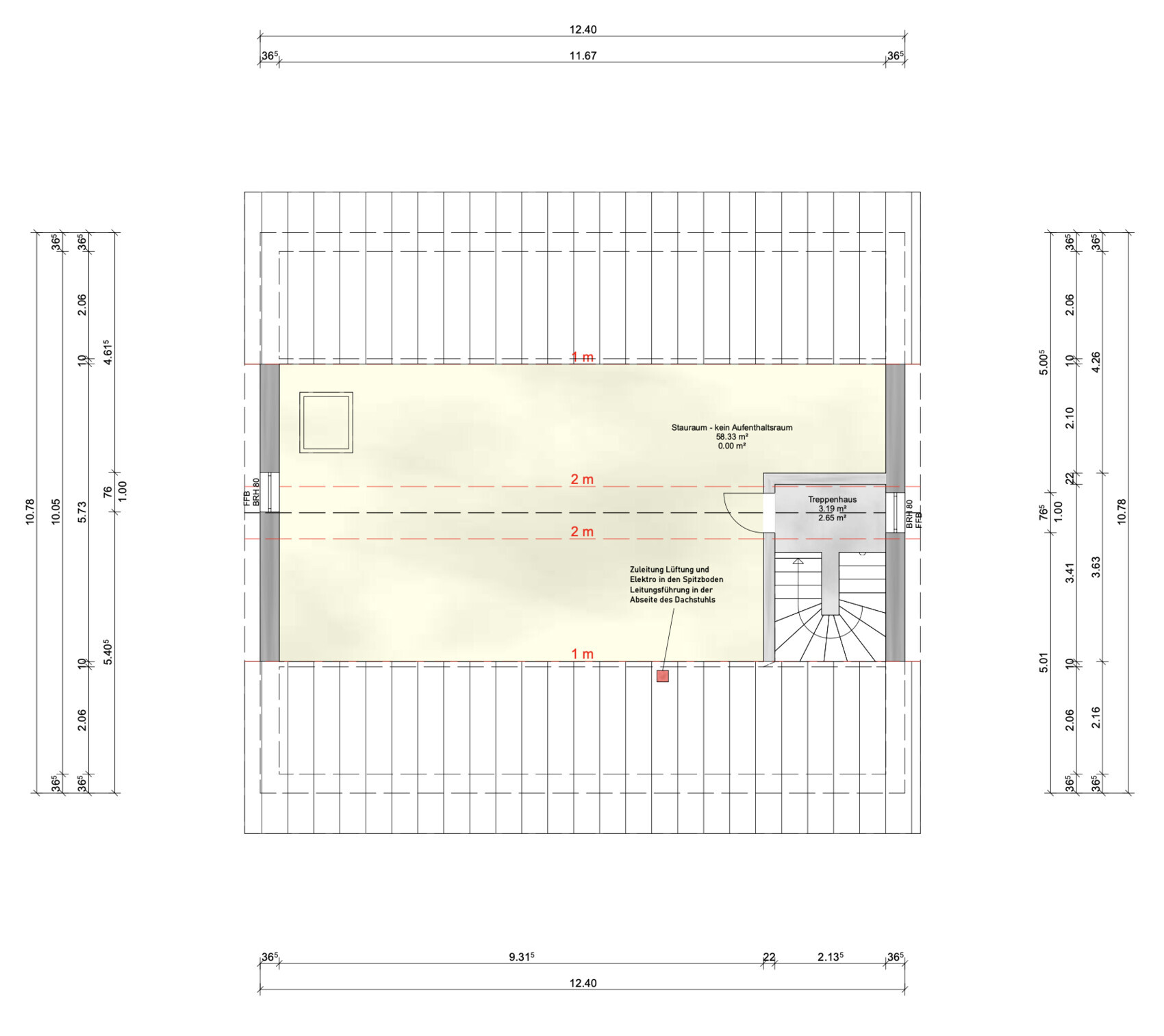

- Attic compensates for no basement

- Floor-to-ceiling window in the bedroom or not (possibly desk space)?
- Is the small window in the upper hallway sufficient?
- Would an additional south-facing window for the children’s bedrooms on the south side be useful?
- The house is positioned quite close to the southern boundary – is that reasonable from your perspective (considering parents’ house to the south)?

If you are already at the stage of planning a bathtub with a door, first mark the turning circles for a rollator and wheelchair. These spaces are already very tight, especially if someone needs to assist. Reinforce the wall construction behind the bathroom fixtures during building so that a grab bar can be installed.
Also, place two armchairs with reclining and lift-assist functions in your living room. Seniors do not want to spend all their time confined to a small room. Have you drawn your existing or desired furniture to scale in the floor plan, including clearances for movement? For example, the freezer in the utility room is usually deeper than the standard 60cm (24 inches), and you may need a large one for 4, 6, or even 8 people.
Do this and you will see more clearly where space is tight. This is especially important for personal items that set you apart, like your grandmother’s rustic cupboard, your shoe collection, or the library you furnish with your books. Your food storage will also expand, and pots and pans will be large. Don’t forget to consider all scenarios, including “what ifs” and possibilities.
I would also suggest planning larger windows in the dining and living areas. Our eyes don’t stop at the edge of the table when sitting. Large windows enhance the feeling of space.
Walk through your house. Children return from school (by the way, I know a family with six members who have a dedicated cloakroom), change shoes, hang up jackets, open wet umbrellas, put away scarves and hats, school bags, sports bags, and multiply that by 4 children plus 2 to 4 adults. Each person has more than one pair of shoes and a jacket. Add visiting children and possibly their parents if you are friends.
Where should all these items go? With limited mobility, shoes and other objects on the floor become tripping hazards. This is what I mean by family scenes. For example, just this morning—even though there were only two of us—our cloakroom contained a bag for ballet later that afternoon, a booster seat (for carpooling), a violin case and school bag for the morning, my work bag, and a basket with bread and eggs that I need to take to my parents. In the evening, the booster seat will be put away, the ballet bag stored in the cloakroom, the violin moved to the living room, and in its place by the school bag will be a bicycle helmet and a bag with change of clothes.
Or another scene: Grandma is sitting at the table knitting; child 1 is doing homework; child 2 just arrived from school and wants to eat; children 3 and 4 are playing in the living room; and medication for grandpa is being sorted into pill organizers on the dining table. Is the table large enough? Can 10 people fit comfortably around it for a meal, with one person in a wheelchair? For example, at our dining table, 10 people can fit with regular chairs, and during celebrations, we can squeeze 12. With two wheelchairs, it’s comfortable for 8, tightly packed for 10, but you really have to keep your elbows close to your body.
In your plan, the space between the chairs and the kitchen island is very tight. This might be too narrow for seniors—for example, a senior with a cane comes up to the table edge, and you try to slide the chair underneath from behind. The path to the terrace will likely go through the kitchen very often.
