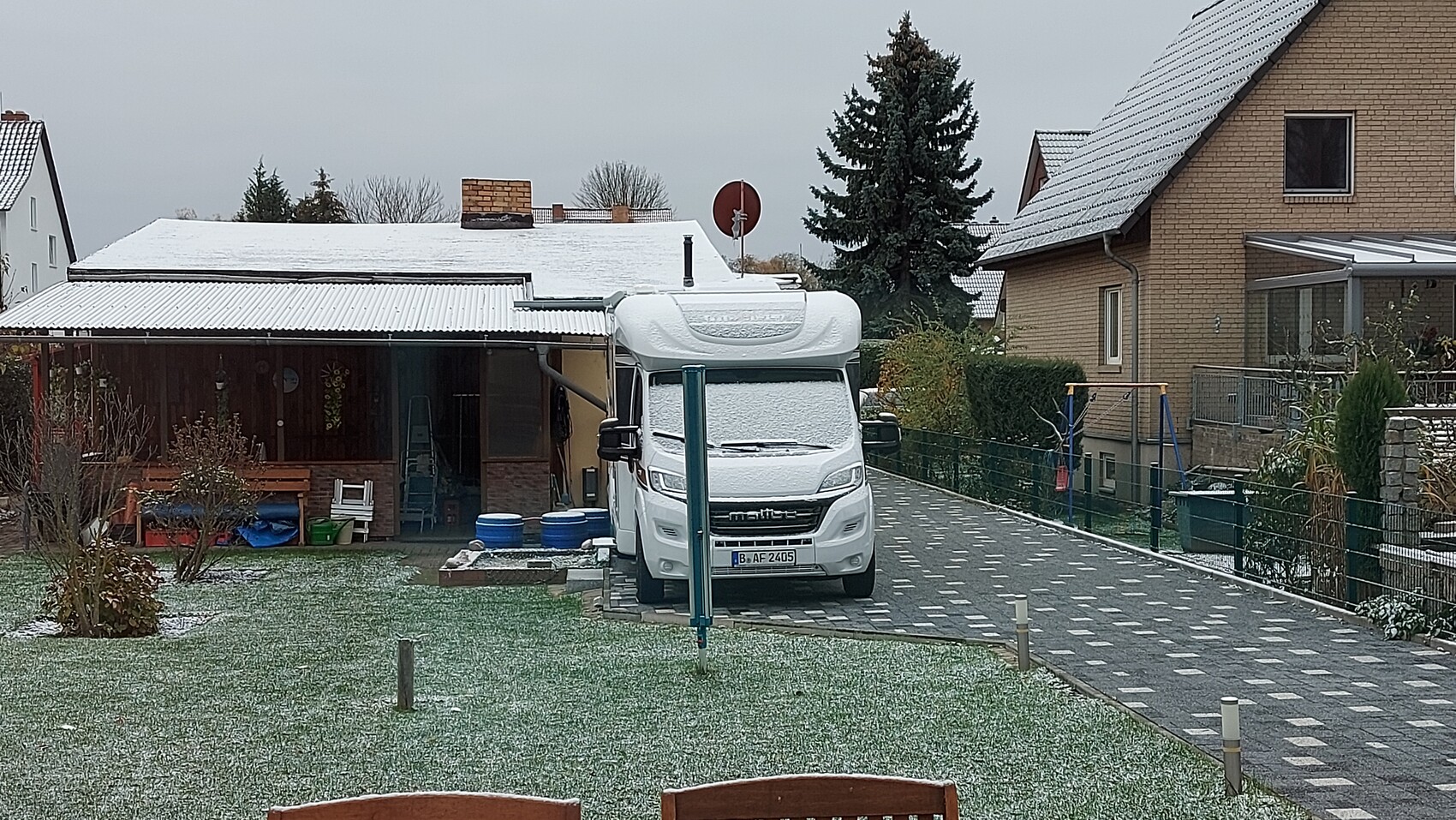

That means we either have to plan a turning area within the building zone or reverse out 20 meters (65.6 feet)We have been reversing in about 70 meters (230 feet) for years and driving out forwards, with a driveway 2.70 meters (8.9 feet) wide, no problem—it just takes practice. A turning area would be a luxury and is not necessary.
