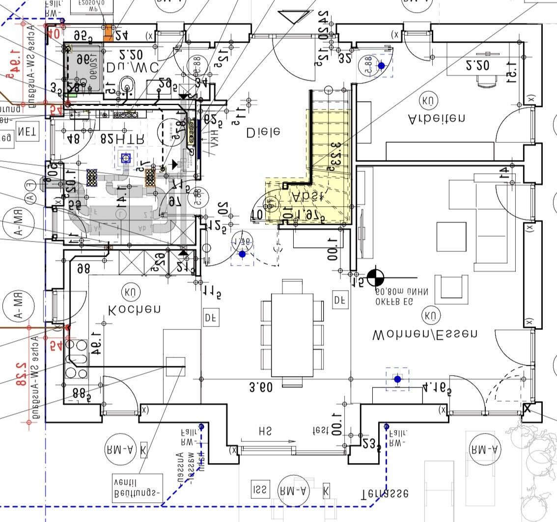

So, if the carport is on the west side, the living area is in the southeast, which is the right corner. The living room features a floor-to-ceiling corner window. The kitchen would then be next to the carport.
If the carport is in front of the house, the living room would face southwest (mirrored). This orientation is usually recommended for better natural light. Is there a specific reason why you would place the living room in the southeast? Unfortunately, then the kids’ rooms on the upper floor would also be on the east side.
Here is the floor plan for the "carport on the west side" variant: The text is oriented this way due to mirroring.
Detailed floor plan of a residential house: kitchen, dining area, living room, stairs, entrance area.

Oh, the maximum width of the carport on the house side would be 5.50 meters (18 feet) for two cars. There is no more space available within the building boundary.
