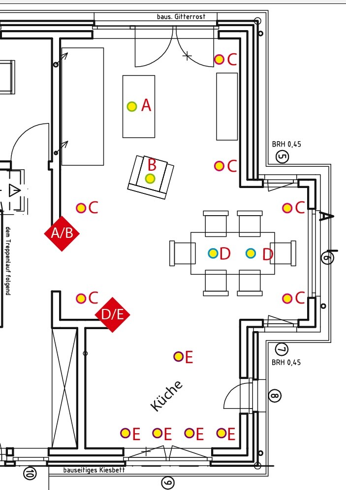

If the dining table is placed so you can still access the bay window, that will be roughly the center of the dining room. There, a dimmable fixture would provide bright light for the room. Or two outlets with about 50cm (20 inches) or 100cm (40 inches) spacing – but I would connect those.
In the middle of the living area, I would also place a separate main light – bright enough to illuminate these 16 square meters (about 170 square feet). For example, a movable fixture with four spotlights, or four individual spotlights aimed straight down toward the room corners but not too far into the corners. You need to sketch this with an approximate lighting radius to figure out the optimal placement.
However, I wouldn’t overestimate the general lighting: usually, the dining room lamp is sufficient for everything you do in that area. As for main lighting in the living room, I can count on one hand how often I actually turn it on during the year.
krachbumms16 Oct 2015 20:12First of all: the living room is 430cm (170 inches) wide. The bay window inside measures 130cm by 316cm (51 inches by 124 inches).
Attached is my current plan with positioned light sources, where pendant lamps are planned over the tables and otherwise surface-mounted spotlights.
Am I correct in understanding that this might be too dark?
Since the living room is quite small, the lamp above the table is almost centered already – would it look odd to place a second one just 1m (3 feet) away?
Regarding the distance of spotlights from the wall, I found (I don’t remember the source) that it should be one-third of the ceiling height (ours is 275cm), so about 90cm (35 inches) – is that correct?
krachbumms16 Oct 2015 20:29I need to correct myself: my note says 90cm (35 inches) between the spotlights if arranged in a row. However, the first spotlight near a wall should be about 50cm (20 inches) away from it.
What do you think of the attached layout? (Each letter can be switched individually, the red diamonds indicate the positions of the switches.)
Where would a dimmer be most practical—for the spotlights in the living/dining area?
Should the spotlights in the living and dining areas be controlled together or separately?
