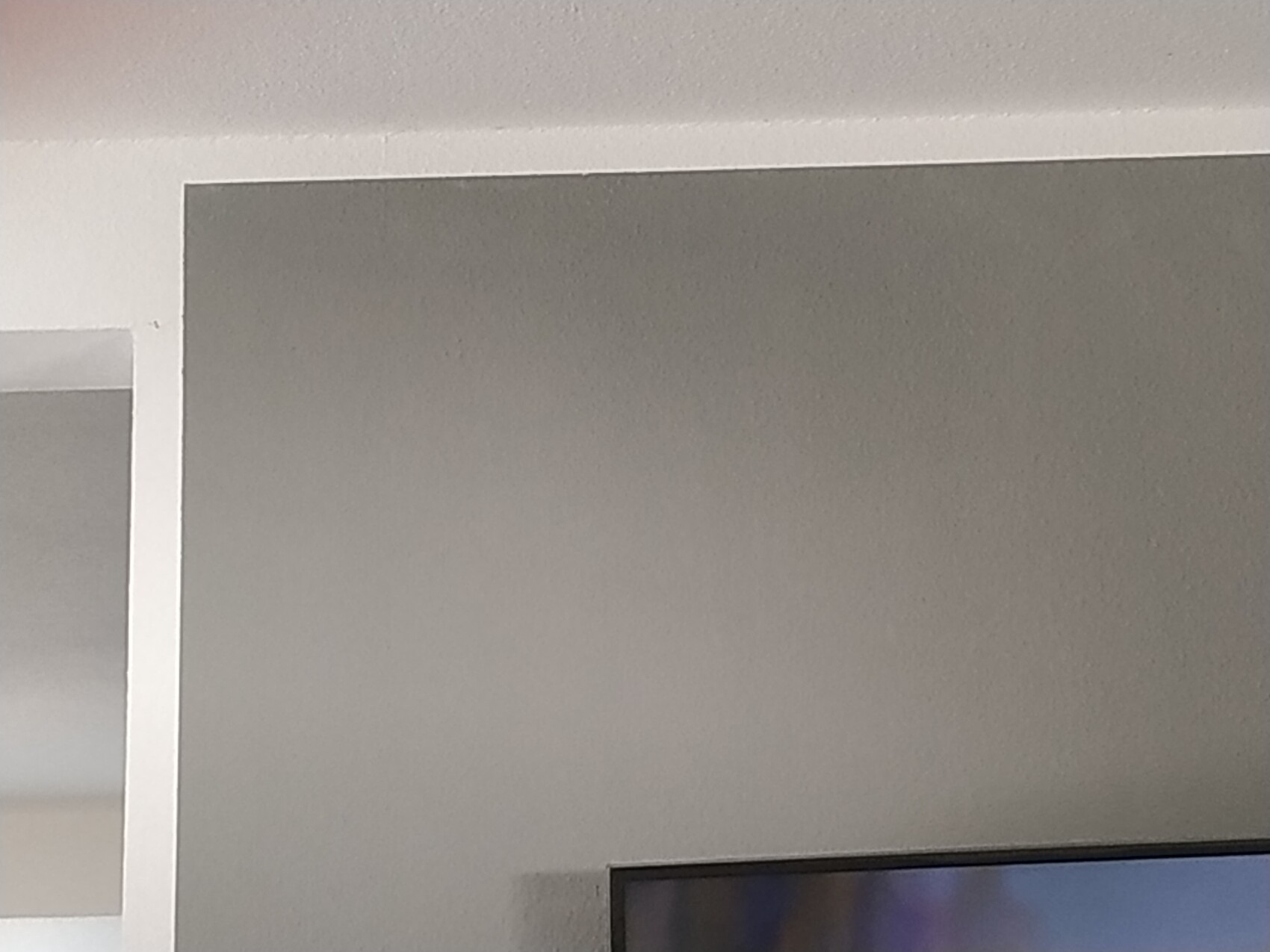

tomtom7929 Jun 2019 09:43
You made a big mistake here by painting colored walls all the way up to the ceiling.
The transitions between the wall and ceiling are never perfectly straight, so this creates an uneven and inconsistent look.
I would now tape off the wall and paint a white strip along the top.

Room interior: large gray wall, white door frame on the left, and TV screen at the bottom of the picture.
