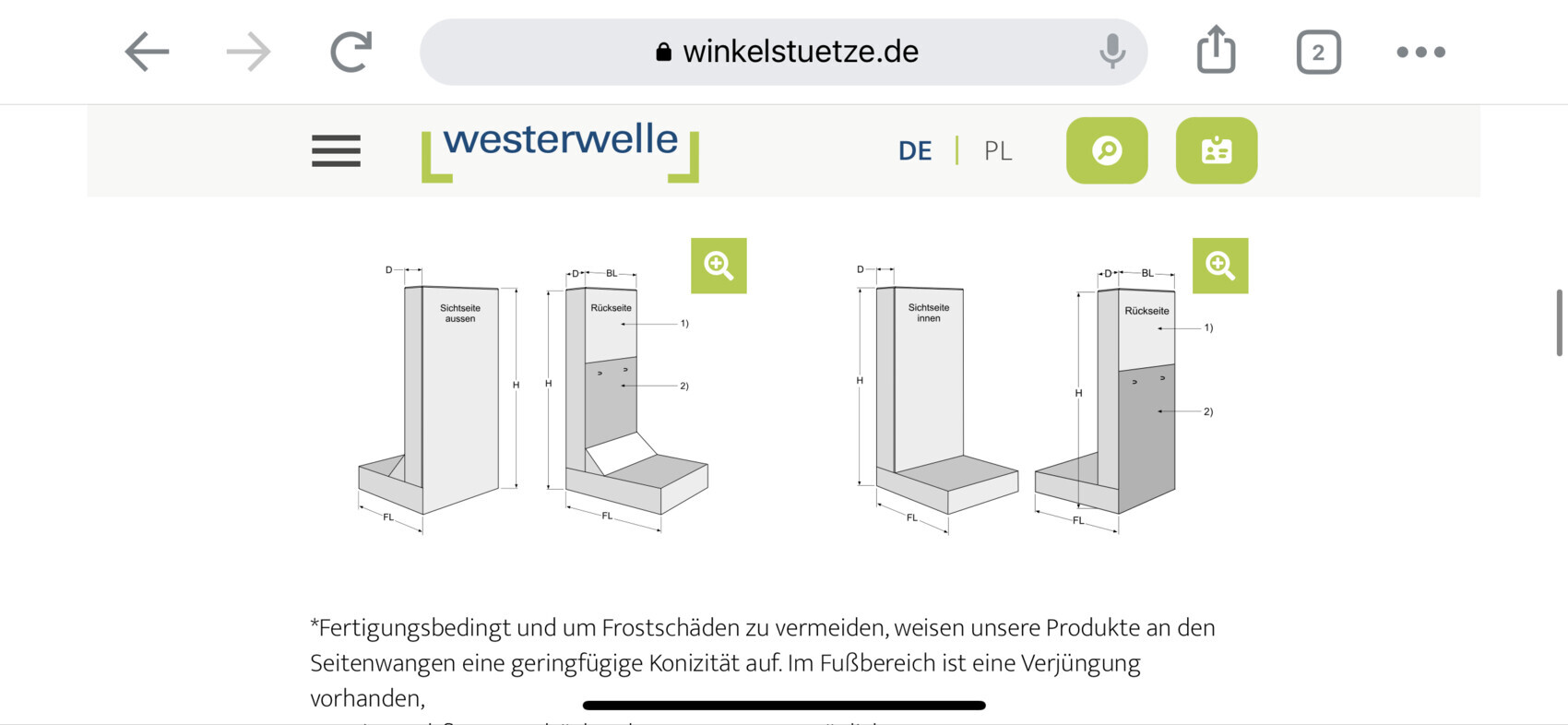

@Yaso2.0 Retaining wall blocks. I took all the existing heights and created almost to-scale terrain sections in AutoCAD. Then I considered how to model/shape the terrain in the respective areas and determined the height of my L-shaped blocks accordingly. The request is currently with the supplier..., but it won’t be exactly cheap.
I also need L-shaped blocks designed for a reversed load situation because the neighboring plots are at a higher elevation, and I cannot orient the footing towards the neighbors. Otherwise, if I want to place it directly on the boundary, I would have to excavate up to 1.0 m (3.3 ft).

Stefan00119 Jan 2022 07:46jaenno1 schrieb:
I also need L-shaped concrete blocks with a reversed load scenario because the neighboring plots are at a higher elevation, and I cannot turn the base toward the neighbors. Otherwise, if I wanted to place it directly on the boundary, I would have to excavate up to 1.0 m (3.3 ft).
I have also requested them in anthracite color.
I hope this helps for now 😉 🙂. I have never heard of L-shaped blocks with a "reversed load scenario." Is that something special?
If you just want to install the L-blocks the other way around: that probably won’t work well. The blocks gain their stability mainly from the weight of the soil resting on their base. Without that, they are very easily pushed out or tipped over.
