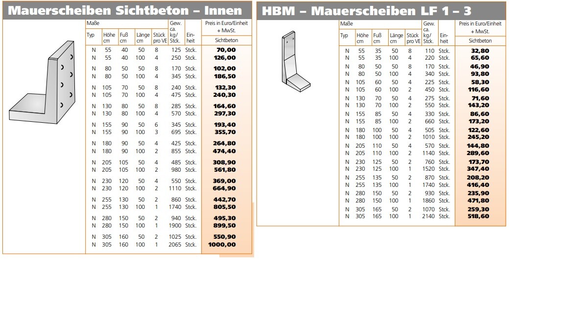

Well, for anyone puzzled and thinking about left-handed mugs 😉 , here is the explanation: The exposed concrete surface on these models is simply on the opposite side. This means the “nice side” faces my property without having to encroach on the neighbor’s land. Unfortunately, not all suppliers offer these models. I’m attaching the model and price overview from my supplier. This clearly shows the difference (including the price).
Concrete wall panels – interior and L-blocks 1–3: diagram and price lists.
