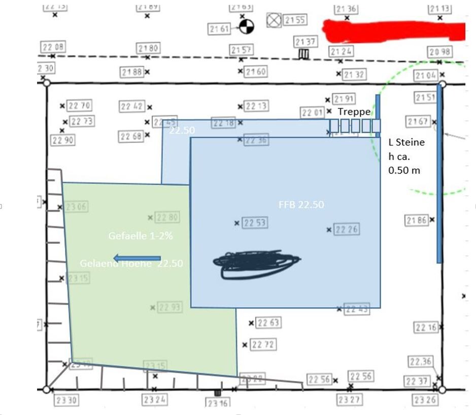

gutentag30 Mar 2022 20:13
@Yaso2.0 Have the heights changed?
For me, the height difference is only 80 cm (31.5 inches).
Height of finished floor level and terrace?
Floor plan: Blue building area FFL 22.50, green area slope 1-2%, stairs on the right, L-blocks 0.50 m (1.6 ft).
Yaso2.030 Mar 2022 20:40
For me, the height difference is only 80cm (31.5 inches).
Height of finished floor and terrace?
Yes, they have changed, among other things because my husband didn’t want a steep driveway.
The problem isn’t really the heights themselves, but the fact that I have to or want to manage the level difference without interfering with the neighboring areas.
