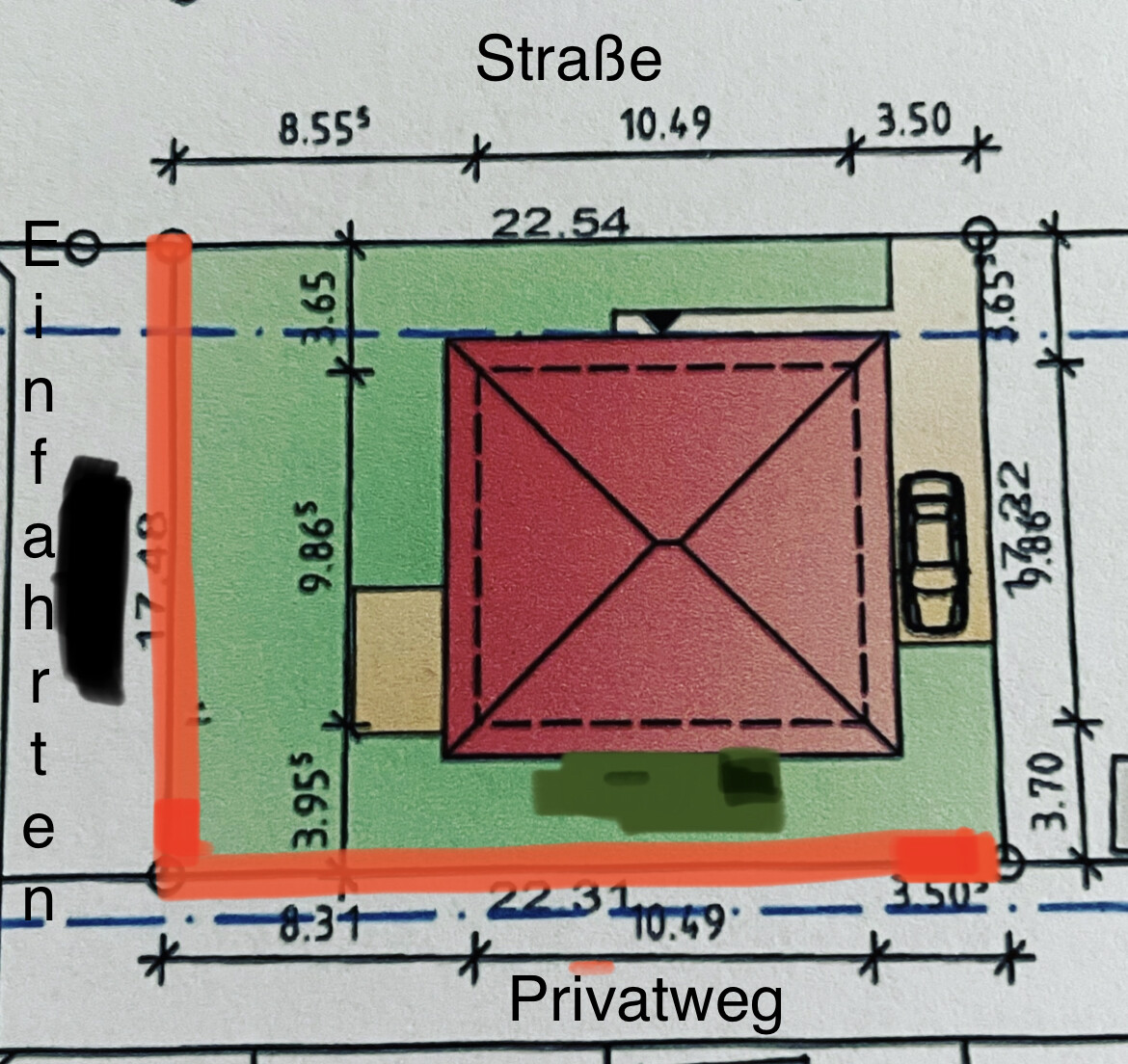

Hello @Yaso2.0, do you possibly have plans of the situation? Or have you already raised this issue here before?In my thread https://www.hausbau-forum.de/threads/Grundstück-aufschuetten-oder-nicht.35570/ the situation is described right in the first post.
If we wanted to place the L-shaped retaining walls directly on the property line, we would have to carry out the work over a private access road, which I definitely want to avoid.
None of the four road construction contractors could offer me the stones with the "reverse" angle, as reported by @jaenno1, and one even said, "that’s going to be really expensive."
Therefore, I have to look for an alternative that can be built from within my property and takes up the least amount of land, since on one side I only have a 3.50m (11.5 ft) clearance.

@Yaso2.0 Where is the stormwater outlet going?
Is there a plan? Is this the stormwater system to the east from #19 in the link?The areas marked in red will be retained with a wall.
The private driveway runs to the south, and the neighbors’ driveway is to the west.
Since the setback from the private driveway is only 3.70 - 3.95 m (12.1 - 13 feet), I want to minimize excavation there.
Terracing, sloping, or similar grading solutions are therefore ruled out.
