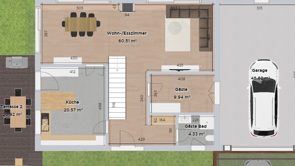

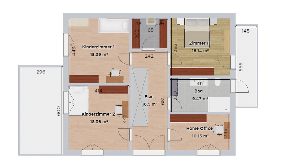

We are planning to include a second bathroom on the upper floor, but underneath on the ground floor there is actually no bathroom or kitchen, meaning the plumbing shaft is essentially located in the middle of the living/dining area. However, we are planning to install a fireplace exactly there. Now the question is: Could we place the plumbing shaft directly next to the chimney flue? If this projection is somewhat wider, it shouldn’t affect the appearance much, since a kind of panoramic fireplace is planned in front of it anyway. I hope I have made my idea clear.
If that’s not possible, could the plumbing shaft perhaps be moved so that it doesn’t run through the living room but instead through the guest room? What is the maximum flexibility here, or does the shaft have to run directly down from the bathroom?

Myrna_Loy15 Apr 2021 10:48Maybe a silly question, but why don’t you enlarge the guest toilet on the ground floor to include a shower instead of squeezing another bathroom upstairs? That way, the guest room also benefits. Currently, 2.24 m (7 ft 4 in) is planned for the wardrobe in front—wouldn’t 1.40 m (4 ft 7 in) or 1.20 m (3 ft 11 in) be enough?
BauFamily15 Apr 2021 11:08Myrna_Loy schrieb:
Silly question, but why don’t you enlarge the guest bathroom on the ground floor to include a shower instead of squeezing in another bathroom upstairs? That way, the guest room benefits too. Right now, 2.24 meters (7 ft 4 in) are planned for the wardrobe in front – wouldn’t 1.40 or 1.20 meters (4 ft 7 in or 3 ft 11 in) be enough? That’s not a silly question at all; I actually modified it here based on the feedback so that the wardrobe ends up being 1.60 meters (5 ft 3 in):

Our ideas are: large, closed kitchen in the southwest, living room in the northeast with a minimum distance of 4.30 meters (14 feet) to the TV, guest room on the ground floor, a shower bathroom on the ground floor and a bathroom upstairs (two bathrooms upstairs not a must), bathroom upstairs facing east so that laundry can be hung above the garage (washing machine won’t be in the basement – wherever laundry is generated, it should be possible to wash and dry it there), BauFamily schrieb:
By the way, I wonder if we are asking for too much or have too high expectations. You will be able to fit all the requirements you listed into your house. However, if every little detail is complicated to install or execute, your budget simply won’t be enough. Your garage plus basement already cost around 150,000€ (about 160,000 USD). A fireplace is roughly 10,000–15,000€ (about 11,000–16,000 USD)… and if it’s done in a complex way, then 15,000–20,000€ (about 16,000–22,000 USD), if that’s what you mean by “high expectations.”
