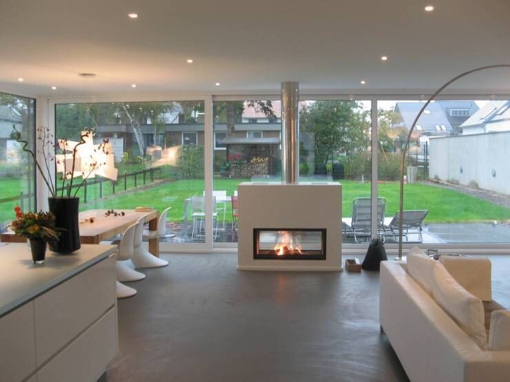

We are planning to include a second bathroom on the upper floor, but underneath on the ground floor there is actually no bathroom or kitchen, meaning the plumbing shaft is essentially located in the middle of the living/dining area. However, we are planning to install a fireplace exactly there. Now the question is: Could we place the plumbing shaft directly next to the chimney flue? If this projection is somewhat wider, it shouldn’t affect the appearance much, since a kind of panoramic fireplace is planned in front of it anyway. I hope I have made my idea clear.
If that’s not possible, could the plumbing shaft perhaps be moved so that it doesn’t run through the living room but instead through the guest room? What is the maximum flexibility here, or does the shaft have to run directly down from the bathroom?

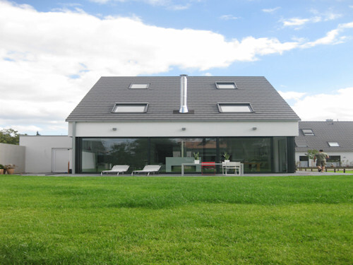

By the way, regarding the chimney at the eaves:
- For a roof pitch over 20%: the chimney outlet must be at least 40 cm (16 inches) above the ridge or at least 230 cm (7.5 feet) away from the roof surface in horizontal distance. The same distance applies to external chimneys on the building’s exterior wall.
