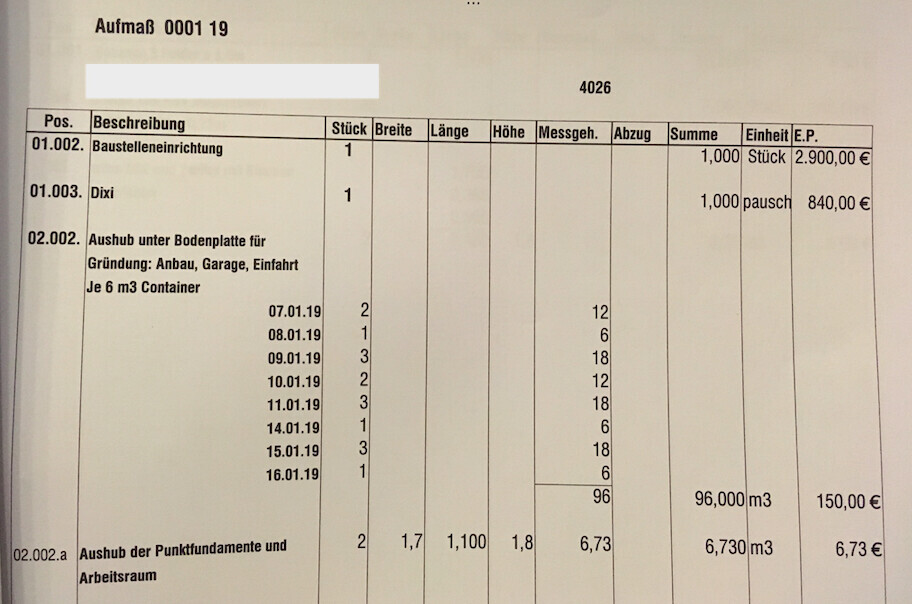

On Friday, we received the certificates, the invoice from the structural contractor, and the revised invoice from the architect. Included were two pages, but we are not sure whether they come from the architect or the structural contractor. These pages also list other items, including excavation work (see picture). However, the garage area has NOT been excavated yet.
Measurement document with items: site setup, portable toilet, and excavation under the foundation slab for footing.

Unfortunately, this doesn’t help if the scope of work / bill of quantities is poorly prepared and the listed quantities are incorrect or just rough estimates.
For example, in excavation and disposal, I’m missing details about the installation class / classification value (Z0-Z2). Just disposing of Z2 material alone costs over 50€/t (tons). Added to that are landfill acceptance fees, handling, and sampling, which quickly add a significant amount per ton. The risk of having to dispose of Z2 material at your own expense due to unclear specifications is borne by very few or no one.
In short: construction costs in individual contracts heavily depend on the quality of the tender documents. If the bill of quantities is poor or vague, high costs arise in individual items, additional costs due to increased quantities, and additional claims that are often already drafted and waiting even before the contract is confirmed.
Do you have any tips on how we can avoid getting burned again? :-(

I have one more idea, maybe someone can correct me: Was the shell construction contractor hired under the VOB (German Construction Contract Procedures)? Was their offer based on the quantities specified in the tender? Is the invoicing done according to the actual quantities at the agreed unit prices?
If so, a) their performed work must also be paid for (which could be expensive for the original poster).
However, the shell contractor was obligated to immediately report any increases in quantities as soon as they became apparent. The originally offered quantities can then be billed at the agreed unit prices. Any excess quantities must be recalculated upon your request, and this recalculation must be documented and proven. Perhaps this could help recover some costs.
