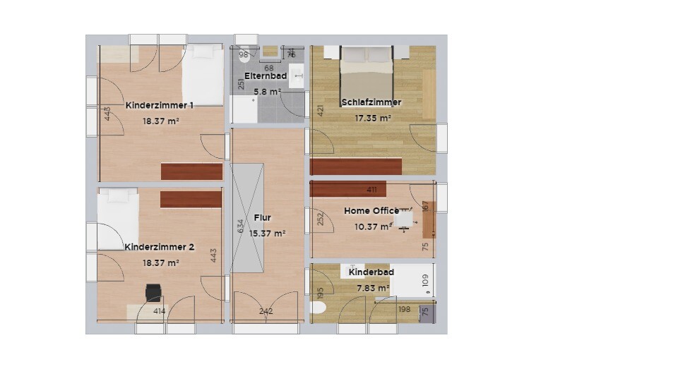

Floor plan of an apartment: hallway, master bathroom, bedroom, home office, kids’ room 1/2, kids’ bathroom.
Where the master bathroom is, you can see the chimney shaft...
Possible solution: The idea is to convert the master bathroom into a storage room. But then where would the master bathroom go? It probably comes down to giving up the home office room. Below the current kids’ bathroom and home office, there is a guest toilet or guest room. Kids’ rooms 1 and 2 are meant to stay on the west side. Or does anyone have another idea? It just feels painful to give up almost 18 m² (194 ft²) for both bathrooms at the expense of the home office, just because I can’t find an efficient solution.
11ant12 Apr 2021 23:52
Not sure what it’s doing at the eaves.
BauFamily schrieb:
Under the current kids’ bathroom and home office, there is the guest toilet or a guest room.
Anyone can claim that.
BauFamily schrieb:
Or another idea?
The solution is “trash bin” and roll the dice again.
BauFamily
12 Apr 2021 23:56
Whatever he might be looking for at the eaves.
Anyone could claim that.
A chimney at the eaves isn't possible? Technically it definitely is, it just looks odd… I just realized that myself.
11ant13 Apr 2021 00:04
BauFamily schrieb:
A chimney at the eaves is not possible?
A new event card will be created especially for you: "Ask the Schlossallee questions only after you have read a bit; start the game at 'Go'."
