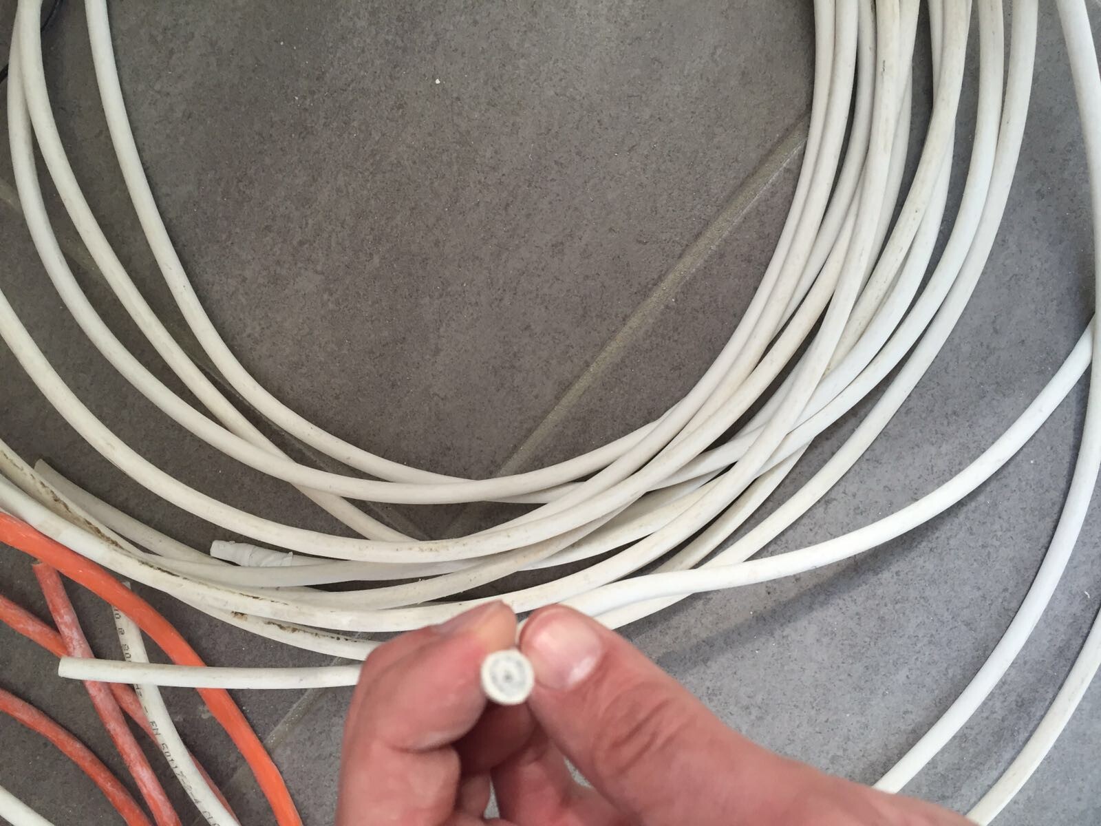

I think I will have a professional install the dish. Today, I checked again in the utility room. At the "cable drum" that is connected there, I found 5 network cables as well as 9 "white" cables. They look like satellite cables to me. (See photo)
Now I’m completely confused. Am I understanding this correctly: the cables are somewhere up in the attic. The satellite dish is then installed there. All 5 wall outlets are already installed. I thought these would be supplied from above, from the dish?! Or does a multiswitch first need to be installed in the utility room?
Or are these cables for cable TV?! I just don’t get it.
Well, the professional should know what to do, I just want to understand!
