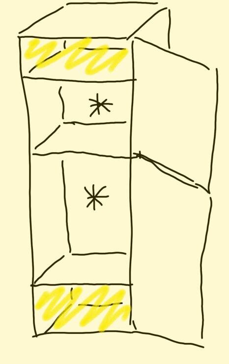

I don’t remember which fronts are available, but a 120cm (47 inches) or 140cm (55 inches) door should be fine for the refrigerator section. As mentioned, with a dead space—semi-dead space—you can store items there that are rarely needed. I’ve attached a quick sketch.
Skizze eines hohen Schranks mit offenen Fächern und gelber Markierung
