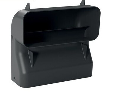

However, if this was a DIY job, you probably did not connect the unit correctly, and the warm air is blowing into your drawers. There should be an opening in the cabinet back panel like this
into which a part is inserted
that came with the cooktop. With this part, the air is directed down into the plinth.
